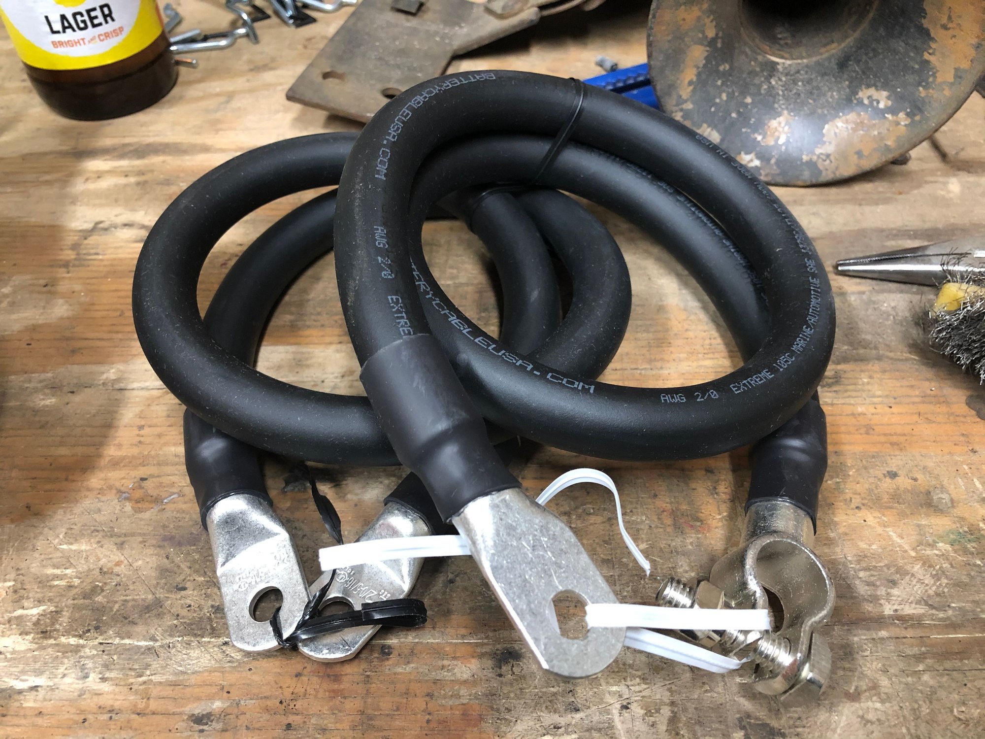

I ordered 2/0 gauge battery cables in custom lengths and connectors for my truck from https://www.batterycablesusa.com/
Great prices, quick shipping, made in 'MURICA!!

This is the route I went. 2/0 AWG stranded solid copper wire from BatteryCablesUSA.
Recall my truck is still positive ground, 6 volt. These cables run from battery to solenoid, then from solenoid to starter.

They look like they'll do the job! It didn't take long to get them to you.
And I see you had a frosty beverage to assist you!
