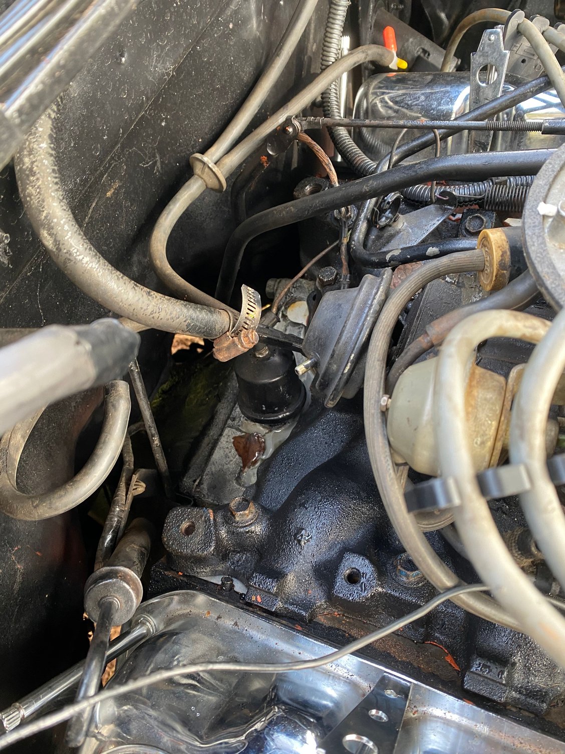

Another quick update, took the valve cover back off, along with the distributor cap to quadrupole check that I was at TDC. I noticed this behind the intake. There’s no smell to it. Not very viscous either. Not sure what it is, only guess is oil and coolant. So I guess the back seal is bad again on this valley pan? Not really sure.
Old Nov 15, 2020 | 12:53 PM
DB429SCJ's Avatar
DB429SCJ
Joined: Apr 2016
Posts: 858
Likes: 118
From: Buffalo NY
You changed the valley pan/intake gasket because it was leaking coolant? Is it still leaking ? The intake manifold on a 351C/M 400 has no coolant passages. Possible bad head gasket?

You might check the voltage to your coil . wear spark might be the problem . an ECM can fail at any time for no reason. I'd swap the old one back just to eliminate that possibility.
Figure out for sure what the liquid is that will make it a lot easier to diagnose.

no it’s not the head gasket. From what I read it was the Windsor that didn’t have coolant passages and the modified did. I could be wrong on that but the head gaskets are in prime condition. I thought the valley pan and the intake gaskets are too but I assume it’s still leaking, I have more fluid buildup there. Again, no clue what it is. No smell to it, but I’m assuming it’s oil and coolant again by the look and viscosity.

If you decked the block and shaved the heads you may have to get your intake machined to match the new angle. normally it's not enough to prevent a seal up but since you seem to be having unusual problems maybe looking at extreme answers is in line.
