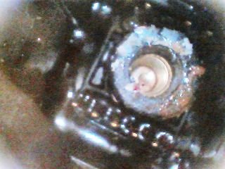

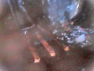

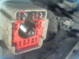

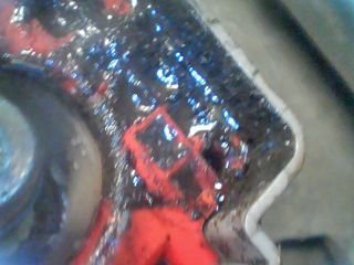

So I wanted to do a last minute post for now. After struggling with the 10mm nut on that plug I was able to get it off. Plug might be savable but will have to do some cleaning. The solenoid pack will need replacing as I noticed pins were missing from the pack. I will be dropping the pan and replacing the solenoid pack when it comes in. I was able to get my Autotel camera to work and although the pictures are absolutely terrible I will post them so you can see how bad the plug was and you can make out some of the missing pins. I think I will go ahead and replace the transmission filter as long as that pan is off as well.

Wow, do you know yet if the oil is coming through the connector on the solenoid pack or if it's the environmental seal that is compromised? That's a lot of what appears to be oil and dirt coating that plug! It is tough to tell from the images which pins are missing and if they are broken/damaged or were maybe never there. I will caution that it's not uncommon for vehicle connectors to have unused terminals. Sometimes one end of the connector will have more contacts than the made due to using a universal connector/harness to cover any combination of options, but the other end will only contain contacts for the options that the particular vehicle has.

Oil compromised the plug and I ordered the new selonoid pack and all pins are supposed to be there. I believe it was 6 on each side. The tranny fluid has never been changed for what I can see. The bolt was super tight. I am cleaning the plug right now but I honestly think I may have to replace it. That alone will not be fun. A lot of soldering and heat shrink tubing ahead of me. So if the plug is that bad I can only imagine what I will find underneath. I have a selonoid pack I bought online coming along with fill adapter for the transmission pan.
