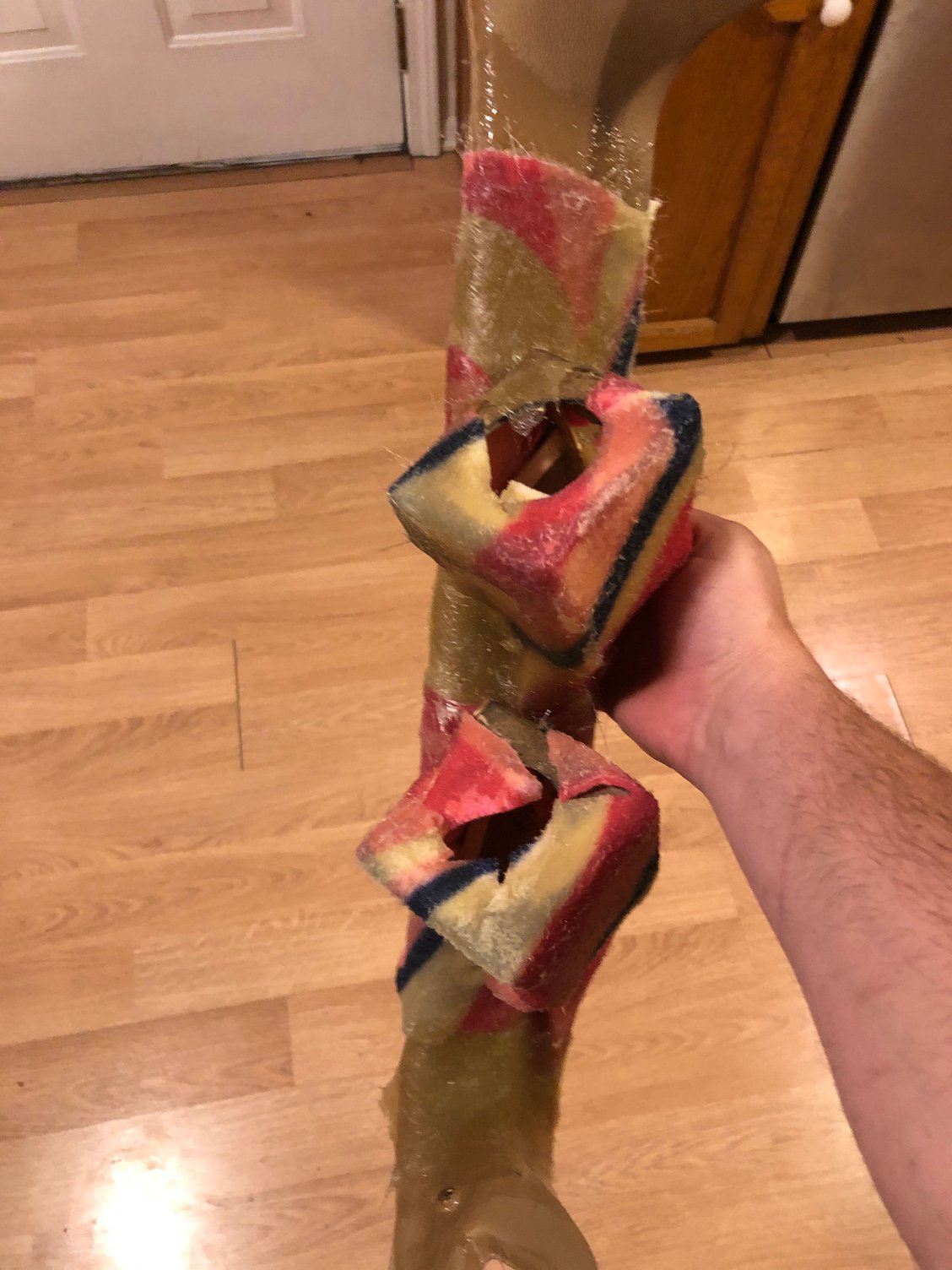

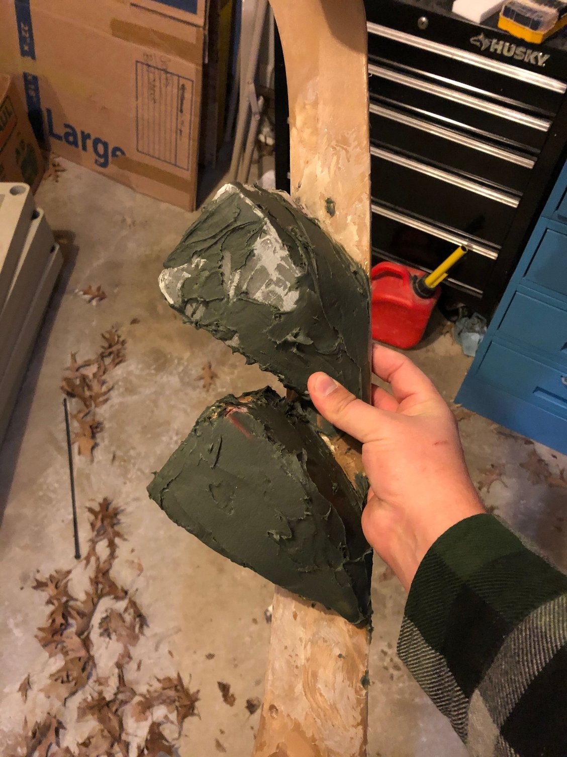

Also I have been working on making the pillar mount for the EGT and Boost gauges so I havent been completely slacking. Just dont judge my craftmanship too hard when you see the pictures. lol its a working progress and my first time.
A little fleece, Fiber glass, Sanding, Bondo, Sanding, Sanding, crying, and then sanding.

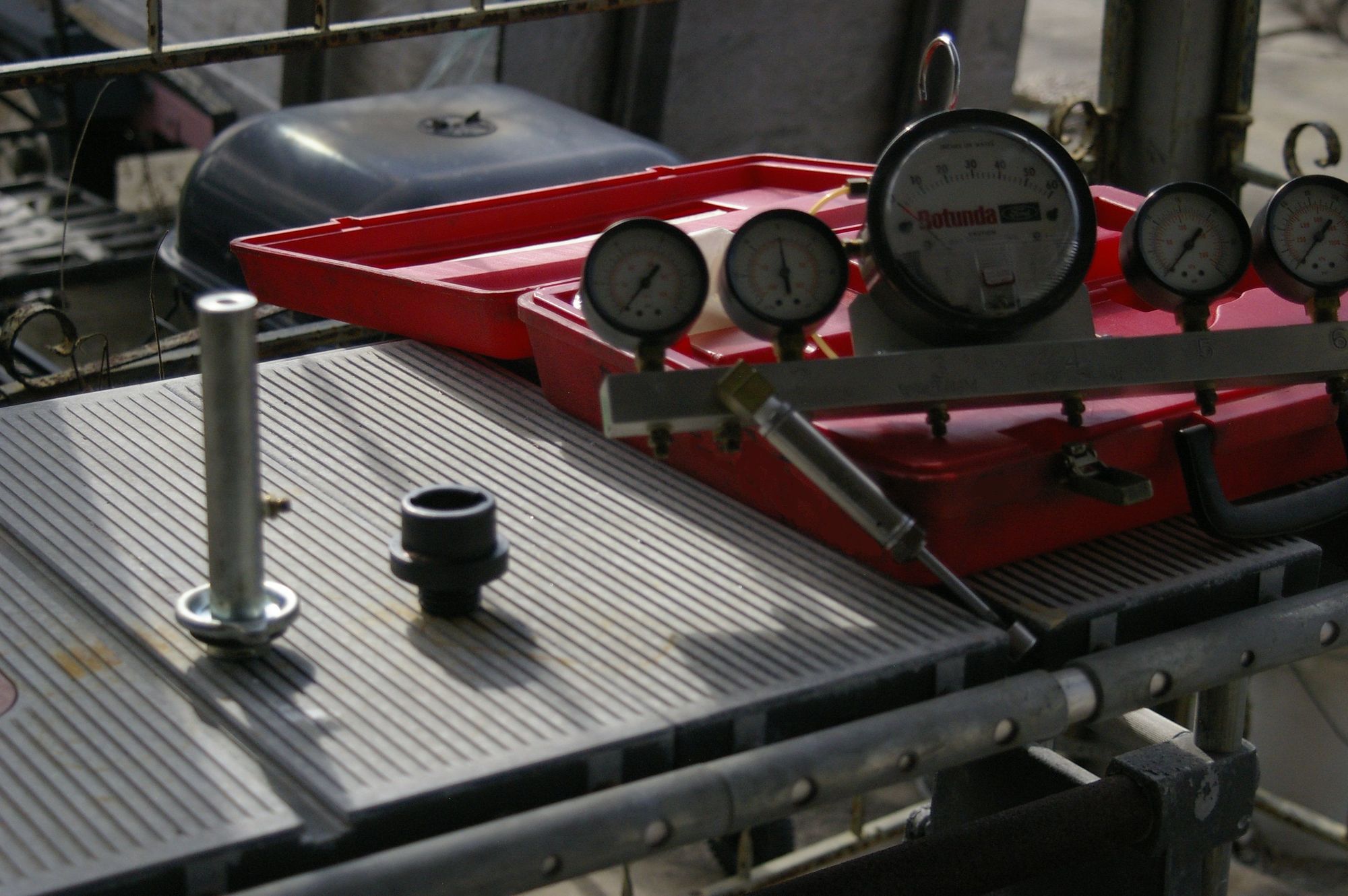

to measure Blow by you need to remove the CDR and plug the valley pan then you place a Calibrated Orifice on the oil filler neck and read that pressure with either a Mamometer or a Magnehelic differential pressure gauge... if it reads 6" or less then you do not have excessive blow by.
flipping the oil cap is just a good way to get a lump on yer head when it jumps into the fan.
Nice job on making the PODs probably faster than 3D printing them too

I take it I'll have to make this calibrated orifice? No chance in Autozone or Napa?
Old Nov 25, 2020 | 09:06 AM
lonewolf_'s Avatar
lonewolf_
Scope Wizard
Joined: May 2019
Posts: 6,530
Likes: 25
yeah probably.... this is what I use...
there are some DIY adapters on the internet ... I've posted links to them before

You can also DIY a manometer with cardboard and clear tubing

for my a-pillar pod, I just bought a universal 3-gauge pod, and used a heat gun to make the plastic a little softer. Then I pressed it up against my existing pillar plastic and screwed it down. Looks decent.

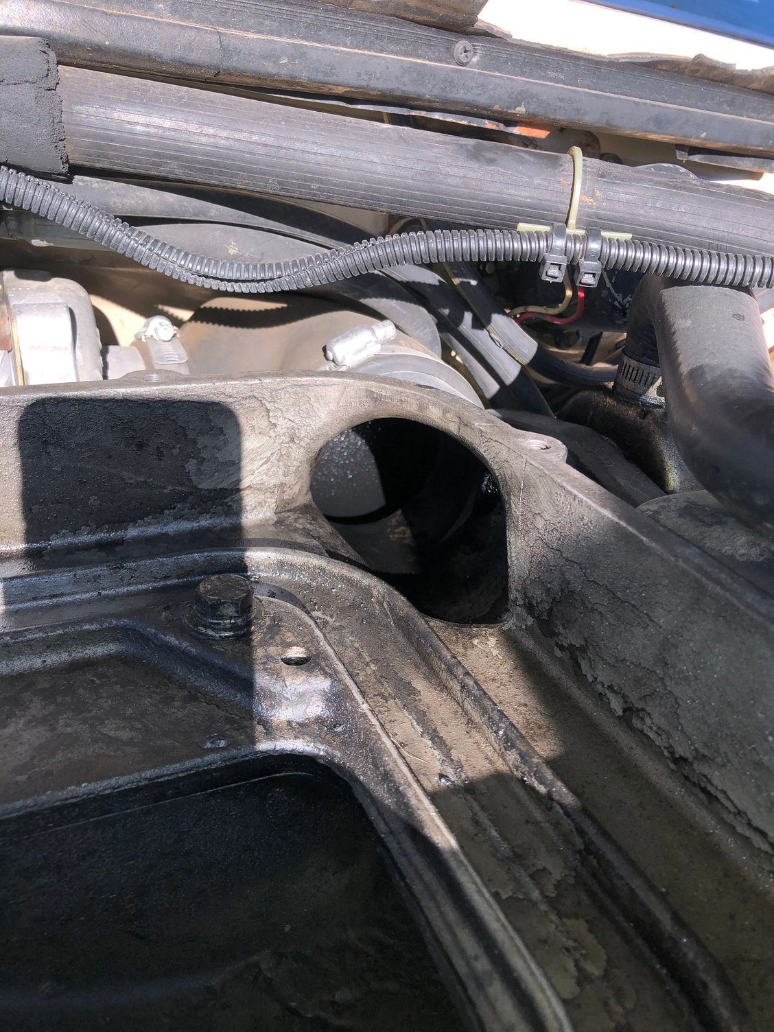

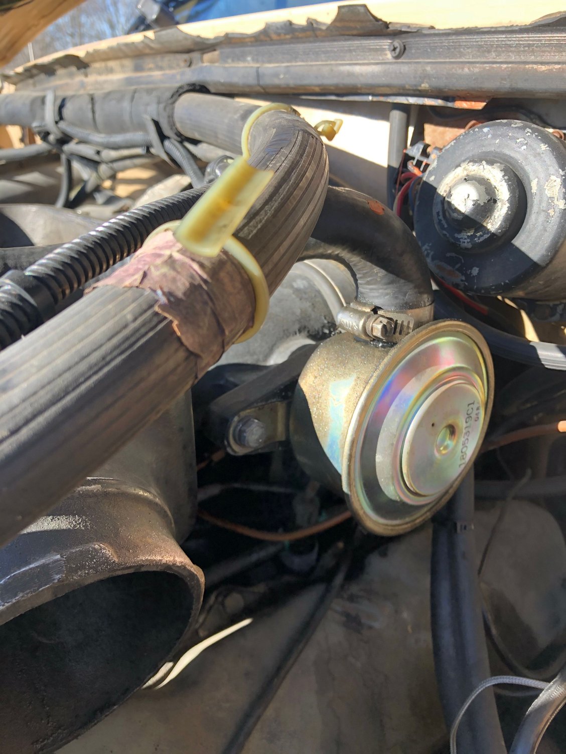

Update Time! I finished the driver side pillar pod and have installed it and the gauges. But upon installing the gauges I noticed that the boost line coming from the intake to the boost gauge had oil coming from it. So digging into the intake I am seeing oil in the air box and it looks like its coming from the CDR valve. I know the CDR valve has a reason for being there but maybe it isn't working properly??? The oil coming from the CDR valve is a lot. Enough to make it to the boost gauge line and out the other end. So I didn't connect the boost gauge all the way to the intake just yet because I'd like to figure out what to do about all the oil. I don't want to fill my gauge with oil. Help would be greatly appreciated here because all I can think of is trying to delete the CDR valve.

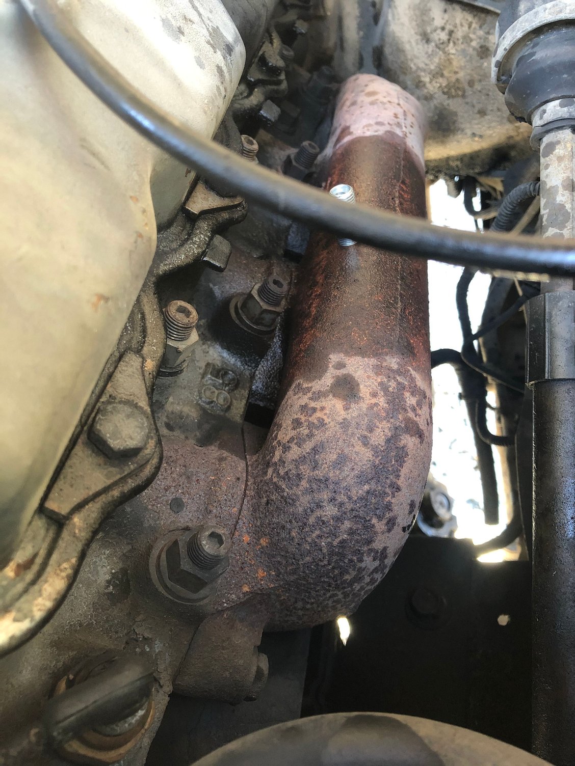

Also I was told that everything was original on the motor and that everything is factory. lol.... In the last picture here, are those ARP head studs???

Yup those are arp studs. If you clean the top of the stuff off with a wire brush they should have arp stamped in them. For whatever reason the 6.9 set comes with six point nuts where most are 12.
Oil from the cdr is normal. International used a positive pressure crank system on these and as it gets older you get more and more blowby. Easiest way to tell the health of the engine is to go to harbor freight and get a 30$ diesel compression tester, I had to file the adapter down to get it in there with the injector lines on but other than that it worked great.
300psi minimum, 350+ prefered. Some 6.9's made 500 psi...
Test with the motor up to temp if you can. Cold numbers aren't really important unless it's becoming a bear to start.
Cdr is just like a spring loaded valve so if the filter gets clogged the vacuum will close it off so you don't suck up oil and have a run away.
Changing mine on both my old motors made zero difference in oil amounts in intake. I rebuilt my engine with really tight ring gaps to prevent this exact problem.
