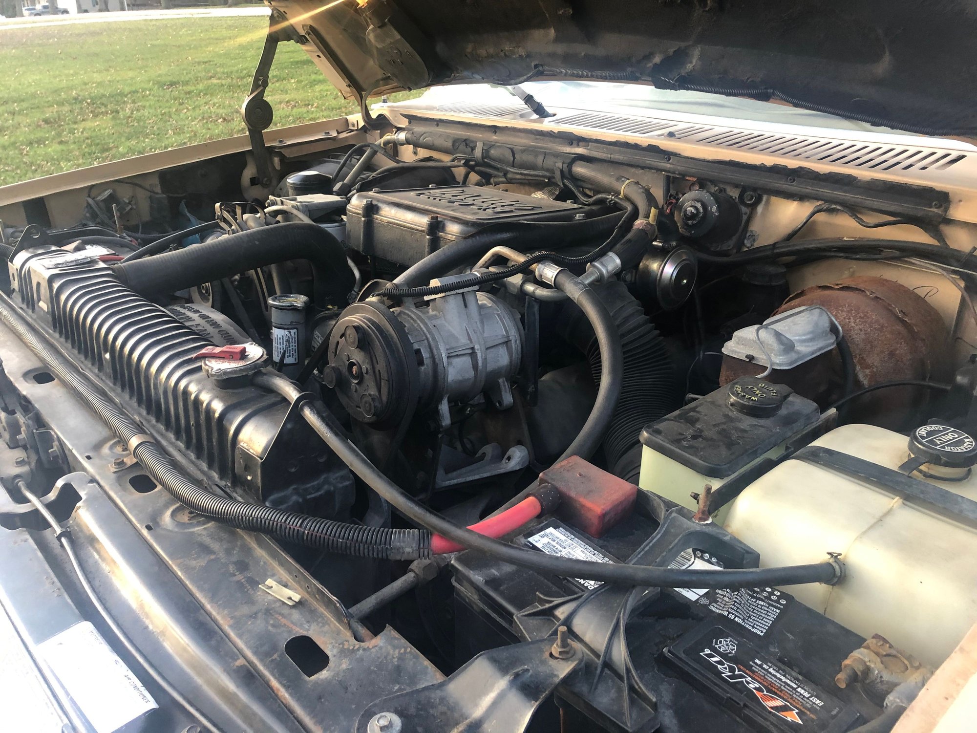

Turbo on an 85 is aftermarket, my 85 has the same one.
as yours.
When you pull the lid off the filter box, there is a K&N filter.
Mine was dirty, scrunched and twisted. Tried to find a paper

You're correct on the turbo being aftermarket, but some dealers did sell them with a kit already installed, kind of like they used to do dealer a/c kits. Probably how the original owner bought it and that's where the confusion comes from.

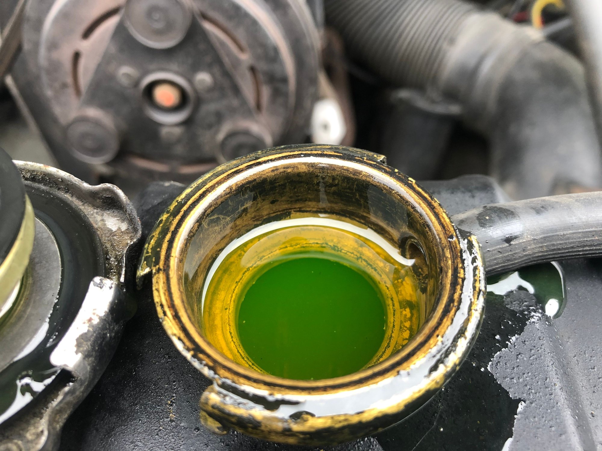

So I went out and tried to take a couple more pictures. So the radiator is full of green but I would think that the oil would settle to the bottom over night. Also the radiator overfill tank is still pretty full even after the truck cooling down over night. Everything is pretty wet right now from a storm passing through last night but I plan on moving the truck and draining both the radiator and oil to see what they look like and replace with fresh. I figured I would have to drain them anyways to replace the oil cooler. I have not looked inside the intake yet for oil nor done the blow by check but I plan to. I just gotta get the kids down for naps first.

if you had oil going into the coolant, it would look like light chocolate milk. and it will not separate after sitting overnight.

yes sir could be...... if a quart of oil was in the Coolant I'm pretty sure we would have seen it in the picture of the radiator filler neck.... I don't see any.

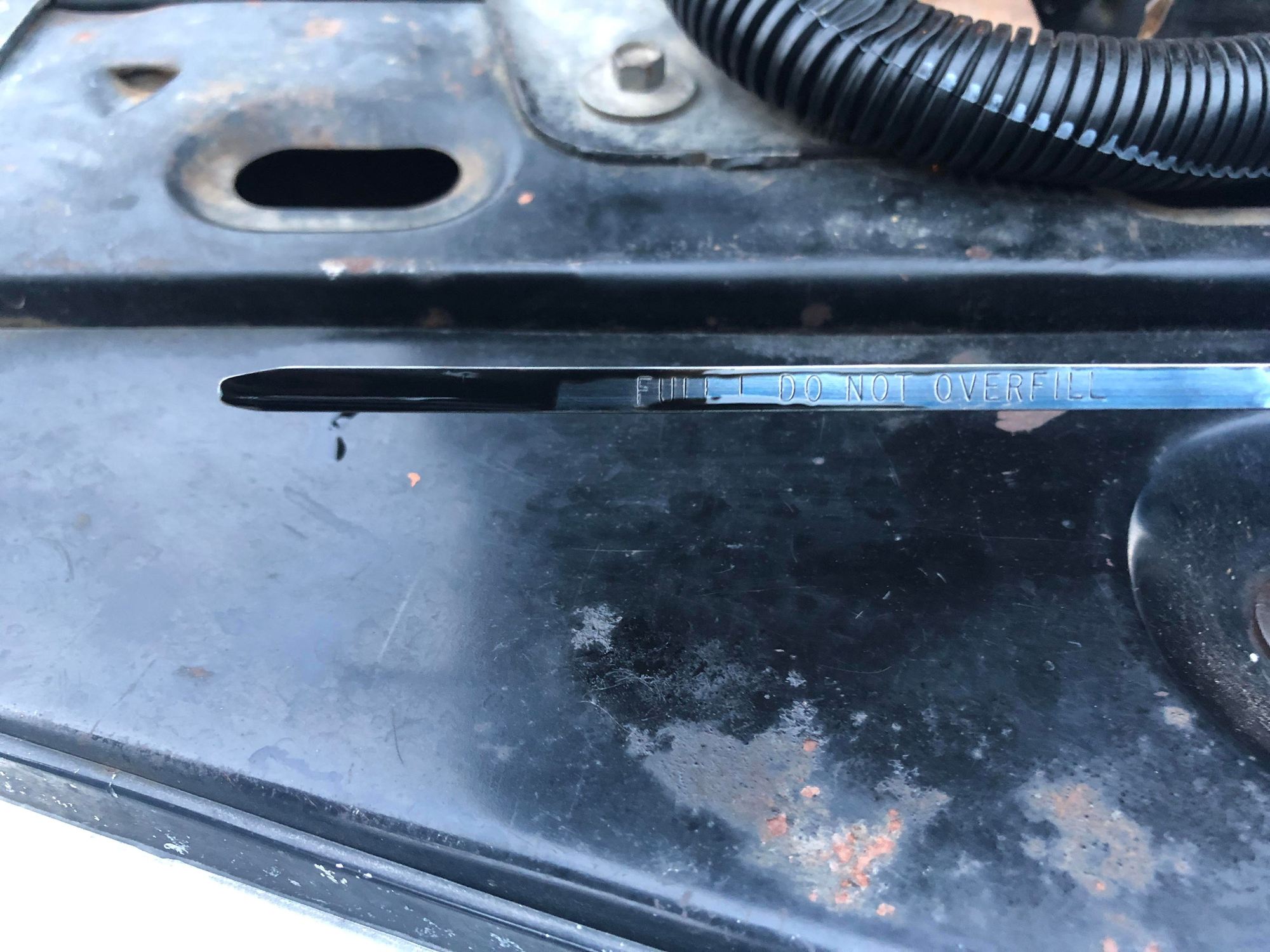

Ok so this could be good news and that the previous owner just put too much oil in? Also I've taken a picture of the dip stick with oil on it as it has now sat all night at most of the day so its cold. Is this around the correct fill level for being cold? Should I just continue to drive the truck and monitor the oil? I was going to take the truck up to my fathers to go hunt but the trip is a little over 2 hours/140 miles. Think it will make the trip? And THANKS! to everyone with the help on this so far.
