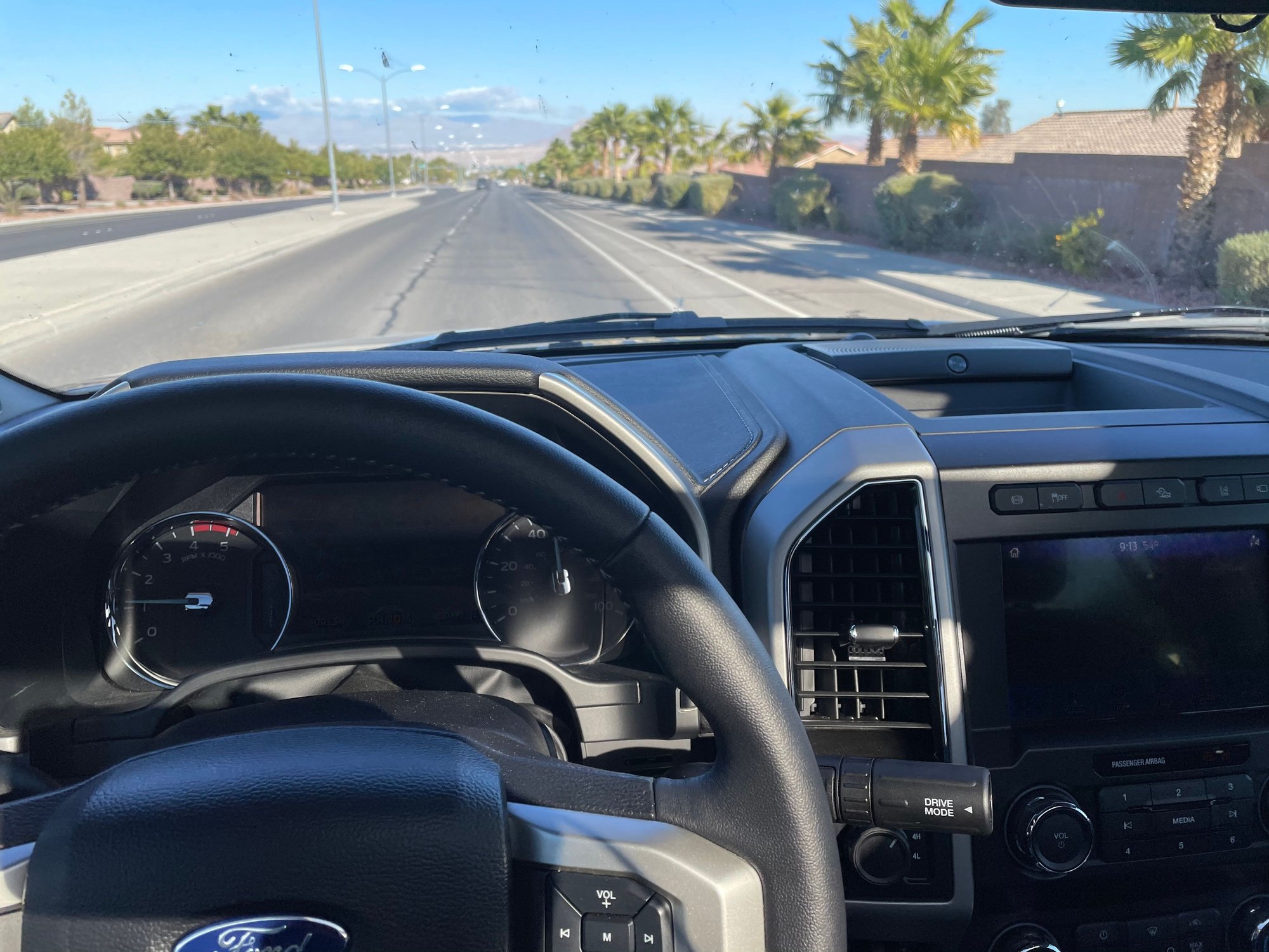

Th
This is how bright it was this morning driving to work and my headlights turned on. Seems a bit ridiculous.

Originally Posted by Rizzy
Th
Yea, that's not right. The little I've driven mine so far they come on at a reasonable level of light (Or dark?) and stay on. You may be stuck taking it in.

I love both as well, I just wish my headlights didn't turn on even though the sun's up just because there's a shadow on the dash.

Just for kicks,, are you sure the headlights are turning on? If your dash dimmer is turned down, and the lights turn off, the dash will dim like that.

Haha, yes. I'm not incompetent.
I can see the reflection of my headlights in the car in front of me. But also while driving around when the sun is coming in from the front windshield. If I turn and go in another direction and there's a shadow cast on my dash, the lights turn on (dash lights dim, etc.). I've noticed this is really only in the morning and late afternoons. If the sun is higher in the sky it doesn't really happen. This morning driving to work (20 minute drive) I counted my lights turned on/off 5 times. Yes, I could just manually turn them off but then my DRL's aren't on and I like having them on, mainly because I have the all LED headlights and I like the look of them on my truck. Yes, vanity, I know.
It just seems that the light sensor is a bit TOO sensitive and I think there should be an adjustment for that, like many other vehicles I've owned.
