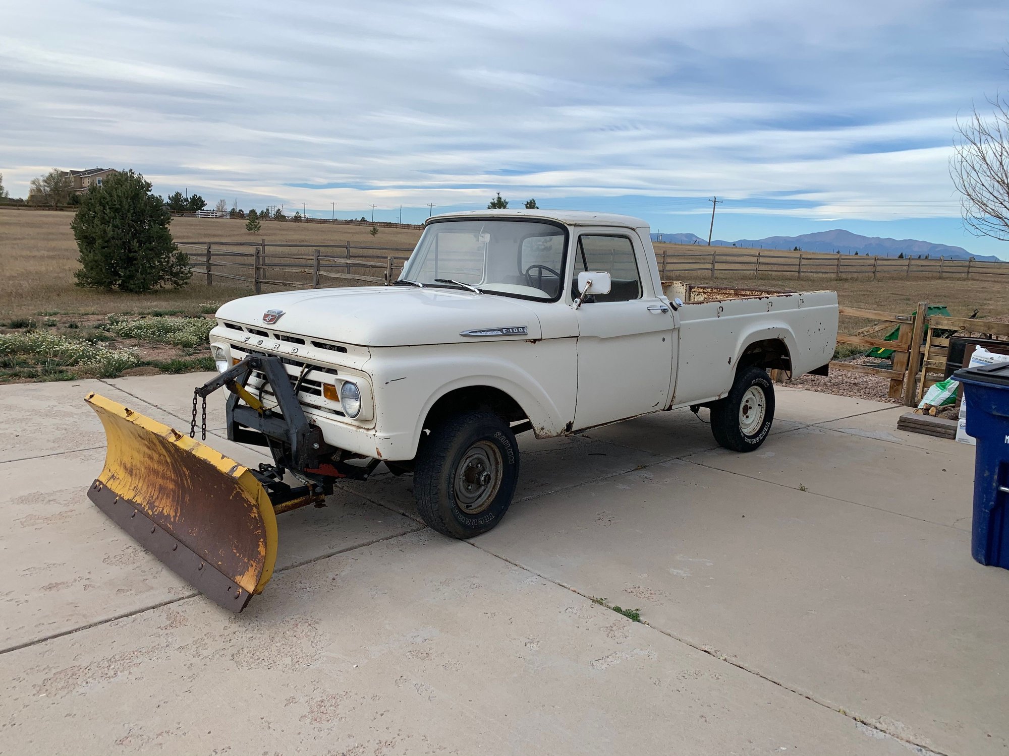

Guys I have a 1962 F100 4x4 wring bed truck
seems pretty simple but it’s not. The truck is completely original and was a special order truck with the “B” code 262 I6. She runs and I’m tuning it up to get it better.
Parts seem to be just a touch off or no one has info on replacement parts. Keeping it original and even found some NOS parts already.
a manual would be a great help with any pictures would be appreciated.
From what I’ve seen so far on the web mine is the most original. This year I really just want to go through the running gear and then dive into the rust in the summer as it is also my plow truck
any help is appreciated
62 F100 4X4 “B” code engine 262

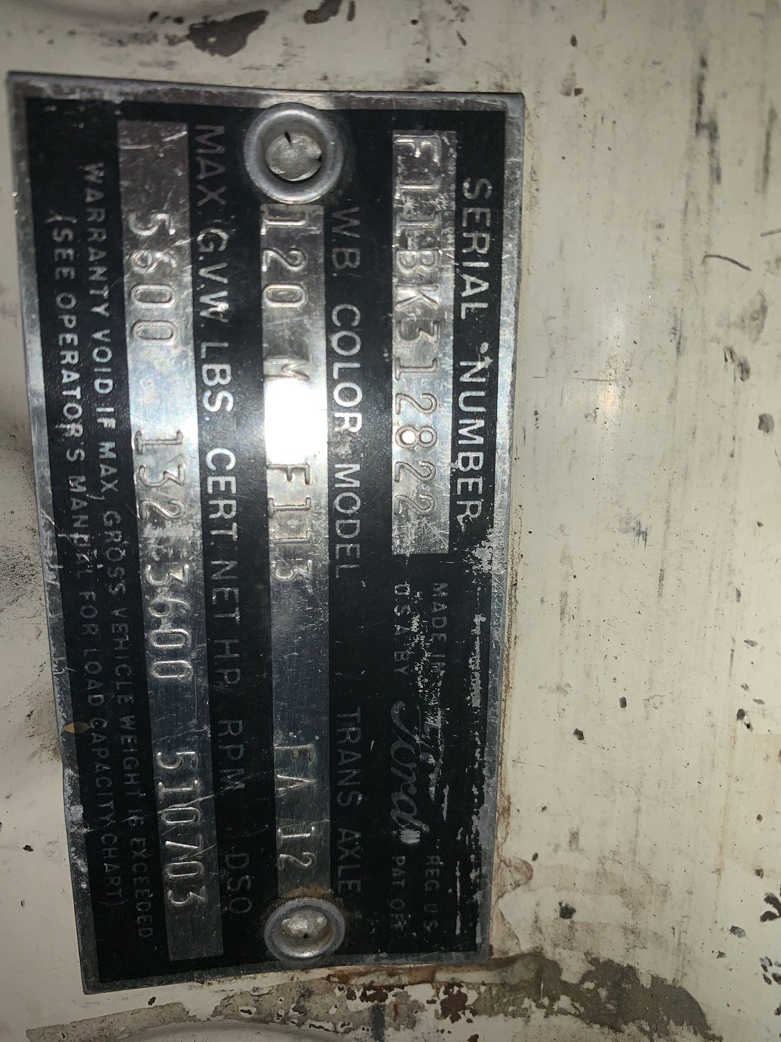

They didn't make a ton of the 4x4 trucks. Yours looks very good and I see it is still sporting the 8 bolt Warn M4 locking hubs. Those were only used from 1959-1965 and then Warn changed the design. Well worth keeping those going. Post a pic of the warranty plate and I add it to my list and decode it if you want. I have two 1966 F250 4x4 trucks which share some of the same parts.

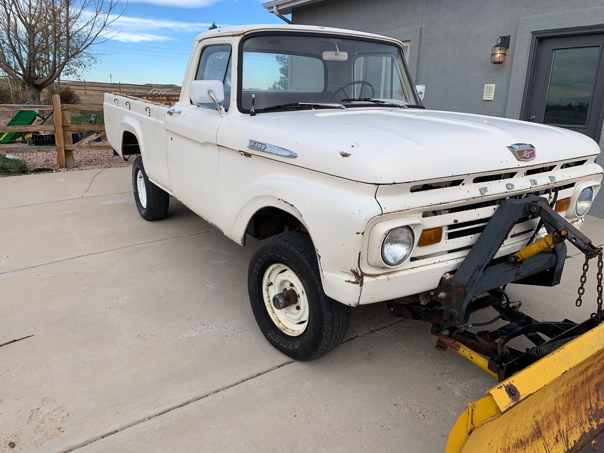

Very nice looking truck and surprisingly good condition for an old plow truck.
Old Nov 3, 2020 | 05:58 PM
Elmersford's Avatar
Elmersford
Joined: Nov 2020
Posts: 17
Thank you
it’s got the regular rust in the floors and steps
not to bad in the bed as the original owner had a shell on it but still could use some luv

Here's the quick VIN decode.
Old Nov 3, 2020 | 07:52 PM
Elmersford's Avatar
Elmersford
Joined: Nov 2020
Posts: 17
I did something like this decode on another link
i was able to see the axles too
3.89 9” in the back and Dana 3.92 up front
i didn’t know about the Warn hubs! I will definitely keep them
thanks guys

Different front / rear axle ratios.... how did they not fight each other? Did they install different sized (taller/shorter) tires? Or isn't the 0.03 ratio enough difference to worry about? (between 3.89 and 3.92).....
BarnieTrk
Old Nov 4, 2020 | 08:54 PM
Christmas's Avatar
Christmas
Joined: Jun 2018
Posts: 3,553
Likes: 442
My question is how do you get traction on icy / snowy road to get any traction with those tires?
Old Nov 4, 2020 | 10:22 PM
Elmersford's Avatar
Elmersford
Joined: Nov 2020
Posts: 17
Found the axle set up on fortification. On their decoder
Old Nov 4, 2020 | 10:23 PM
Elmersford's Avatar
Elmersford
Joined: Nov 2020
Posts: 17
Came like that . Does have chains too. Definitely looking to switch out tires and maybe the rims to a taller stock steel rim with the stock look
Old Nov 4, 2020 | 10:29 PM
Elmersford's Avatar
Elmersford
Joined: Nov 2020
Posts: 17
Rear axle code 12 61/62 3.89 (3.3M) Ford (WBG) F100 2WD & 4WD
Front axle code A 4/W/D (frt.) 4/W/D Free running (frt.) 3.92 (3M) Dana/Spicer 446F
Guess this way your front is faster and the rear doesn’t push and bind on the transfer case? Just a thought
You are correct
