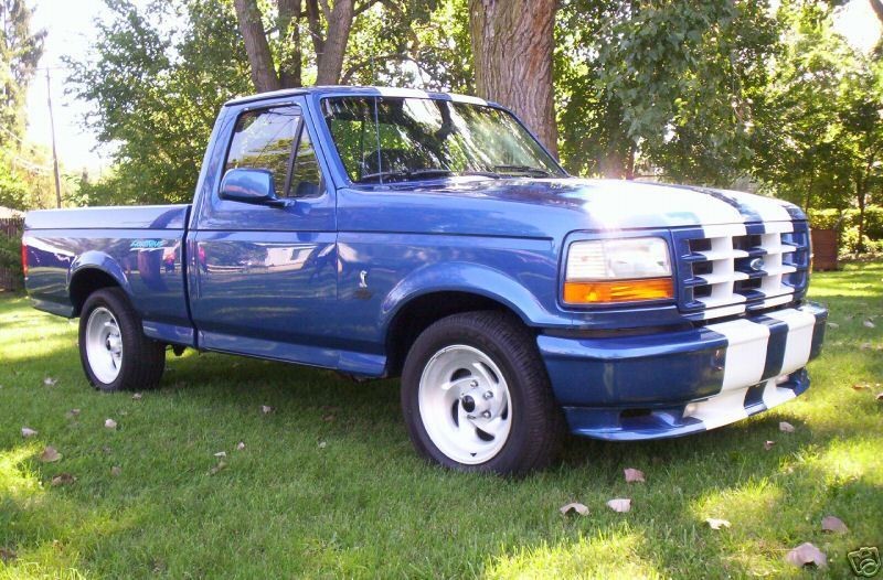

Looking good!
It needs some white stripes with that blue..
