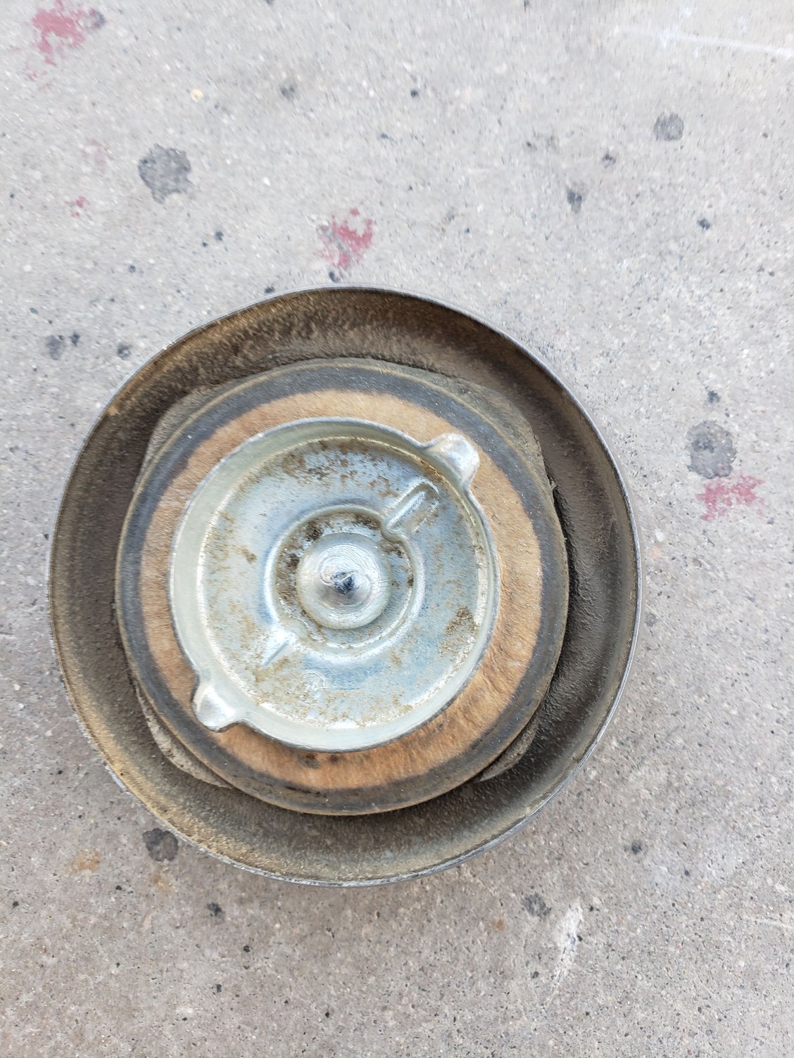

The vented gas cap has a gasket to keep gas sloshing out. You should see a small hole on back of vented cap.
Actually, I looked at my old cap. It has two holes near the tabs that holds it on the filler tube. They connect to four holes around outer edge. I'm going to try this cap on mine. I have been using a pretty chrome cap I think was on donor cap. I see no holes in it but was able to blow through it on a filler tube. Maybe old cap would vent better. I have had a lot of carburetor issues so who knows.

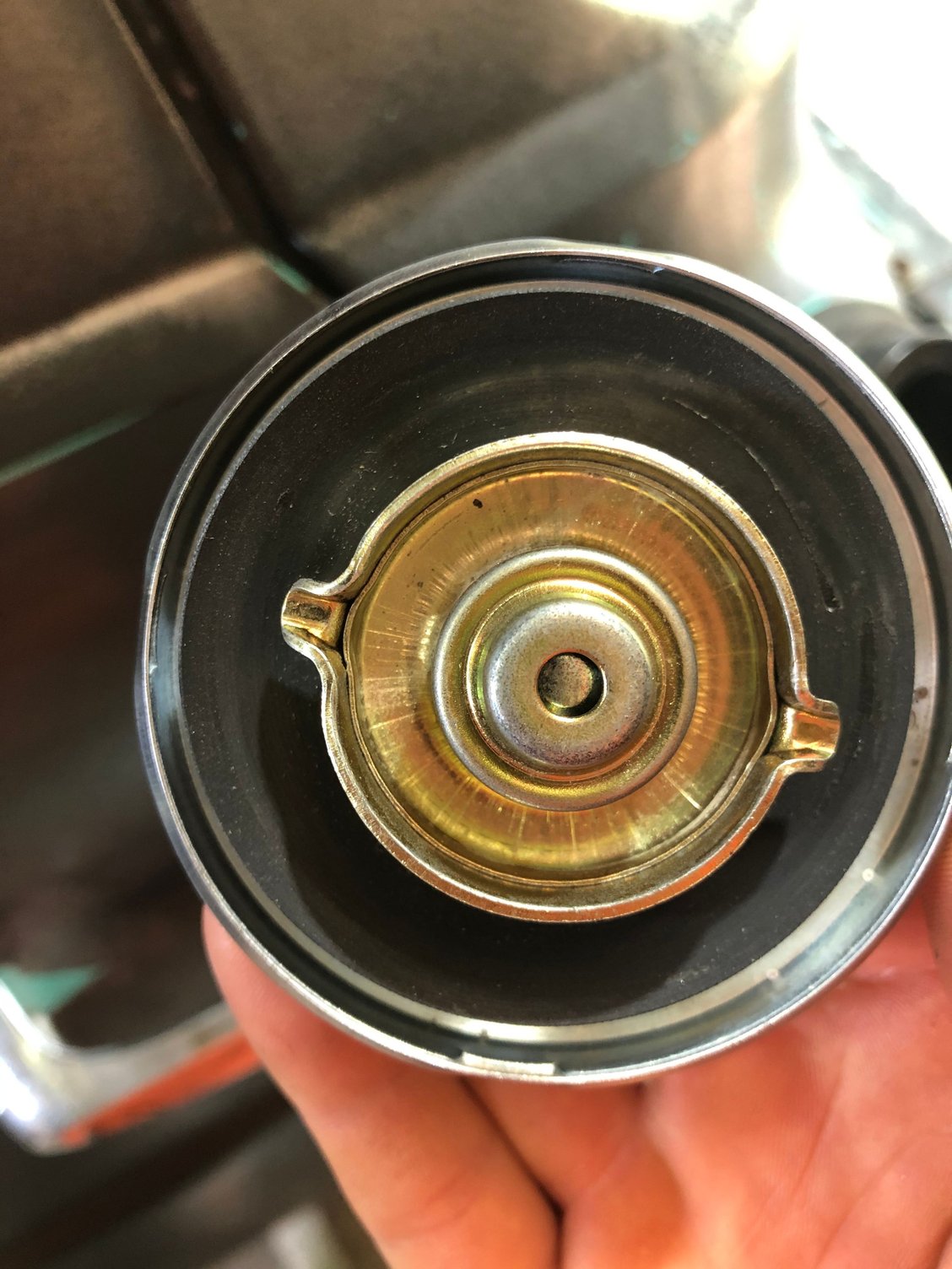

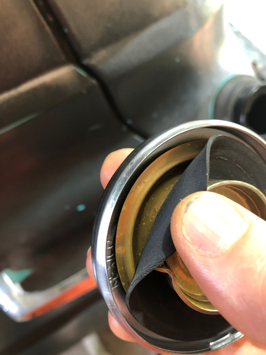

This is the vented gas cap i have from LMC.
There is a little one way valve in the center to let air in and it has a spring that pressure has to overcome to escape when there is tank pressure.
Valve in middle
Rubber seals against filler and to the gold backing plate but allows ventilation to pass between the gold backing plate and silver back side of the cap

My chrome cap is different. It has a spring but no center hole. Apparently, with cap screwed down the vent opens. I can put it on an extra filler tube and hear sir blowing out with cap tight.
