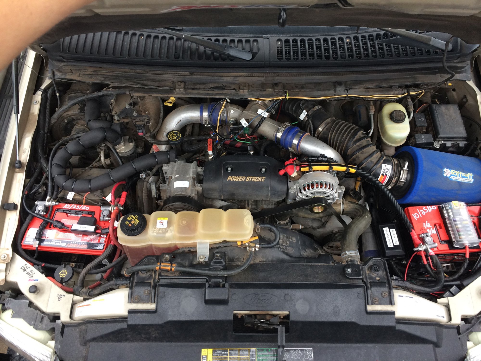

This past weekend I completed my "big 3" upgrade. New 160 amp quickstart alternator, odyssey batteries and supplemental 2/0 wiring from alternator to each battery. I also installed a 2/0 ground cable from the back of the alternator to the drivers side battery.
See this pic here...
Tonight was the first time I had to test the system at dark. I noticed right away that at idle as I play with the throttle and rev the engine my interior and exterior lights surge (brighten and dim) with the fluctuating RPM. Its very noticeable. I'm pretty sure it should not be doing this. It didn't do this before I swapped everything. I did monitor voltage through my cts and the voltage seems very touchy. By touchy I mean that it will hold 14.4v at idle and I soon as I touch the throttle it'll dip to 13.7-13.9v and come back up to 14.4v. IIRC my old oem alternator would stay rock steady until I put a real load on it.
Tomorrow I plan to disconnect the supplemental wiring from the alternator running to each battery and try that. Then may be remove the extra ground. None of that should make a difference though.
Any thoughts on what it could be or what I should check? I've a big road trip planned for this next weekend and would like to take this truck if possible. Thanks
