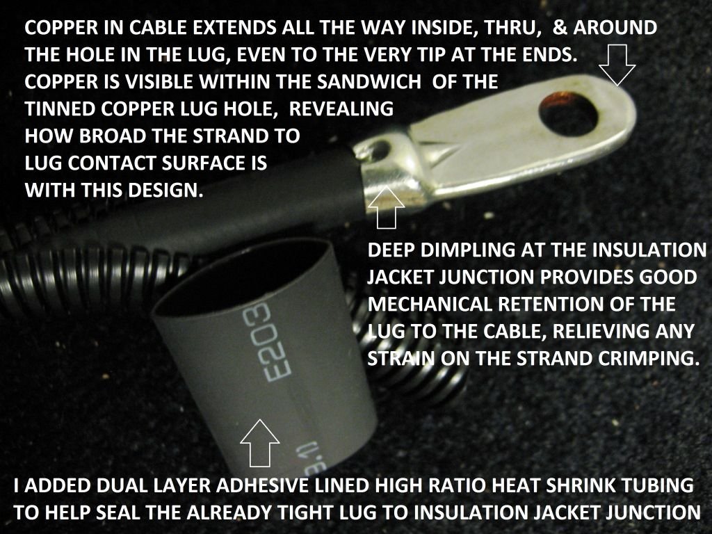

Yes, I have dual alternators as well, as originally equipped, and yet I installed the Leece Neville AVi160 when my original alternators failed (after 15 years in service). I did not delete the second alternator.
I DID upgrade the B+ and ground cables for the Leece Neville alternator, per the strong recommendations of Leece Neville, and per the requirements of Ford and International when this alternator is installed in the Low Cab Foward chassis cab.
The cable upgrade was in addition to, not in replace of, the original stock wiring.
Since I had already upgraded batteries to AGM batteries back in 2009 (and those batteries lasted 10 years), I did not have any corrosion wicking or battery terminal degradation on my OEM battery cables, so there was no need to replace any original cabling.
However, the current carrying capacity of the original cabling was inadequate to support the current producing capacity of the Leece Neville alternator, so additional cables were added to distribute the load, reducing resistance. A couple of ancillary benefits of multiple cables in parallel, instead of a single thick azz cable replacement, are heat dispersion and redundancy in the unlikely event that one cable ever becomes compromised be corrosion, which might increase resistance. The additional cabling offers an alternate path, which reduces the impact of any one cable's degradation.
The additional cables installed with the Leece Neville alternator were as follows:
- 1 additional dedicated positive lead from B+ terminal of alternator directly to positive terminal of driver's side battery.
- 1 additional dedicated positive lead from B+ terminal of alternator directly to positive terminal of passenger side battery.
- 1 additional dedicated positive paralleling lead from the positive terminal of the driver's side battery to the positive terminal of the passenger side battery
- 1 additional ground cable from the alternator's rear ground terminal directly to the engine block
- 1 additional ground cable from the alternator's rear ground terminal directly to the driver's side battery negative terminal.
While the alternator does ground to the block by way of the mounting bolts through the case, the case is actually bolted to an alternator bracket, which is bolted to the front cover, which is bolted to the block. The gap between the front cover and the block is sealed with sealant. While the cover bolts still provide continuity, the external copper cable added from alternator to block provides a direct unimpeded low resistance path, and leverages the provision that Leece Neville built into the alternator to do just that.

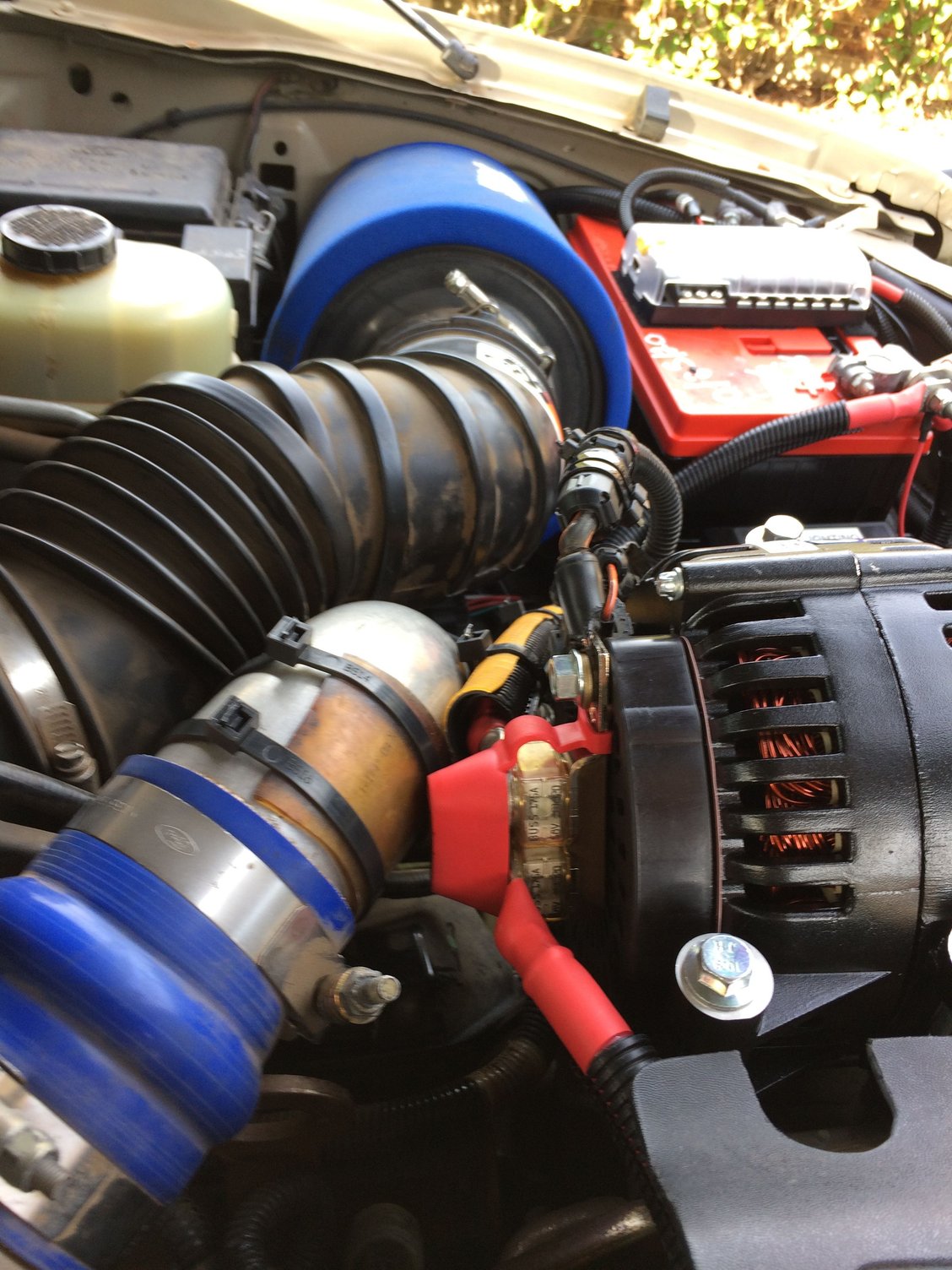

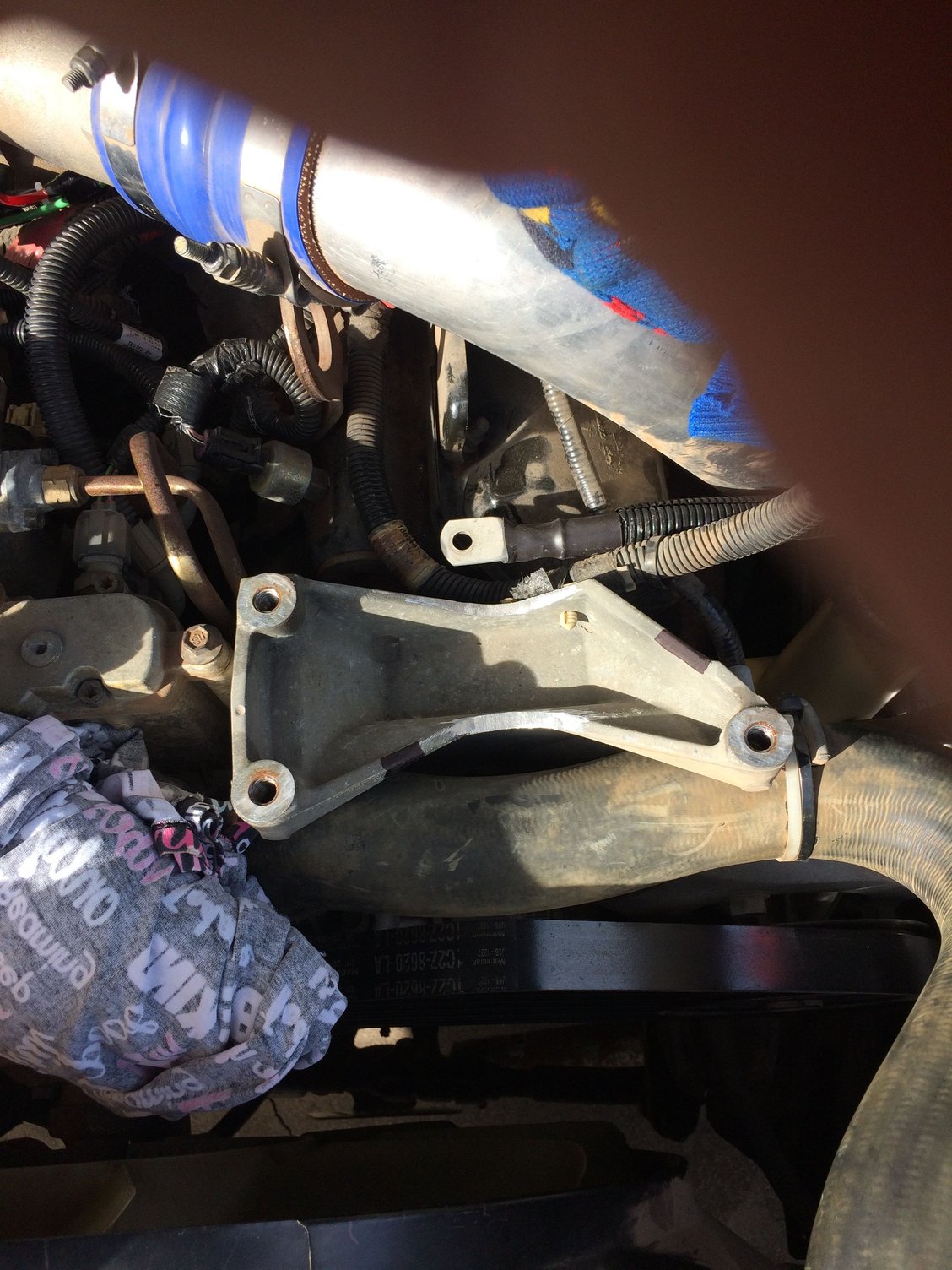

I installed the Leece Neville today. What a beast! Install was straight forward. Had to do some grinding on the alternator bracket. Also had to drill out the stock charging wire eyelet one size bigger to fit the lug on the leece. Very easy. It charges at 14.0v-14.2v. Never got above 14.4v. Zero voltage fluctuation with throttle input. FYI running a stock size pulley. I installed the fuse block just as Y2KW57 did. Also, this alternator doesn't get near as hot as the oem. Even after a drive. The OEM would almost send ya to the hospital it was so hot.
At idle I can kick on 85 amps worth of auxiliary accessories and the leece never goes below 13.9v-14.1v. Absolutely incredible!! I feel like I could power a small village with this thing lol!
Difference in size....
Black sharpie marks show where I had to grind. Last pic is final product...
You can see where I ziptied a piece of hose around the intercooler tube. I did this as a precaution against the fuse block.

Man that looks great in there. One of those would go nicely with my satin black IC tubes...
The back of the case must be non-conductive?
Thanks for posting pictures, I was hoping you would.

Thank you! yes, The back of the case has a plastic shield over it for that very reason.
