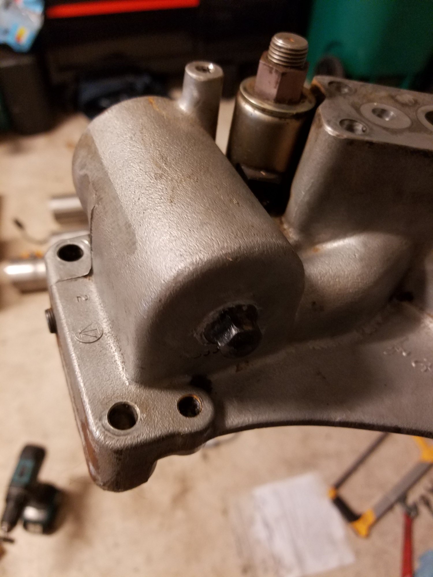

If you're on a tight budget you can delete the ebpv and keep the same pedestal and outlet. I have pics of it in my build thread. Others have cut the cylinder away and welded the ports shut too.
Nothing special about plugging it up. I cut the rod and left the guts in since there are possibly drain back issues. This is an old sterling 10.25 flange bolt and nut sealed up with RTV. No turbo oiling issues or leaks 18 months later after doing this.
It looks like my budget will be determined by my newfound tranny problems, but if anything I buy the delete pedestal to save myself a headache of any drainback problems and call it a day. If I end up spending the money up front and save myself the headache down the road it'll be worth it, especially since the truck is getting repainted and some goodies early next spring
