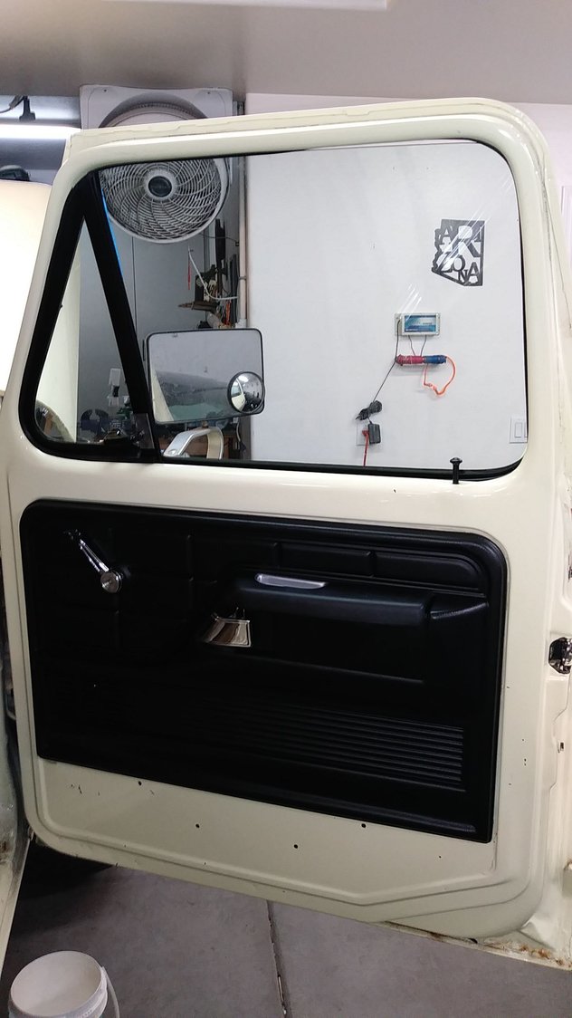

There is "permanent" haze on my windshield. It's embarrassing, but I am new to this & learning everything on my own. Anyone have ideas to fix this?

Replace the w/s, it is not on the inside or outside. But in between layers of glass. We all learn by reading, seeing (watching), asking questions and physically doing things. So ask away any questions, read all ya can, books, Ford truck repair manuals, FTE web site, U tube. Take a serious vested interest in your hobby.

some states will replace glass at no charge if your car/truck is insured.
it's a safety issue when you can't see very well through the windshield, whether it's a crack, rock mark, or in your case: delamination
If/when you replace the glass, get a new gasket, etc

While it may not work in your situation, I was amazed at the improvement in my glass when I used window cleaner & plumber's putty on it.
Spray a generous amount of window cleaner on the windshield, then lightly rub a small wad of plumber's putty across the windshield. Knead the putty as it gets dirty. When done, spray more cleaner & polish with paper towels. I spent 20 minutes on my windshield, when I was done it was so clear it was like there was nothing there. This even got off most of that crusty buildup that grows in the corners. This was on a 50 year old windshield.

0000 steel wool dry and then any car polish

Instead of plumbers putty use a clay bar meant for vehicles. They are cheap and reuseable.

That's delamination, replace the windshield. Its already been replaced before judging by the window stripping.

That being said, if you can clean up the windshield with steel wool, claybar, etc. do so. Your first picture looks more like safety glass which is delaminating and hazing between the glass. If so, there is no cure but replacement (whether at your or the insurance company's expense!)

I did this on the outside - to no avail.
I plan on doing the inside soon.

I thought it has been replaced too.

Wow. Looks good.

Thank you. I got a local quote for the windshield and installation for $189.
