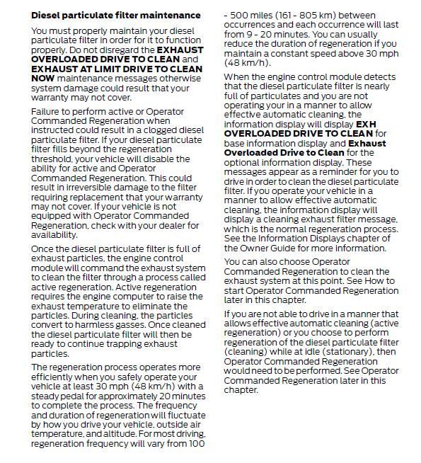

I have seen the "Drive to Clean" message a couple times on my 2015. It usually happens when can not maintain a regen in progress to a lower soot threshold when driving slow or maybe mountain with RV (my case) and the filter soot goes above a set amount.

This is from my 2015 Diesel supplement owner's manual. Your owner's manual might have similar section.
