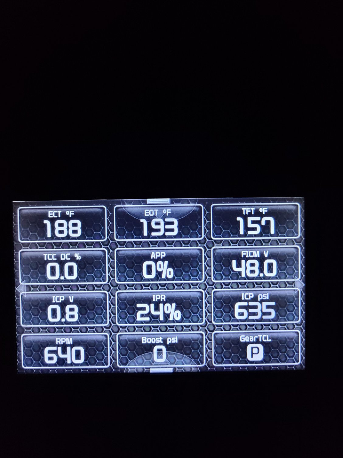

2003 220,000 no tunes. Started with low icp code and multiple attempts to start hot or cold with oil pouring down the back of the engine. Replaced icp (covered in oil) and cleaned, new screen and orings on IPR (old screen was good with no debre).
After this, it was still taking multiple attempts to start with IPC in the 300's and IPR commanded to 85% until it would hit the 500 IP. Then it would fire off. On some occasions I would get the low IPC code (which it was) and Cyl #6 contribution. Once started, it would run fine except at WOT. WOT IPR would command to 85% and IPC would be 900. I would see 2200 IP while cruising around and with light pedal acceleration.
Changed out IPR with a new one. Fires off everytime now. Havent seen the cyl 6 contribution code again. Though still only getting 900 IP at WOT with 26 boost. My other 6.0 show 3000 IP w/ 79% IPR at WOT.
CTS at KOEO:
KOER @ idle:
According to my idle IPR%, I shouldn't have a HPO leak. Correct me if I'm wrong. With all this going on, my MPG has gone way down. Dont know if that is related or not.

Got home. Hooked up shop air in the IPR slot. Didn't hear anything major with ccv out and oil filler cap off standing over engine. Pulled oil filter and gurgle gurgle, gurgle..... put oil filter back in. Put ear at CCV port, nothing. Put ear at oil fill tube, can hear a little bit of air moving through that area.
