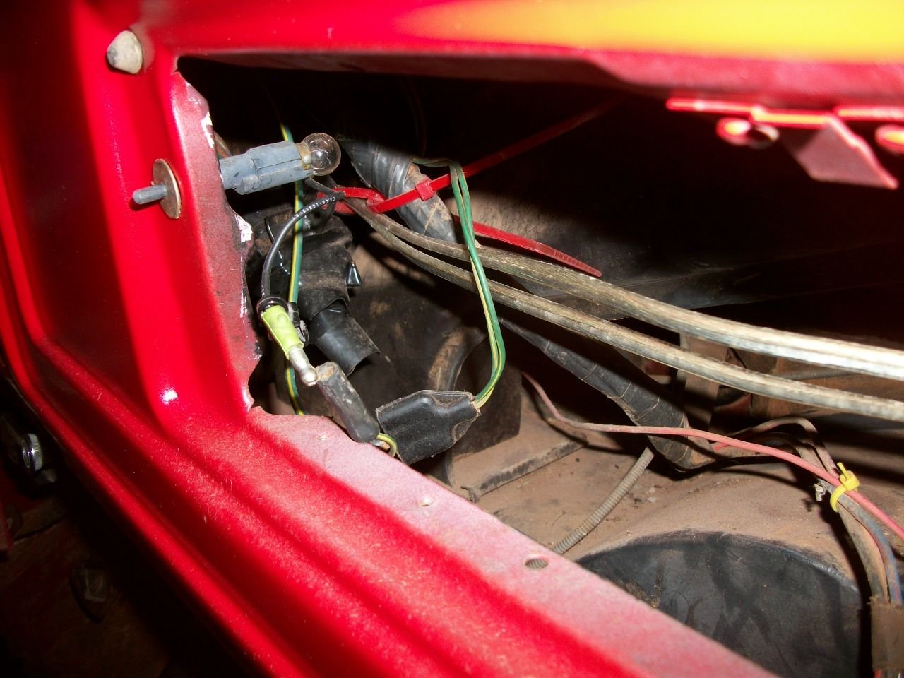

1. Ck fuse.
2. Ck the single plug elec wire on the back of the cig lighter itself. If get its ground from the thread on outer collar, locking it in the dash. Ck that it is tight.
3. The lone wire from the back of it goes over to towards the L/H side of the glove box and goes in a Y for the glove box light. Or in a 2 wire black 3 hole constant 12V power source plug.
