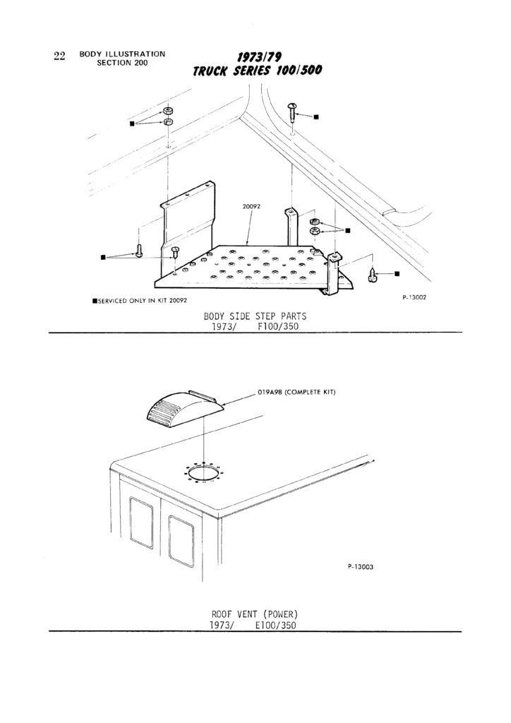

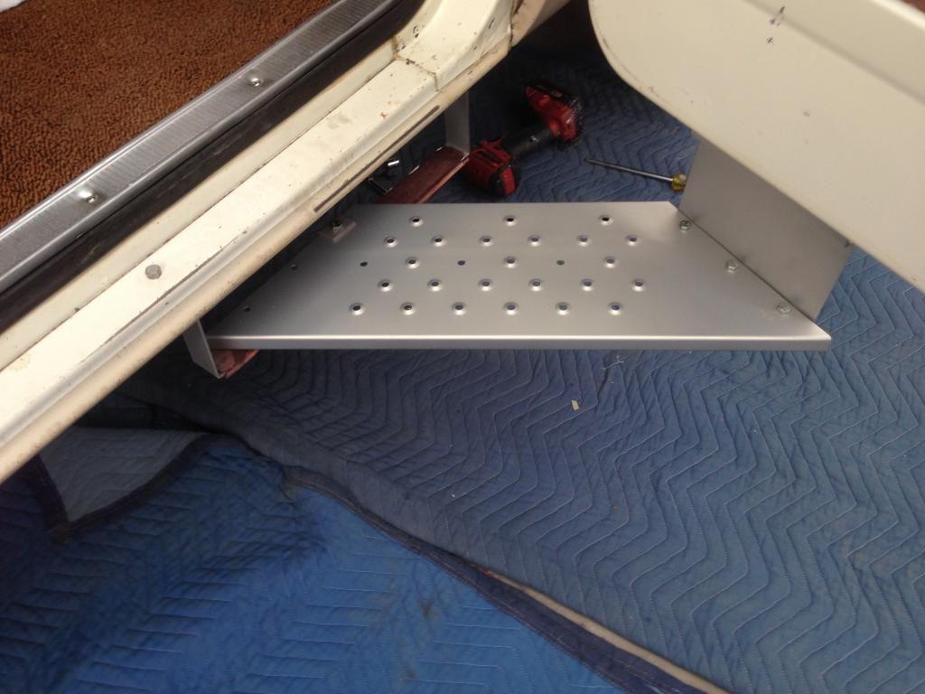

I’ll try to get a pic of my old school swing out step on my SuperCab. They used to be common but I haven’t seen another one in many years.
Old Oct 17, 2020 | 10:45 PM
77&79F250's Avatar
77&79F250
Moderator & parts slinger
Posts: 50,241
Likes: 5,811
This one?

77&79F250
That’s the one. There’s only the one on my truck, on the passenger side. The first wife’s ‘72 3/4t GMC had one on each side.

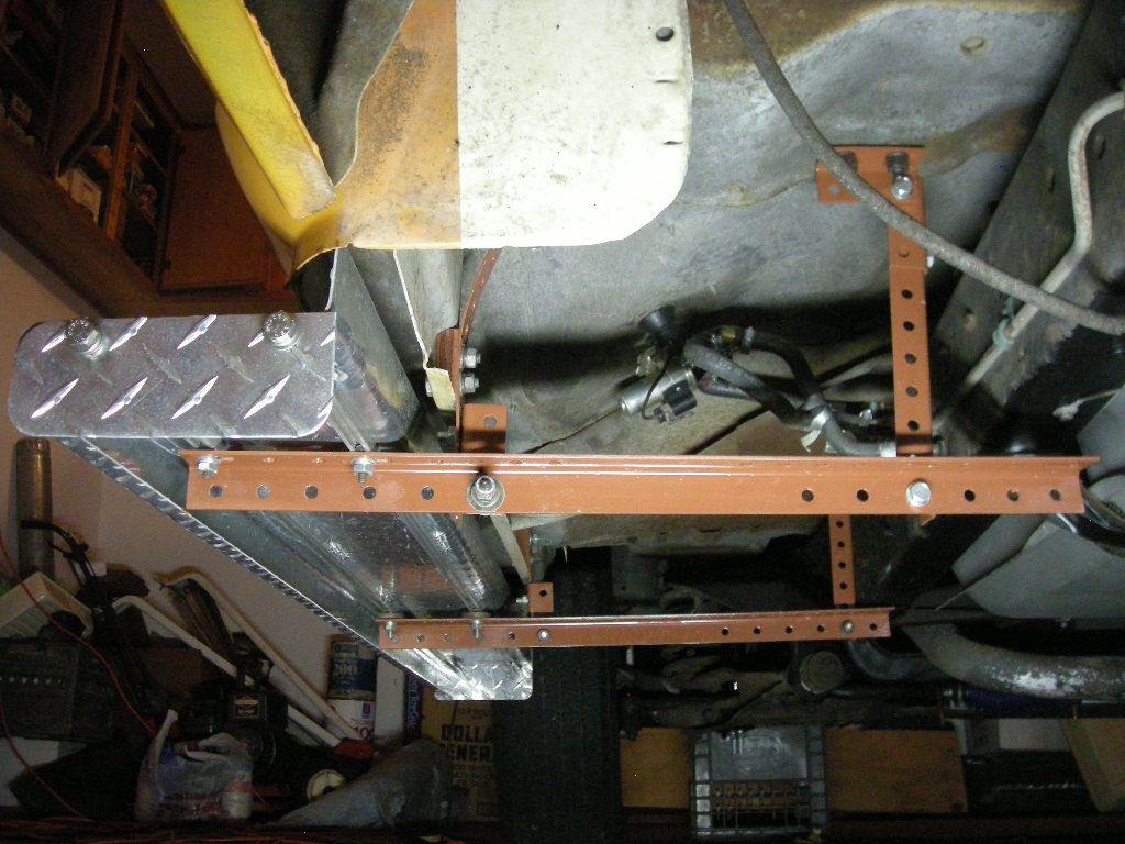

I added running boards to my 1976 F-250.

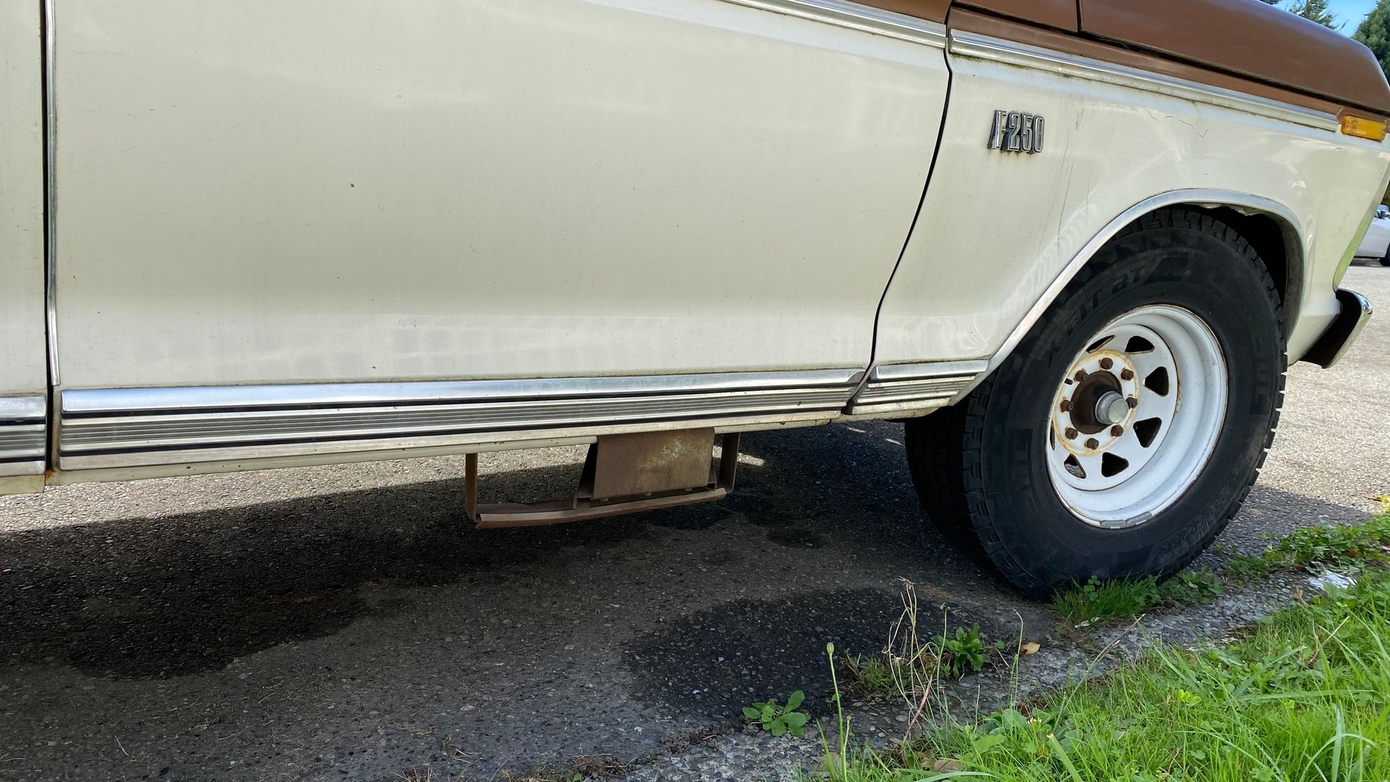

Here’s my single step.
Michael

Originally Posted by vettman
If you have pics of how it's mounted, please post.
Thanks
looking toward the rear
at the fender
looking toward the front
the manufacturer
It feels solid when you step on it.
