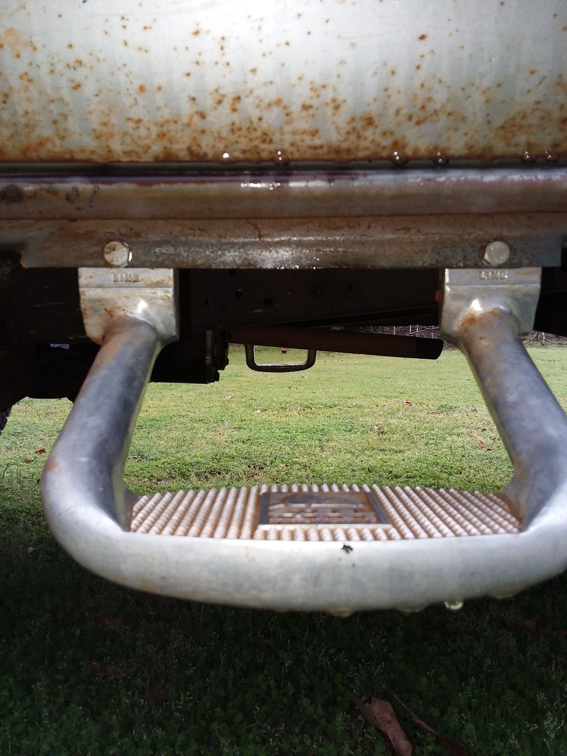

Aluminum Steps Fits Ford Explorer f150 f250 f350 super duty bronco full size
Item Id: 141978673621
Quantity: 1
Seller was: chewgum99
I want to say they were around 30.00 for the pair.
I got these off of ebay and made them work. They came with several mounting brackets and bolts, that I didn't use. I bent down and tab drilled holes and attached as shown. I'll try to get some better pictures when the storms stop.

Appreciate the pics and response. Thanks

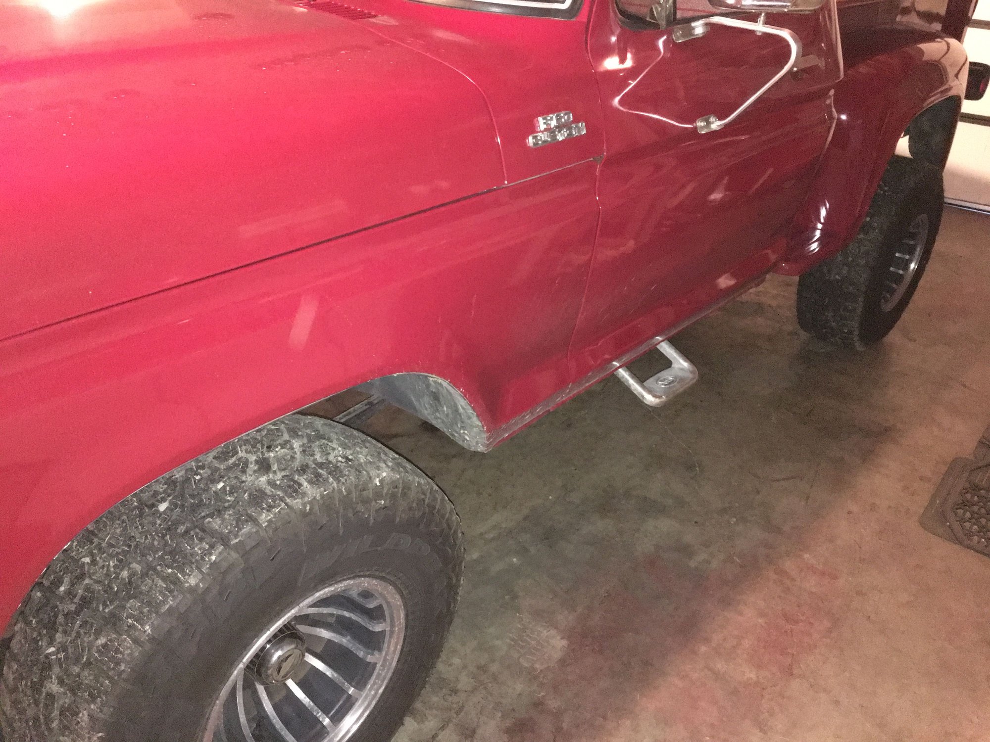

back in February I bought these Bully AS-600 polished steps from amazon for about $44.00 shipped. They come with extra parts and pieces for what seems like universal fit. This installation is pretty straight forward.

x2 on the Bully steps. Mine we supposed to fit a later model- I think he said OBS models. I don't remember for sure as they were used off Craigslist. Anyways, drilled them out to accommodate a second bolt and mounted them through the pinch weld, pretty much just like John89's pictures. Just be careful when selecting a spot to drill the pinch weld. Go as low as you can without leaving too thin of a section below the bottom bolt. You have to drill from the center of the truck outwards and if you are not careful, you end up drilling into the door jamb instead of just through the two pieces of metal if you go higher.

gohunt, thanks for the pics and info. I know the Bully as600 says they don't fit our older trucks however can be made to fit.

wyrm73, thanks for the heads up on installation.
