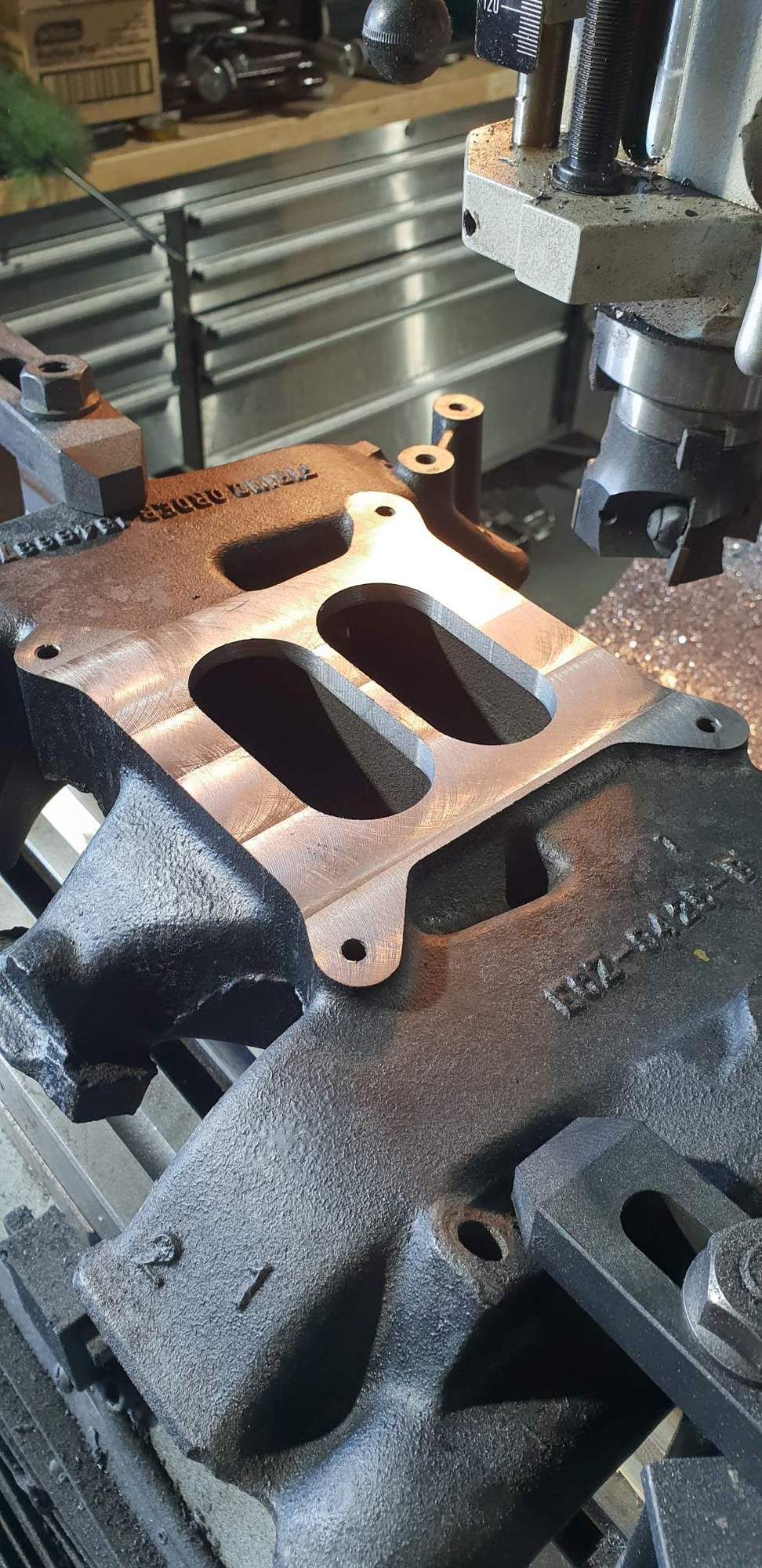

Thanks Dennis, so you took the intake down just enough for everything to be uniform flat? I assume you opened up the 4 holes to the 2 ovals in the intake? Did you port match the radiuses from the spacer to the intake? After reading the links I believe I’ll go Holley 600cfm vacuum secondaries, that sounds appropriate for my application of basically stock 312 w Rams Horns?

Yeah I did (the machinist did) take it down just enough to be flat. He also match the radius. I gave him my 2inch 4 hole carb spacer and he sorted it out.
with the added height of the carb spacer I did have to bend the pedal linkage to the carb for it to work.

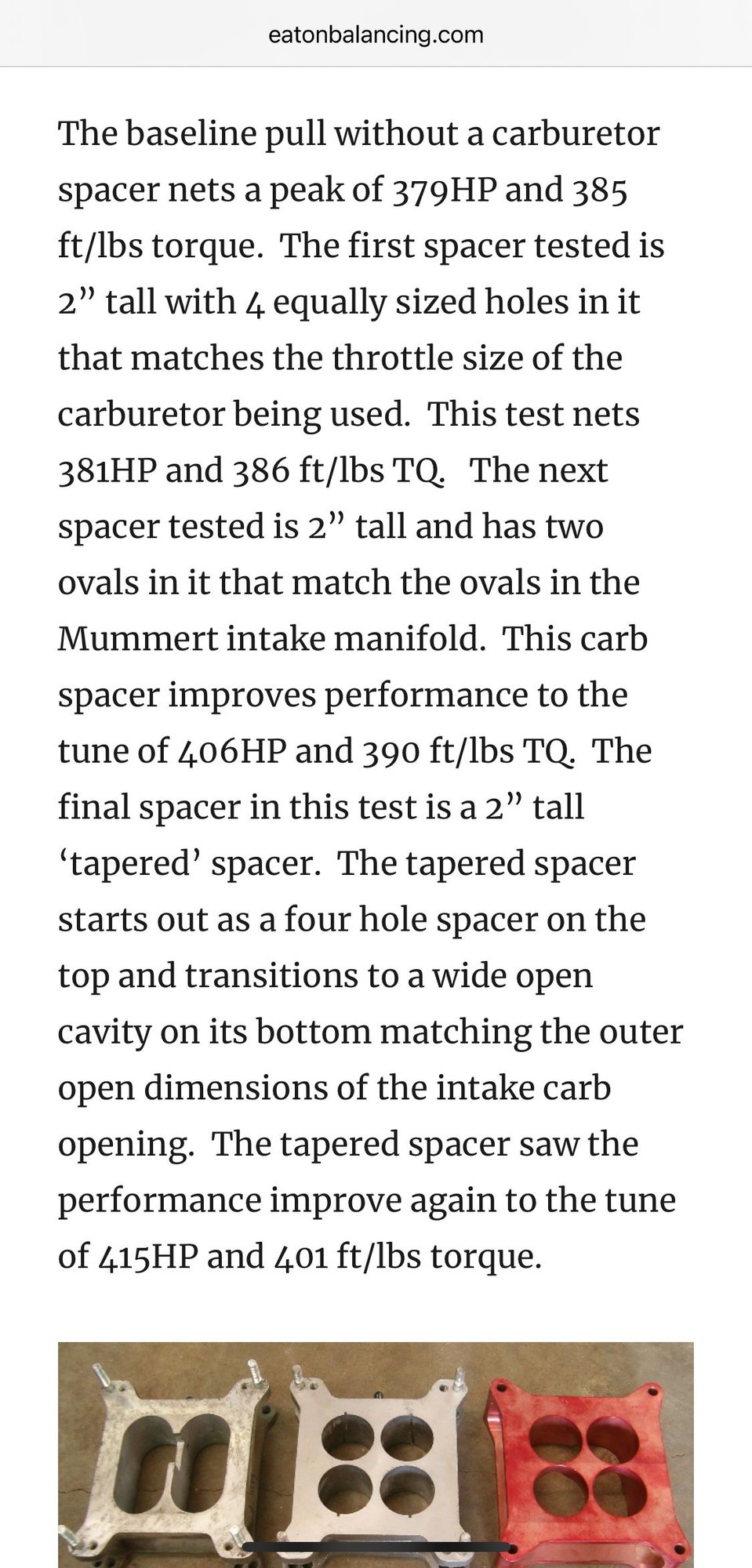

see below from Ted’s dyno run results.Yeah I went with the phenolic spacer.

Very interesting. I wish I knew more about that tapered spacer? Like, is it fully custom or off the shelf? Also I would like to see the Torque and Hp curve. I’m not interested in up top numbers. Useable torque is my main focus.

Not sure about the tapered spacer but summit has them. You would just have to measure the intake outside diameter and compare it to the spacer. The main thing is to make the intake manifold modification, according to Ted it gets the “best bang for your buck”.

The tapered spacer in that test is probably not what you want to use. These 4-hole tapered spacers are geared toward higher rpm performance because the design is such that while they do have for holes on top, they are effectively open on the bottom, making them behave more like a typical open spacer, although they do tend to be much better than a typical open spacer. If you have the money, by all means, try one and see how you like it but you will probably be happier with a typical 4-hole spacer or a divided spacer, both of which maintain the dual plane functionality of the intake, which helps low end and is generally what you want for street use. In that same regard, if you have the money try different heights of different styles of spacers, or even combinations like 4-hole stacked on divided.
