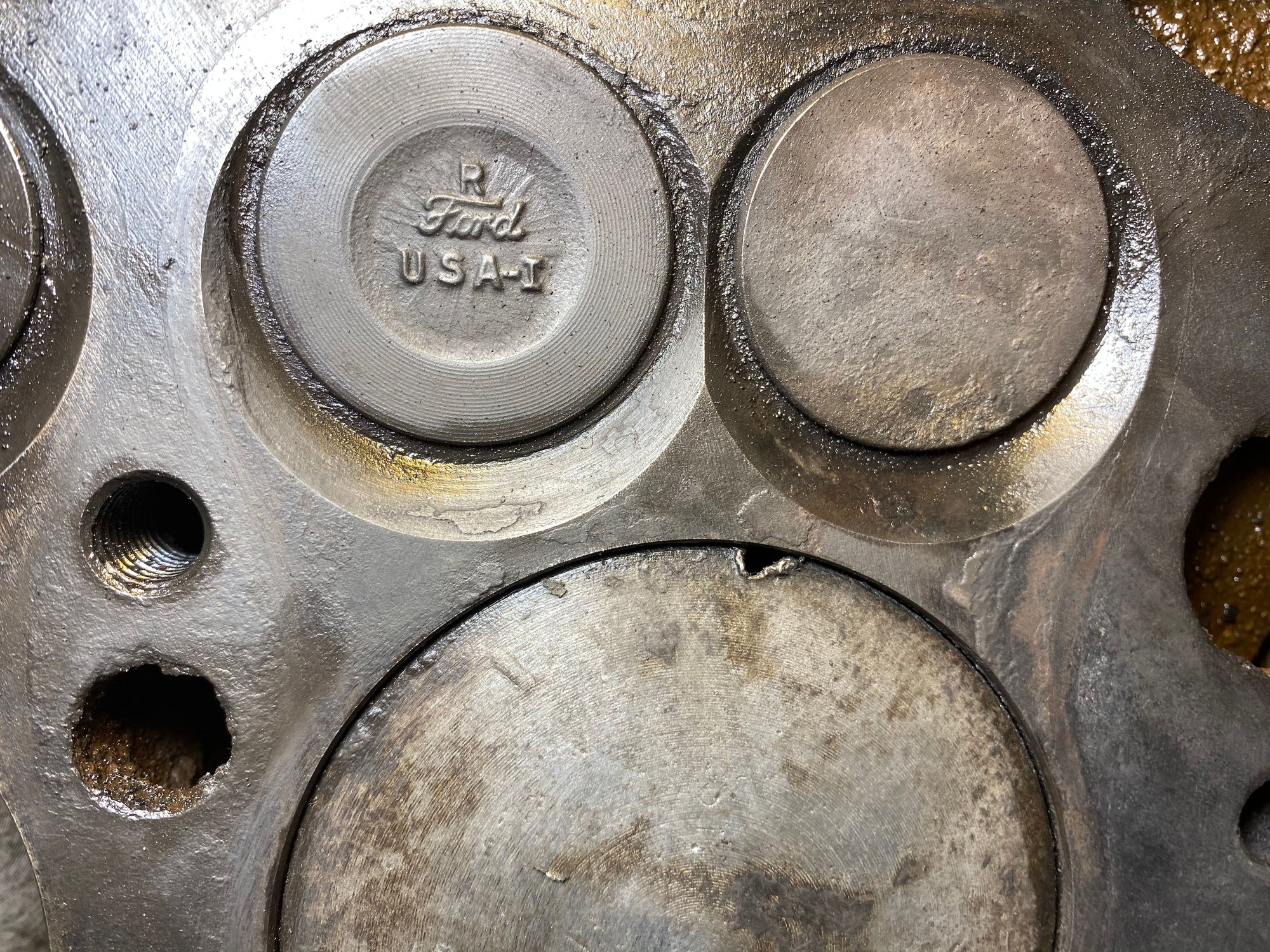

I twisted off the distributor hold down screw and pulled the head to drill it out on my 8BA. Here is the hole in the piston that I found.
I really hadn’t planned on replacing all 8 pistons and rings but I can’t find a single piston for sale. Did I just find my next project? My plans are to leave in the truck, hone and replace with standard pistons and rings

Do you know what bore it is? Pretty sue Egge and others will sell individual pistons and rings, but doesn't show on their websites, you have to call.

That is an unusual sort of hole. What does the head look like in the region?

Is that a faint 030 marking on the piston top ??

Maybe plan on replacing all eight pistons and rings. Then don't look much deeper or it will never end.
A good friend of mine owns an engine machine shop. Once he has purchased pistons for an old motor from Egge machine. Quality was horrible. Some so bad they were not usable.
It appears the damage came from the bottom, up. I'd bet there was a stuck ring and someone got too aggressive getting it loose.

Was the engine running prior to removing the head? If so, how well? Had you noticed any issues previously, prior to the broken bolt?
