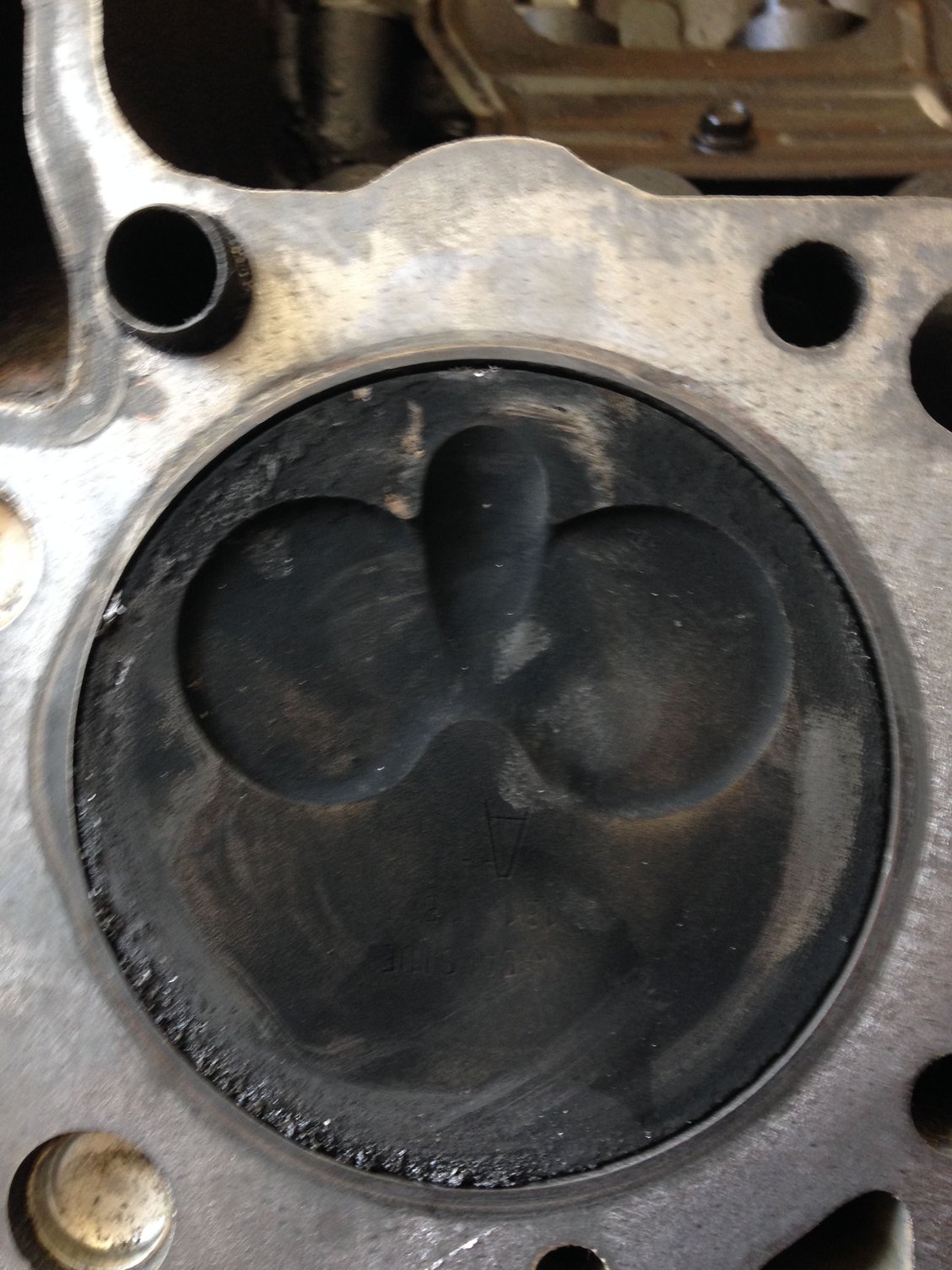

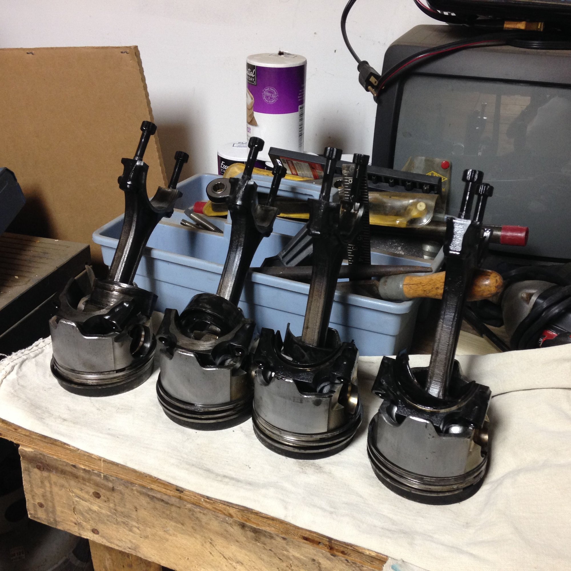

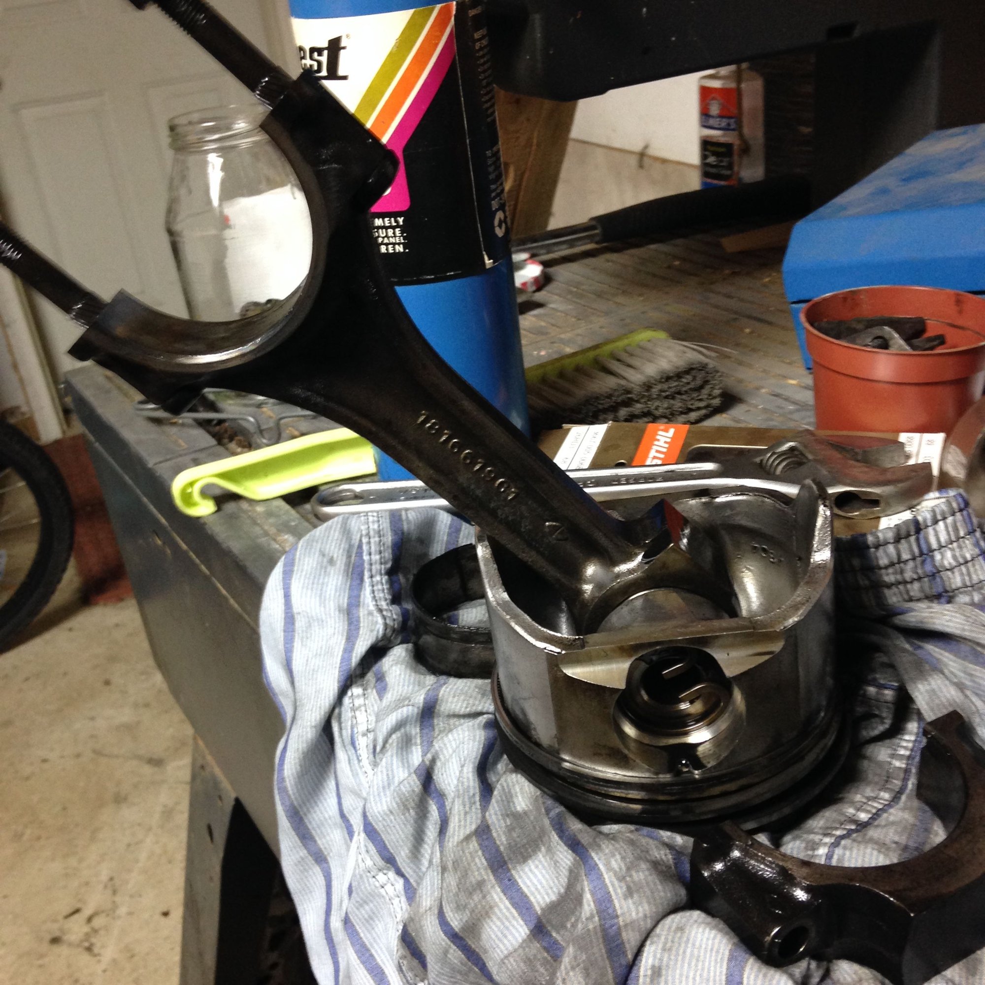

I have some spares. What do you need to know.....

That's what I had sitting on my phone from the IDIT teardown I did a few months back. I can grab some extra pics if you need something specific. Just give me a few days

Stock compression height is 1.95", the mahle lowered compression pistons have a 1.94" compression height, and they claime 20 or 20.5:1 instead of 21.5:1 factory compression, same chamber as NA. The turbo piston is bigger around the pin than the NA.
