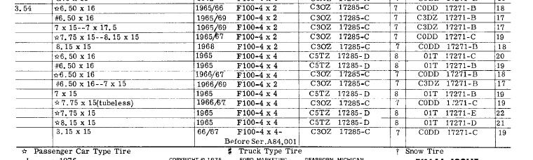

Yes, both 1965 and 1966 offered the Dana 60-2 limited slip in a 3.54 ratio. The T18 looks like it uses the same gears as the T98A.
Here's a partial list -
Tires, Year and Series, Drive Gear, Teeth, Driven Gear, Teeth.

Perfect so what I am reading I need a 17 or an 18 tooth gear. I based my tire size I am using now off the 6.50 16 tire dimension that it was originally ordered with. So I should be ok. Can you tell me what drive gear I have now? 1964 T98 trans 4 10 ratio it is all original drive train

Top of this list. Tough to tell which one, but probably 20 tooth.

CODD-17271-B .. 18T Nylon Speedometer DRIVEN Gear - 3.54-1 w/6.50-16 & 8.15-15 tires.
CODD-17271-C .. 19T Nylon Speedometer DRIVEN Gear - 3.54-1 w/7.75-15 tires.
Both are available from Ford & auto parts stores.
