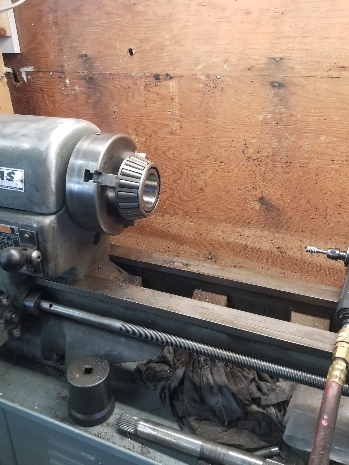

70 bucks for set bearing or 5 minutes on lathe with old bearing in decent shape?
