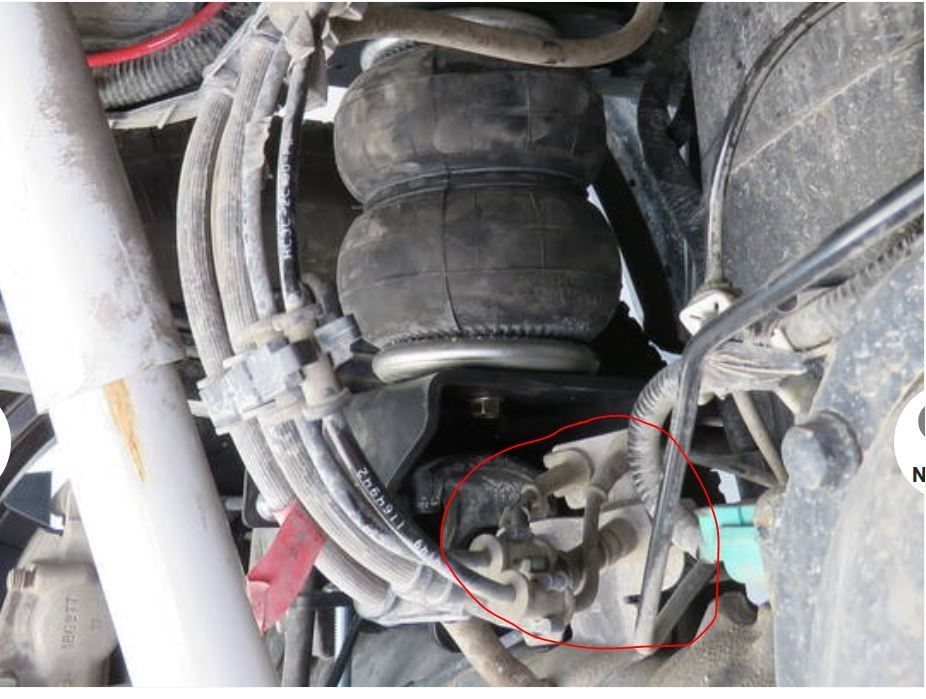

I just installed the PMF 1.5" tapered blocks with the Airbag tangs on my 2018 250 CCSWB. I have the FX4 with the Rear Locker and can tell you that these PMF brackets will not just bolt right up. The bag brackets had clearance issues with hitting the Brake line/ABS/Locker support brackets. Also the lower Bag support brackets clearance issues. I was able to cut the lower bag brackets shorter and modify the support brackets to work. I will load pics of my install in the net day or so when I get it back on my lift
The Link you posted with that Firestone kit will not work with the PMF lowing blocks either. I highly recommend the PMF lowering blocks and their airbag tangs(bag brackets) but be ready to cut and weld to fit correctly. Depending on your 5th wheel hitch frame brackets you will probably be better off going with the PMF brackets with Bumpstop tang and using the Air bag kit that mounts to the top of the leaf springs and side of the frame.
Brackets that the PMF mounts hit
