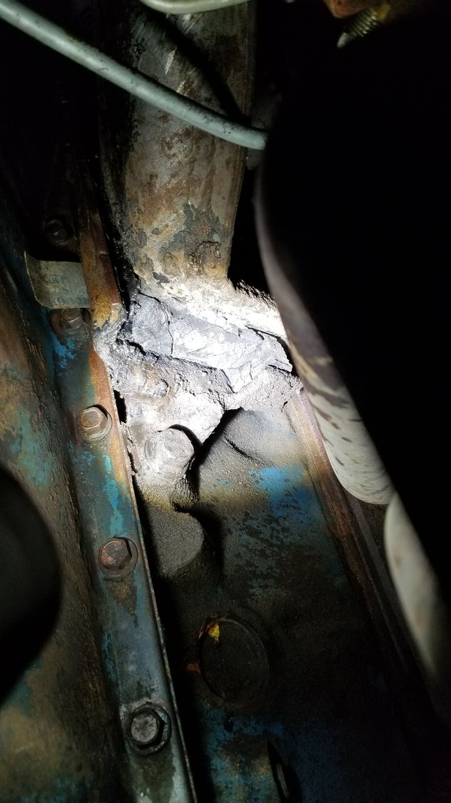

I wanted to see if I can identify the block and I came up with these numbers. How would I know if this is a FMX and is this something special?

he is asking if the 400 block he is looking at is one of the blocks that are drilled for a small-block trans...he isn't asking about a transmission...
the easiest way to tell is look at the back of the block...

There's never been a 400 that was anything special either.
But there were a few early ones that were dual pattern on the transmission mounting. if it isn't drilled for the large pattern you can do it yourself though it would be more of a PITA than it's worth in my opinion. just look at it and see.

That casting number is said to be the dual pattern block.

Appears to be the rare dual pattern block. Worth a few bucks to the right individual. these dual pattern blocks allow for the use of the AOD or AODE 4r70/75W behind them.
The FMX trans has the lowest parasitic loses of any of the Ford 3 Speeds and was very popular as a drag tranny back in the day unitl the rise of the lighter C4. The FMX and could be built to take some big power numbers. The FMX was the foundation for the AOD and it's sucsessors Any one that knows about Ford tranny's does not malign the FMX But today there are cheaper lighter options available with better parts avaibilty. The FMX today still has some use especially if you looking for a low parasitic loss Ford 3 speed than can the power of a V8
