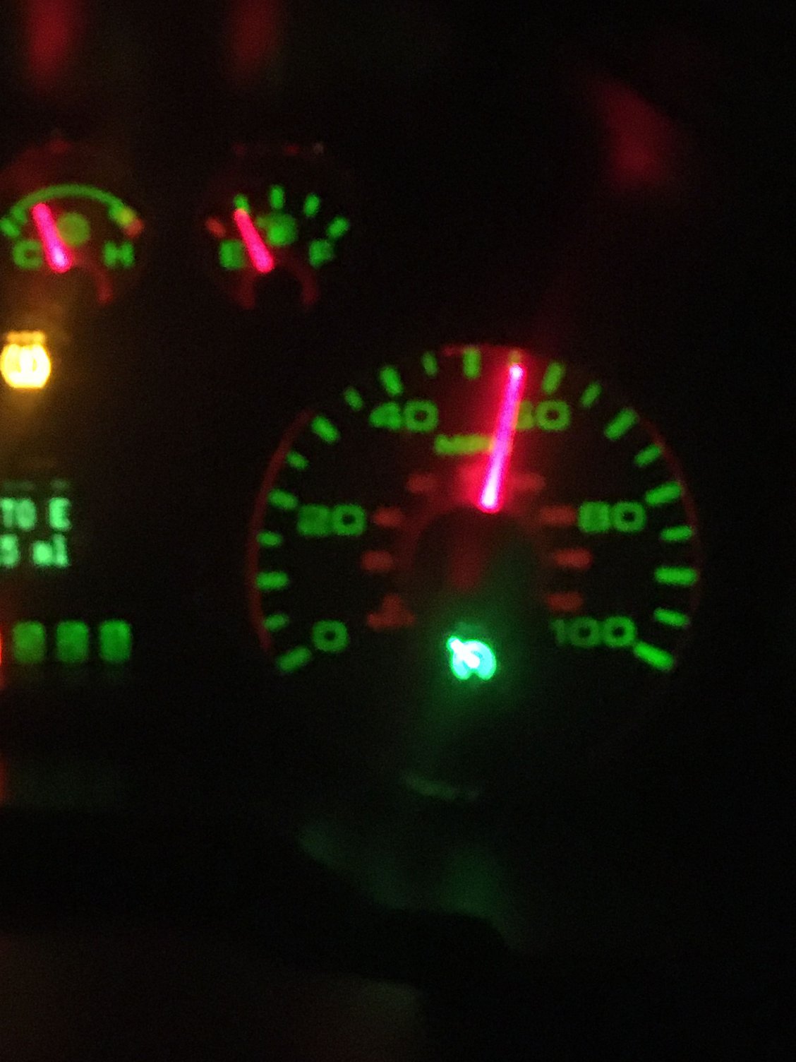

Well after a few beers I was less pissed and got back at it. Ended up un-pinning the connector and soldering a length of wire onto the pins to give a bit of wire to play with. Undid the harness the broken off wires were in and snaked em into the fender well to solder to the new wires.
Kind of a redneck fix but it works! Glad to have cruise back
