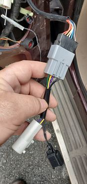

Its for the heat. I am having the same issue, can't get the flasher to work.
They make an adapter you can get but I still can't get the blinker to work.

According to the picture you posted you don't have the turn signal wires in the adapter. I see the 3 for the power mirror and then 2 more for the heat.

My Mirrors claim to support heat, but the adapter did not have the heat plug on it, looks like i may need to find a new adapter.
At this point i have half a mind to just splice the heater wires to the turn signal wires and let them just be always on LED marker lights, simpler than running a turn signal wire, and at least then they are doing something.
Yeah thats my problem. I can't find the proper adapter.
I know with wire on the truck harness controls the blinker but
I can't get it to work on the new mirror,
