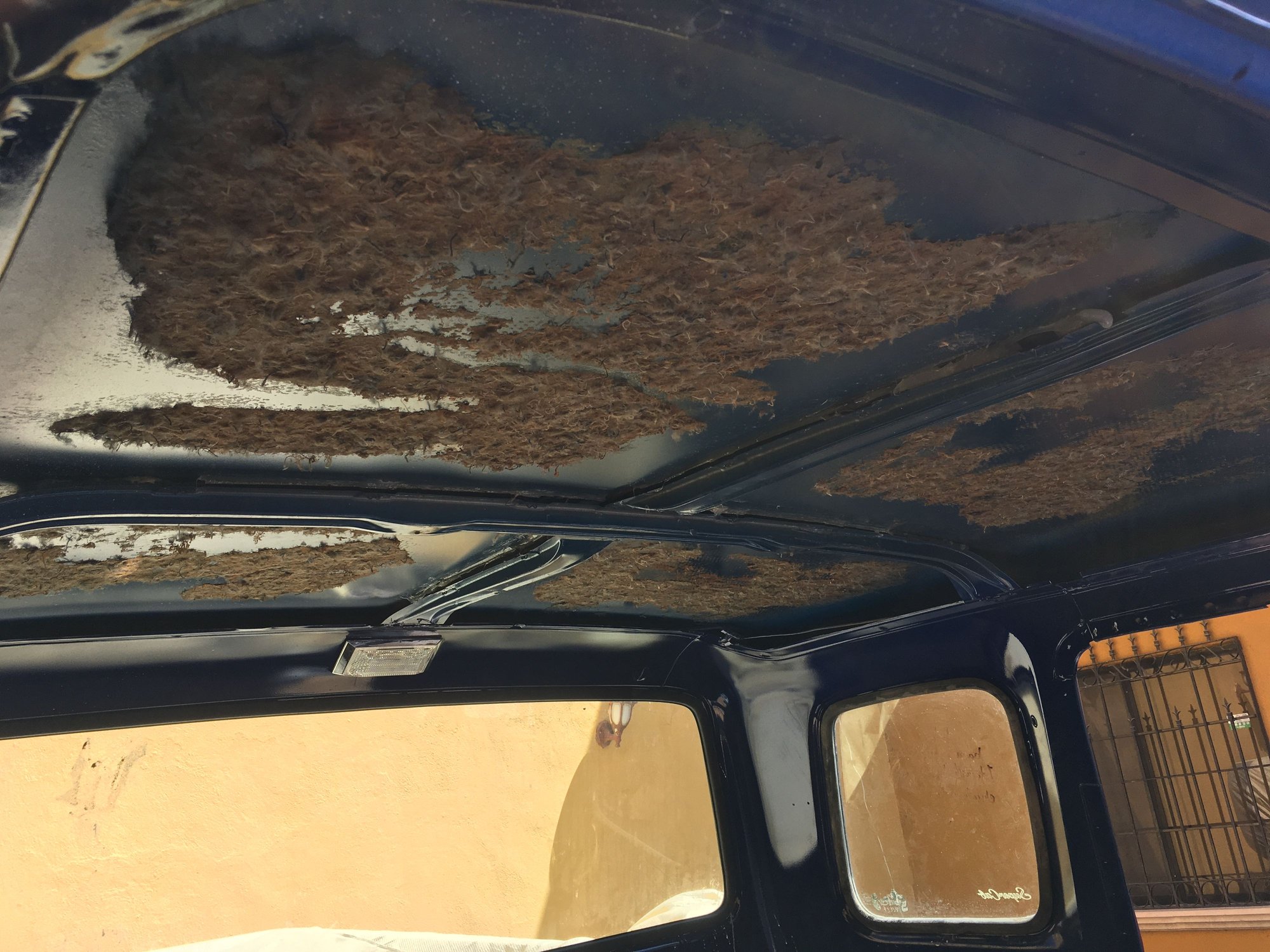

Hello, I have a Ford Ranger XLT Supercab 78 I tried to replace the headliner but now i have an issue, someone know how to stick the roof reinforcement again, since the steel cross from the ceiling came off, I tried to put silicone but with the movement it takes off again. Beetween ceiling and the cross there are like a plates of glue, but i don´t know exactly is.

Looks like the bow (support) is bent. You might have to take it out, hammer out the kinks and get it back into the bowed shape again.
I would think that bow is supporting the roof and not the other way around..... If you glue (somehow) that bow to the roof, the roof might sag down to meet it...

It all should bow up starting on the outer edges. And then get and use some newer automotive body panel adhesive. Stop by you local auto body shop and ask them what is the best to use. You never know, they might have 1/2 a tube already opened and you never know how that might wind up in your hand.

I haven't seen one in years but I thought it was just a pad of the type of tar paper felt that was stapled on top of the supports. Not exactly bonded to it, just a type of support.

I'll give my 2 cents.
I agree that it looks like it is sagging in the middle.
Check the outer contour of the roof to see if it is good.
I would be afraid of wrecking the whole assembly getting it out and back in.
I think you've got 2 options
  1. Use a Jack and a post/2x4 and slowly push it back up. It probably won't stay, and honestly I wouldn't try it. But you never know.
  2. If outer contour is good, just glue in some strips of plywood or such as shims.

There should be a gap between the brace and the skin of the roof. They are not designed to have a tight fit. You want to roof to be able to expand when it gets hot, shrink when it get cold. ( yes just like your do-hickey does) You want to put a seam sealer that will stay flexible to allow this movement. Same kind of stuff used between a hood skin and the hood bracing. Your Auto Paint supplier will have what you need.

A few things.........one, unless someone has been jumping on the roof of the truck, those braces are NOT bent. So, please do not take a jack and force them up where they're not supposed to be. As others have stated, there is supposed to be a gap, with flexible seam sealer between, to allow for the natural contraction and expansion of the sheet metal. As for the headliner itself, sagging is a natural occurrence with the introduction of moisture over time. These liners were originally made of some sort of pressboard material, and they will absorb moisture eventually and deform. If I recall, the headliner material can also be perforated, and non-perforated from the factory.........regardless, they all will eventually sag with enough ambient humidity. Now, to get the liner out, you remove the support screws just left and right of center (the holes are on the lateral support brace). Next, you remove the trim pieces (do NOT bend them.....as you'll have very little luck replacing them). Once the trim pieces are out, you can carefully maneuver the liner out the door of the truck........but, in my particular case, there were no seats in the truck yet, so it gave me room to move.
