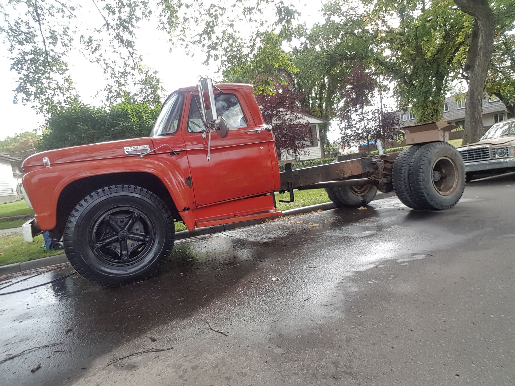

I have a 63 mercury 3 ton. I've been trying to find a vin decoder to decode my vin but have been having no luck. This is the plate on the truck. Can anyone help?

Threads merged. The further decode won't necessarily help you with brake parts. Do you have that brake apart? If so, what is the inside diameter of the drum and the width of the shoes? With that info, and the year and model, you should be able to find those parts through NAPA and other sources.
Also, see post 2. You thought this was a '63 Mercury? Does the VIN on that tag match the title?

as for the year I could be very wrong. the gentlemen I got the truck from said in his add it was a 63. I've had no luck trying to find this body style for 63. Its been 64 and up.
from what I can tell you is it's a 5 spd with a 2 spd rear end. The splitter is electric. It's got power brakes, manual steering.
would you mind trying to do it as a 66?

The FE engine is a car and light truck engine introduced in '58. The FT is a truck version intro'd in '64, The distributor in front and the appearance as a '64 or newer would point to the door tag being correct. Do you have a title for it?
1961/66 F500 and larger series trucks look pretty much the same except for the specific year grilles, placement of the parking lamps and certain emblems.
1961/64 parking lamps are within the grille, 1965/66 parking lamps are located in the upper grille panel. 1961/62 use different hood side emblems than 1963/66.
1965/66 front hood ornament w/a V8 is different than 1961/64, 1965/66 with an I-6.
I'll decode the '66 info...
Old Sep 13, 2020 | 11:54 PM
NumberDummy's Avatar
NumberDummy
Ford Parts Specialist
Posts: 88,826
Likes: 787
From: Simi Valley, CA
Was wondering if I can get help deciding the vin on my truck.
Also if possible, need part number for front passenger side wheel cylinder.
F70 = F700 (gas).
D = 330 2V Heavy Duty FT (Ford Truck) engine.
C = Oakville Ontario Canada Truck Assembly Plant.
805160 = 1966.
174" Wheelbase.
J = Rangoon Red.
F702 = F700 (gas), 23000 lbs. GVWR
M81: M = Medium Beige Crush Vinyl & Medium Beige Cody Pattern Woven Plastic // 81 = 81A Standard Cab.
N = Clark model 2622-V 5 Speed Manual Transmission.
G3L:
G3 = Eaton model 16802 Two Speed Rear Axle / 6.50/9.04 / 17,000 lbs. Rear Axle Capacity.
L = Ford-Rockwell/Timken 6,000 lbs. Capacity Front Axle with Heavy Duty Kelsey Hayes Front Brakes.
23,000 lbs. Gross Vehicle Weight Rating.
164 net HP @ 3,800 RPM
A64202:
A6 = FoMoCo of Canada Ltd. Western Ford Division, where the original selling dealer ordered the truck from.
4202 = Domestic Special Order number, truck ordered special by the original purchaser, not "bought off the lot."
C4TZ-2061-B .. Right Front 1 1/16" diameter Wheel Cylinder with 15" x 3" Kelsey Hayes H/D front brakes and 6,000 lbs. front axle capacity / Obsolete
RPN PARTS in Erie PA has 1 = 888-864-9305.
MCDONALD OBSOLETE PARTS in Rockport IN has 1 = 812-359-4965.
PARTS HOUSE CLEARANCE in Oroville WA has 2 = 250-878-3498.
Also try NAPA
