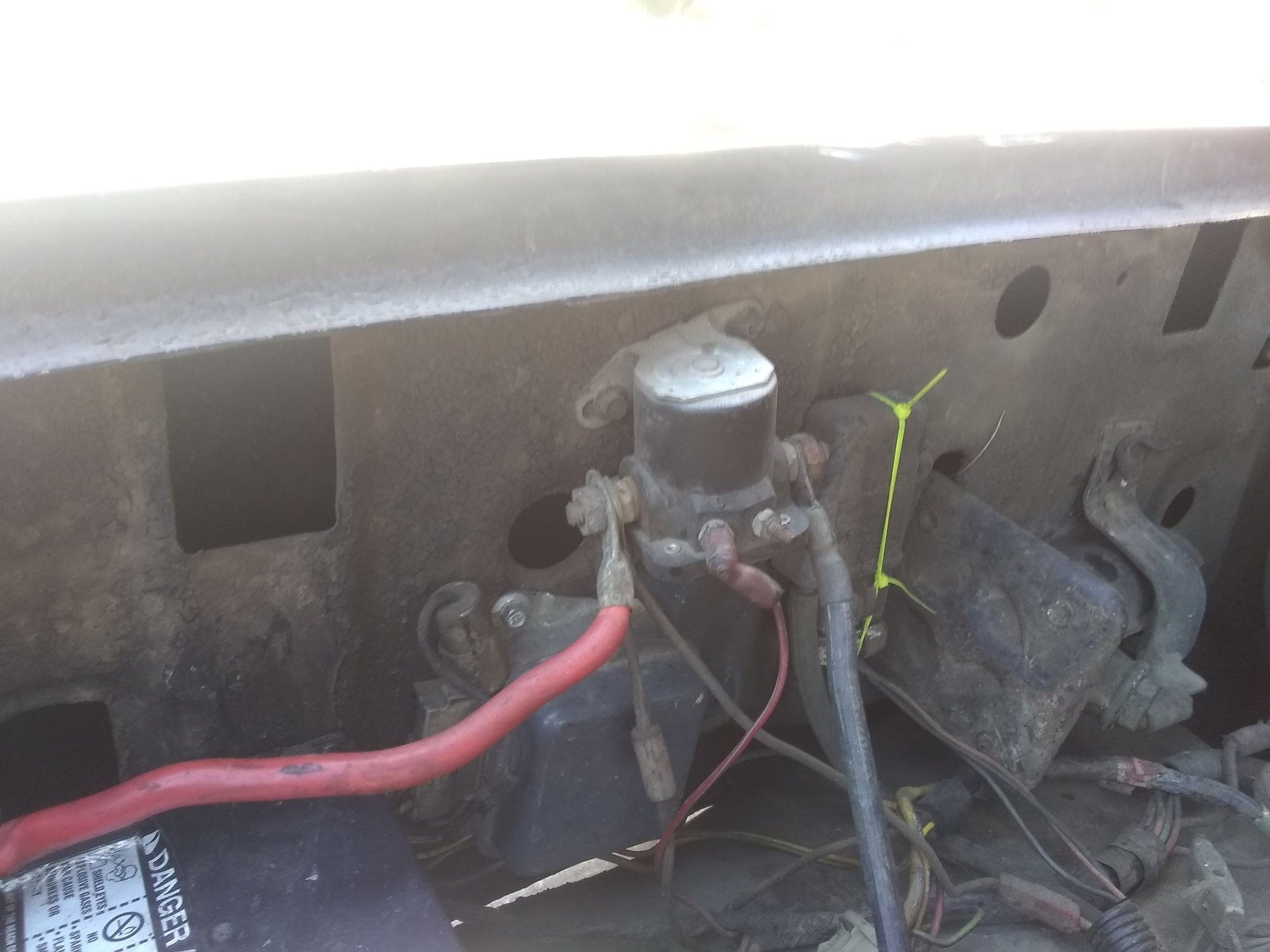

Here's some pics of my distributor and coil is do I have the DS2 already?

No, you have the TFI. See the grey rectangle on the distributor body? That is your TFI module that takes commands from the computer to time the engine.

Will all that still work with a newer model 4.9 until I can afford to change it all over?

It should work just as good or bad as it does now when moved to the new motor.
I wonder if the dist in the new motor is also a TFI and your wires will plug into it?
I say this because I think you say the new motor was EFI and a computer would also control timing on that motor also.
