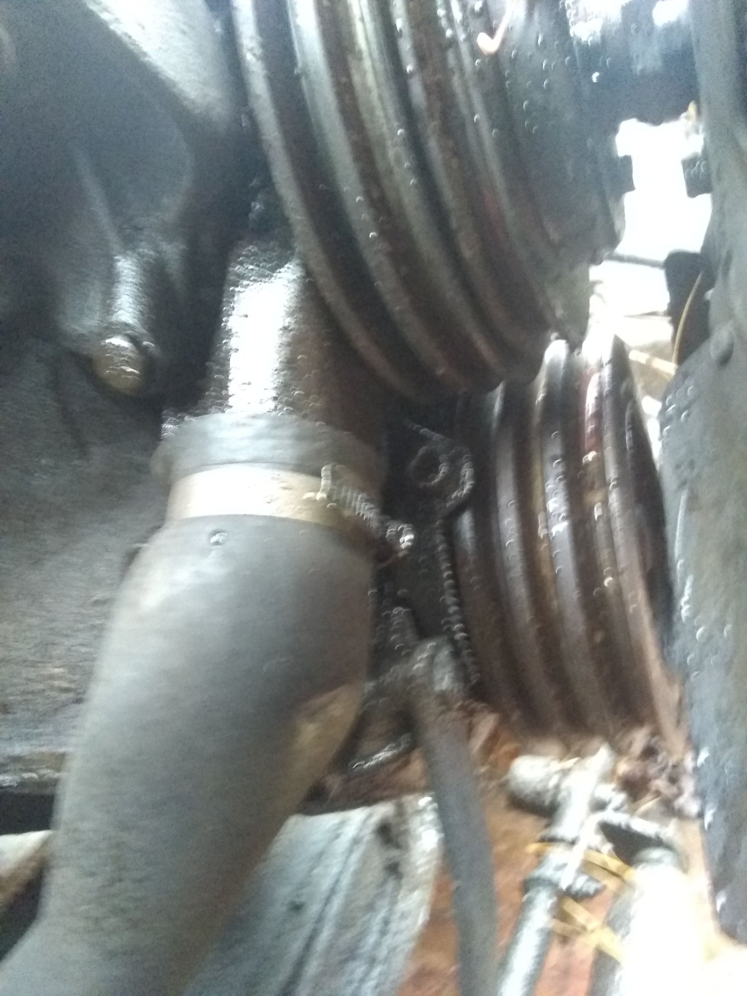

Ok good new problem I apparently didn't get enough pics from when I disconnected everything and I'm having problems figuring out what wires hook up to the back of the alternator. I also have some questions about whether or not the new motor I got is air in
This is what I think is the air in head. Mine didn't have this pipe
head because it's got a rail that runs across the top that I'm not sure what it is cuz my old motor didn't have it

That pipe is just smog stuff. If you don't have a smog pump and don't have underhood inspections, you don't have to hook that up.
So then do I need to plug it off cuz I'm wanting to bypass my smog pump
