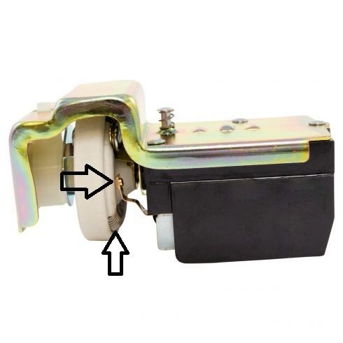

The switch has a copper arm that contacts the coiled spring when you turn the **** to the left. I had intermittent dome/cargo lights and when I took out the switch there was an ever so slight gap between the two but when driving the vibration was just enough to make contact every once in awhile. I bent the contact back into place and it fixed the problem.

Old Sep 19, 2020 | 08:11 PM
