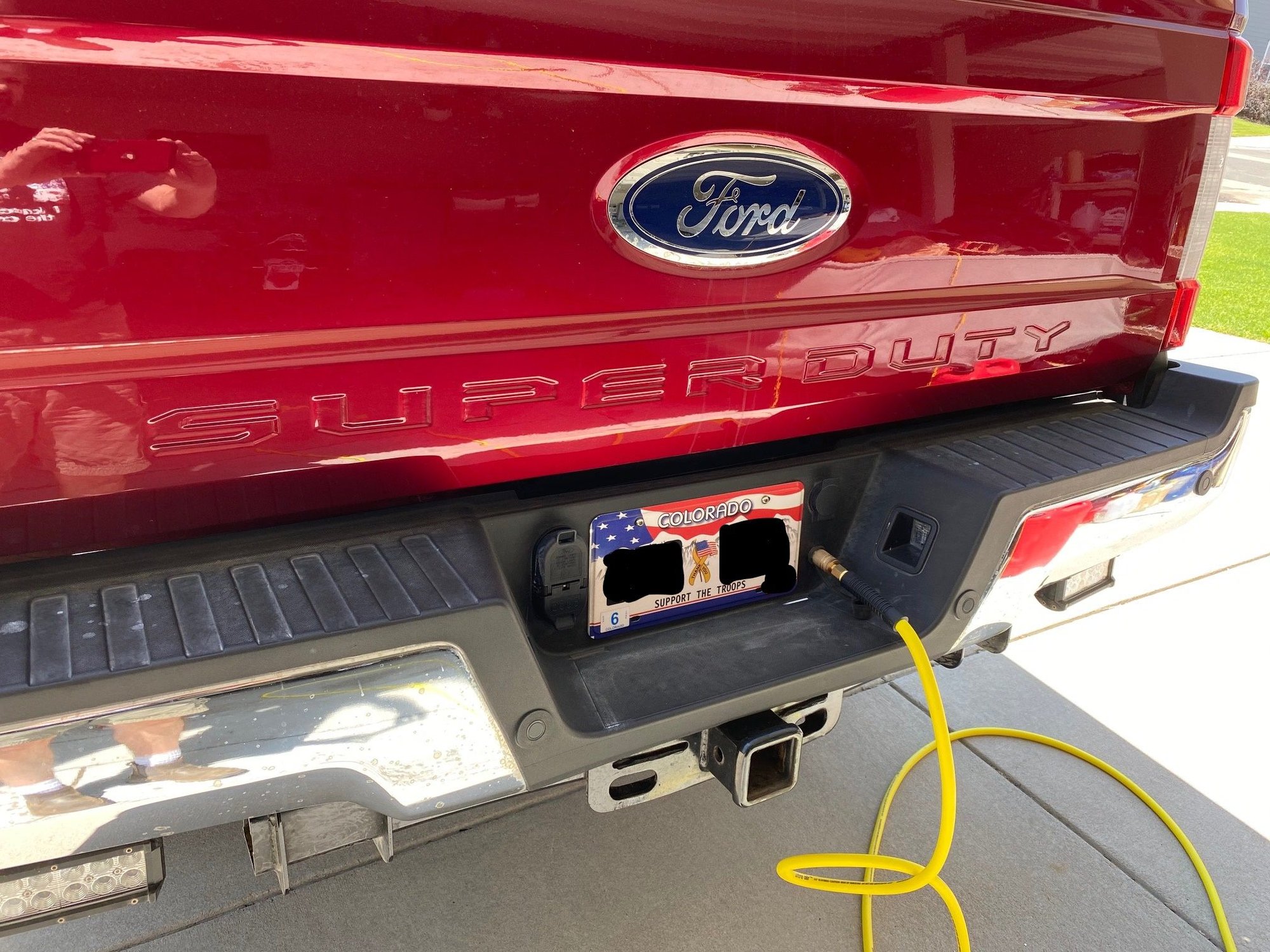

If you want to do anything with that air, then you should consider a tank with the compressor. As mentioned Viair makes well regarded kits. Viair 10007 is a common kit, as it has 2.5 gal tank and a 100% duty cycle compressor. It's around $350, give or take. Throw in another $50 - $100 for mounting plates, hardware, etc. Lots of threads here and at various F-150 forums on where to mount these things.
I went with a Kleinn system, which is similar. 100% duty cycle compressor and 3 gallon tank ... all mounted neatly around my spare tire. Everything is out of sight and I keep my spare tire.

Thanks for mentioning this system. I upgraded the Viar system in my 06 LBZ some years ago with the 3 gallon tank from amazon. Had to custom weld brackets and what not. This Kleinn set up looks great with the brackets and mounting locations.
I'll be adding a S&B 60 gallon tank to my truck so clearance is a big concern. Looks like the Kleinn kit won't interfere at all.
Does the pump mount get in the way of the spare tire? I'll be stuffing a 35 or deflated 37 in there.
