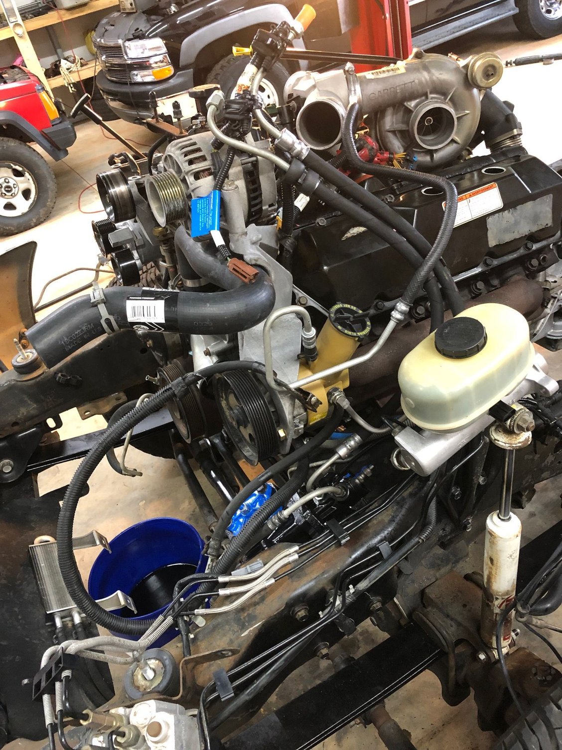

I been happy with my blue top so far, havent put many miles on it (maybe 12k) but no leaks, nice and tight and a little "firmer" feel

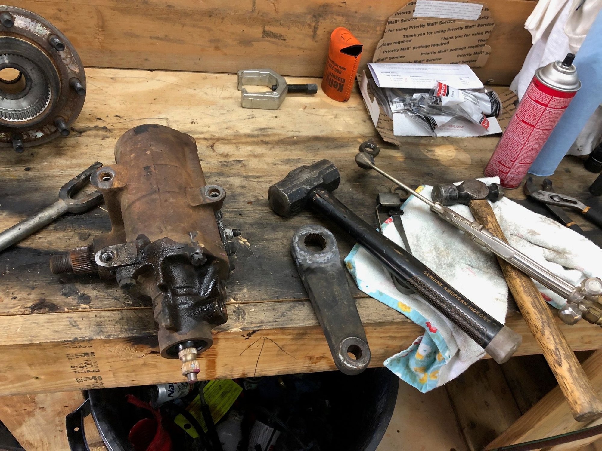

i forgot to mention blue top refunded my core quickly, within a couple of days
I put a motorcraft steering box on neighbors truck a couple weeks back, and removed the inner fender, i would highly recommend taking the 10 mins to do this for ease of access.
