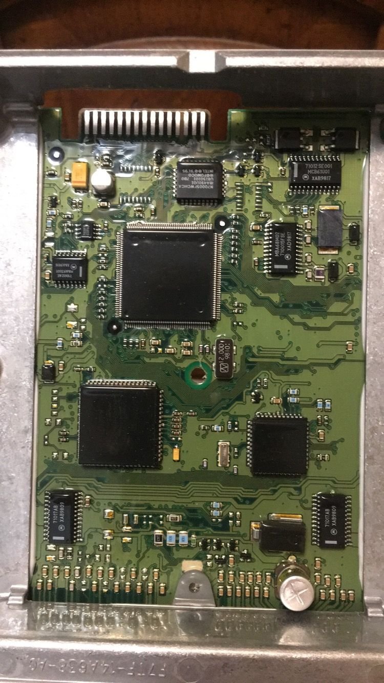

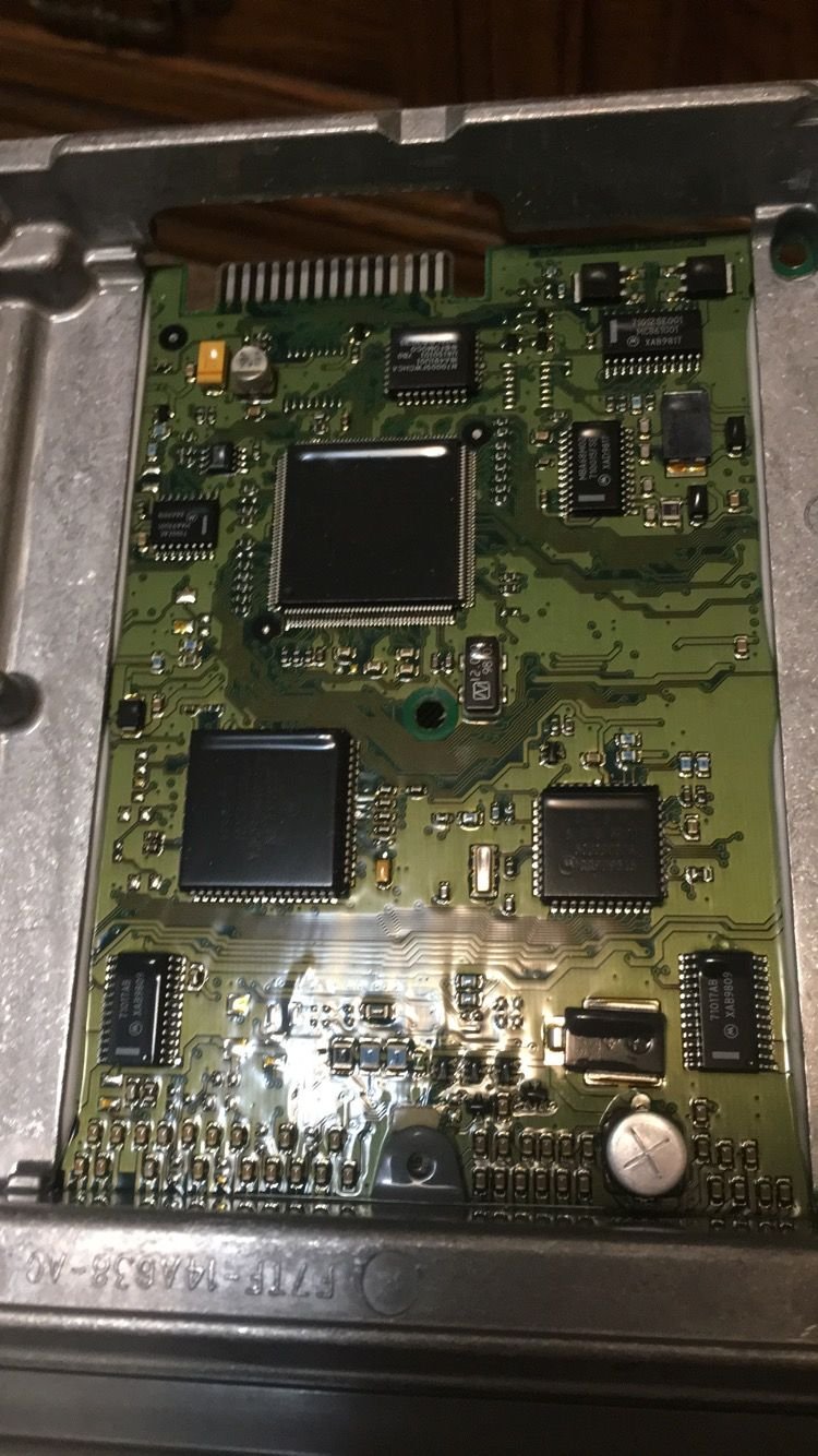

Can anybody see any visual issues with my pcm? I was hoping I’d pull it and see something burnt or maybe some corrosion but my untrained eyes can’t see anything. The case was wet when I pulled it out (windshield leaks) but didn’t seem wet on the inside. The only thing I could see was the bubbly look in the last photo but like I said I don’t know what I’m looking at 🤣
