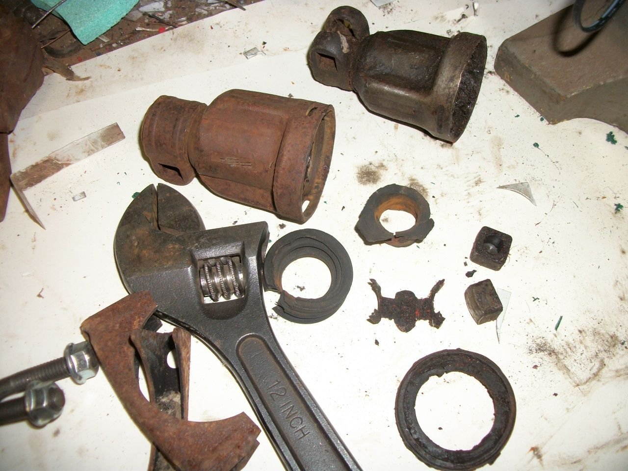

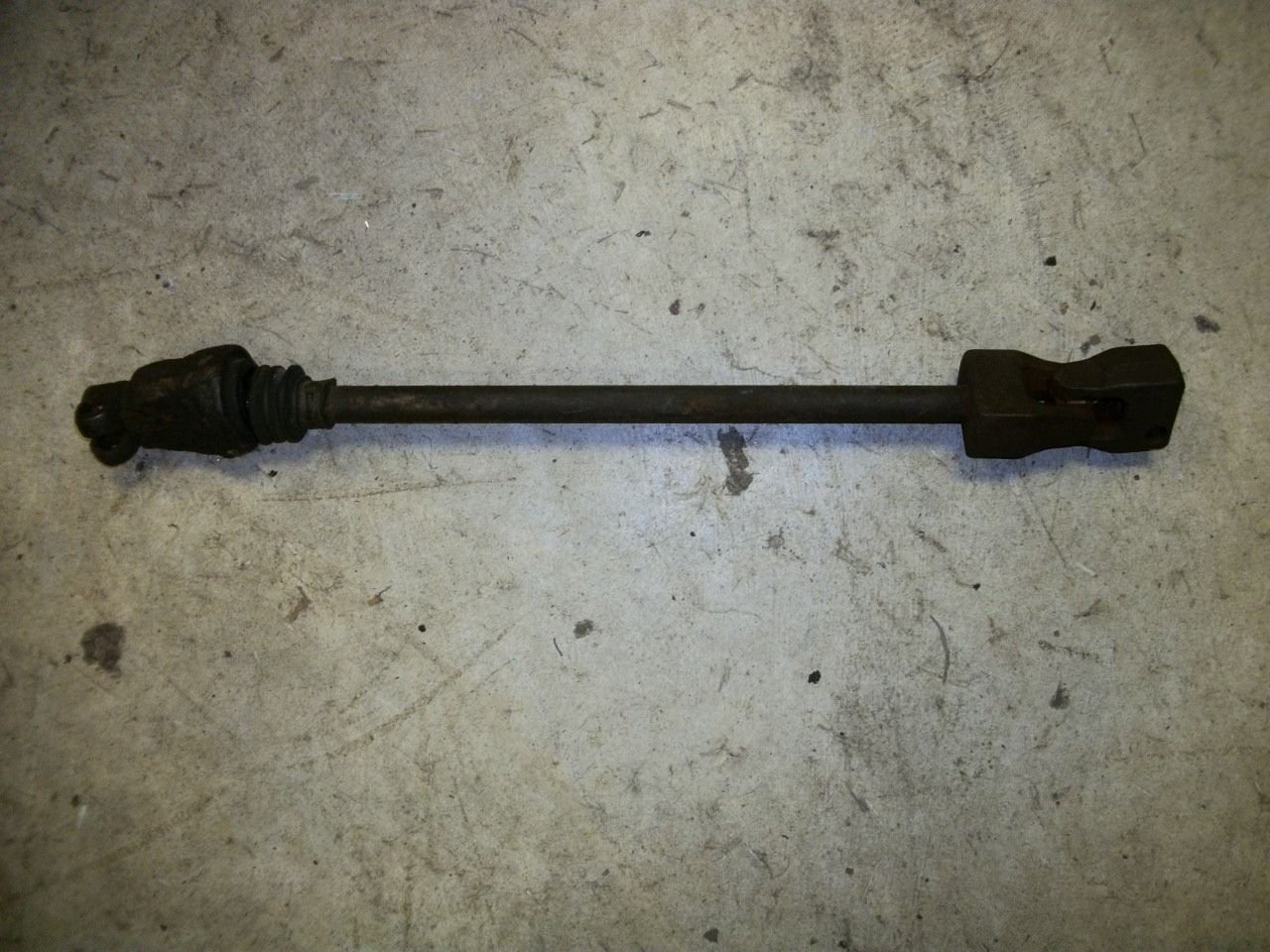

Yes the PDF is for a 73-75, but the diagram shows the steering gear box/steering shaft (bell) and all upstream connections points. You do NOT have a RAG/flex joint in the set up. And yes your out put on the 78 box is out the bottom.
"Bell" 3B676 is second pic.
A new Borgeson steering shaft will replace ALL that. https://www.borgeson.com/xcart/produ...&cat=46&page=1
With damper: https://www.borgeson.com/xcart/produ...&cat=46&page=1

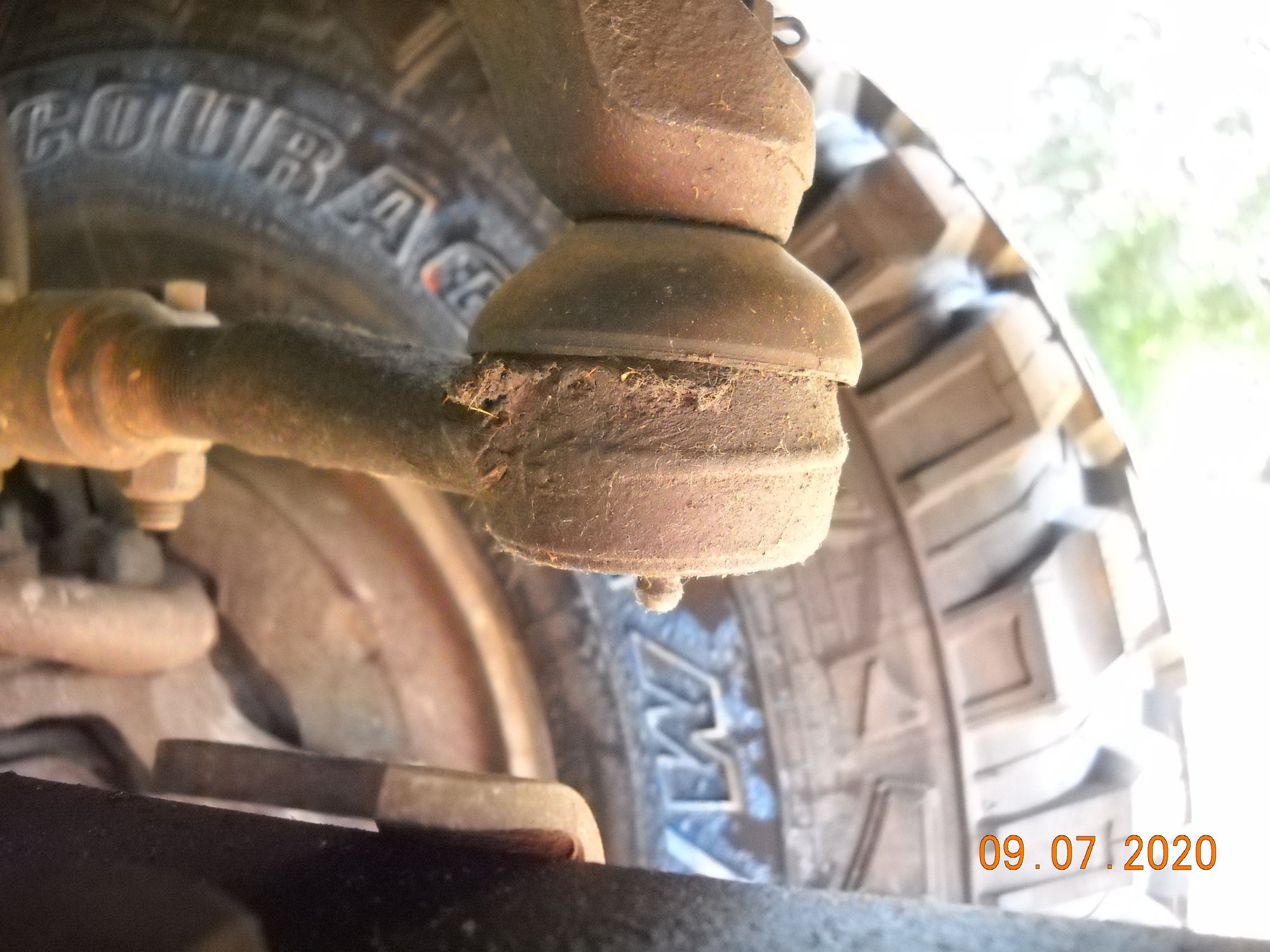

Did some looking around at the beast and found a couple things that concern me. I will try (again) to get the pictures loaded. They are of the steering arm, steering damper and where the arm attaches to the gearbox. Please have a look and tell me what you think.
I will have someone do a back and forth with the steering while I look around later today or tomorrow. No one around right now.

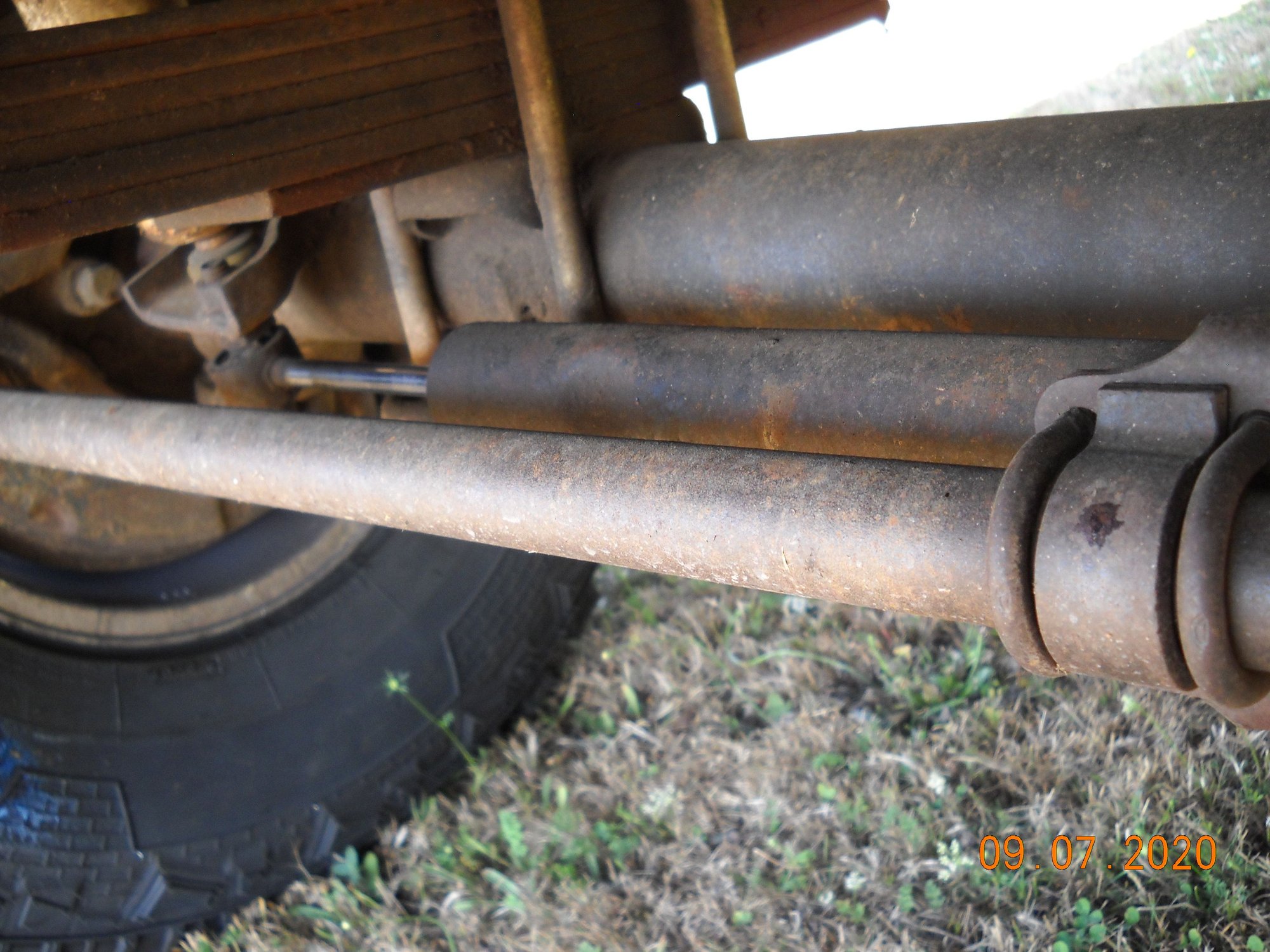

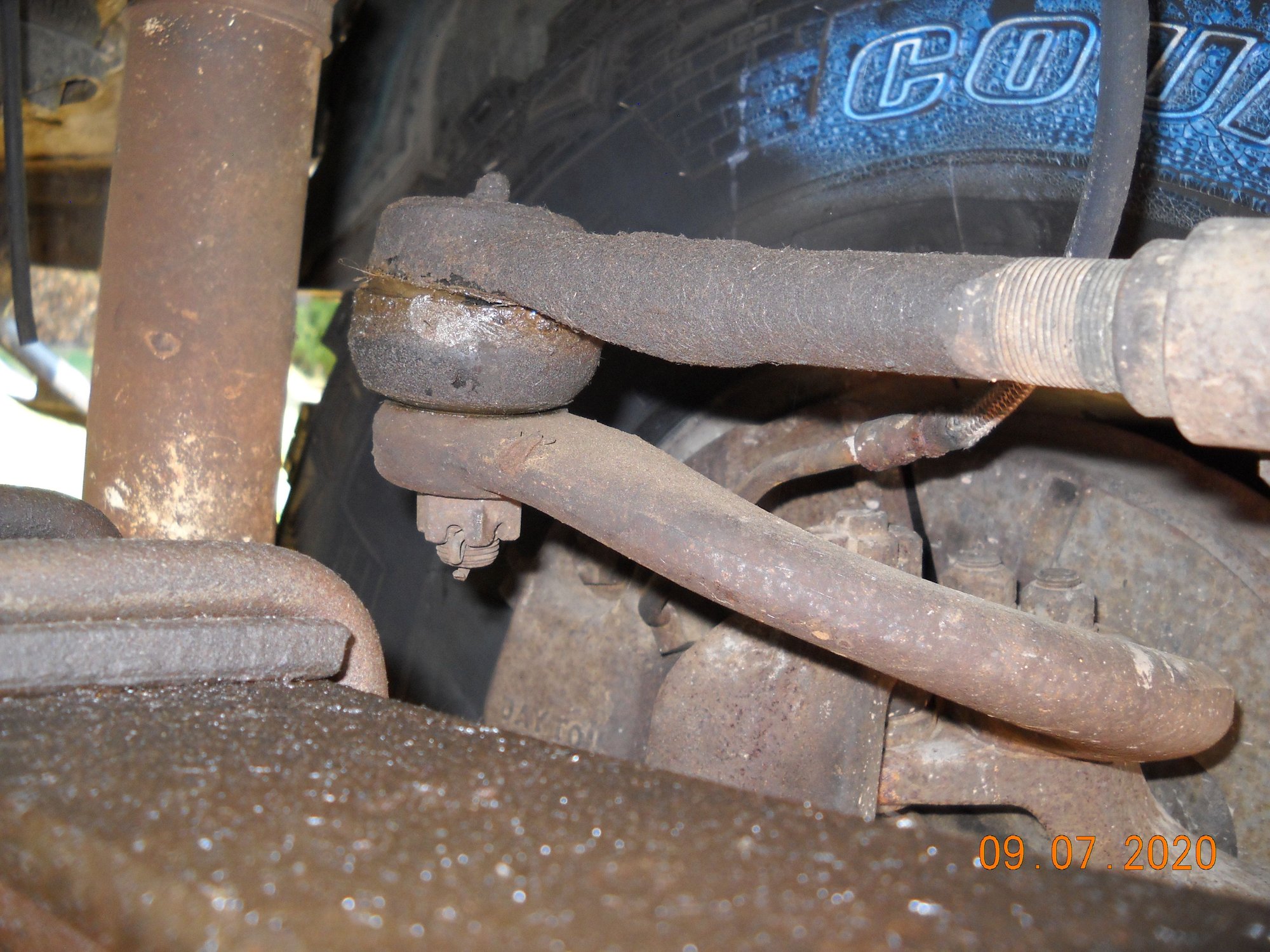

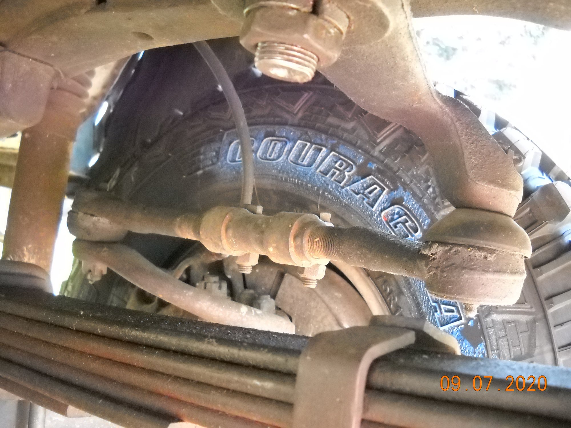

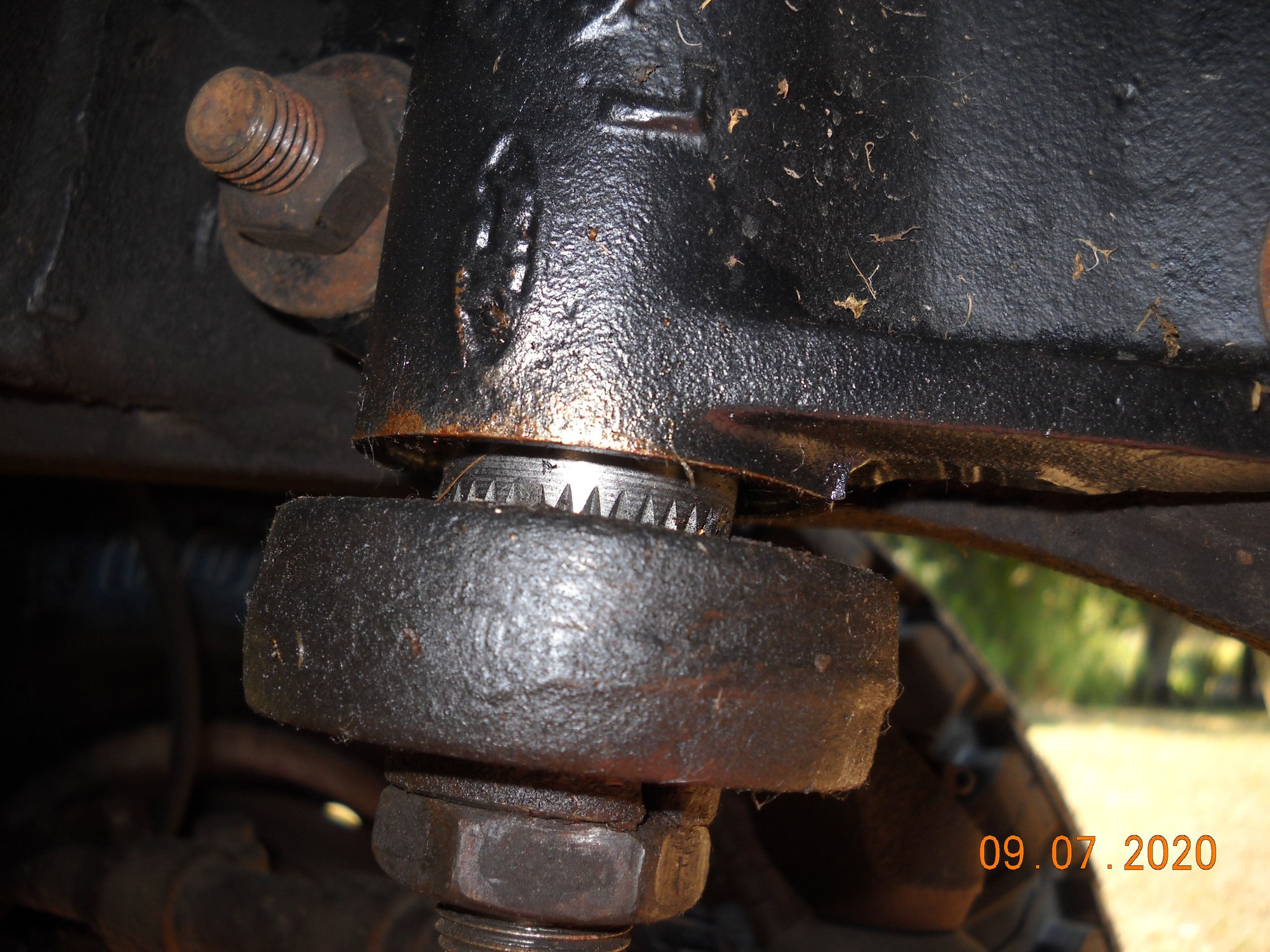

The pic with no label is where the steering arm attaches below the gearbox. It doesn't look right to me. I can take more pictures if you need them
Thanks!
arm end
Steering damper end. obviously this needs to be addressed!
Steering arms
Just cuz it's nice to look at. My grandson decorated it with mug handprints *grin*
Steering damper
steering arm end
Old Sep 7, 2020 | 04:29 PM
77&79F250's Avatar
77&79F250
Moderator & parts slinger
Posts: 50,146
Likes: 5,782
That is why I suggested to check out your state FTE chapter forum and see it you might recruit a helping hand. You know how the stuff works and they can physically do it so. Maybe link up and buddy with some FTE members and work out a maint plan to keep your truck out of that shop.
1st pic. Bottom end of the pitman arm to adjustable link, look ok, just dry from NO grease. Can you grab it and do the tie rod twist ck? Tight?
2nd pic common steering stabilizer, worn rubber end bushing, just need a shock absorber ring end rubber bushing.
3rd pic is steering box output shaft (spud shaft) and the pitman arm connection. Looks seated, lock washer and nut and some threads showing. Good.
4th pic Adjustable steering link looks ok the other end is like the front one dry of grease, get a hand on it give it a twist.
5th pic AWESOME paint pattern by the grandson.
6th pic same steering stabilizer worn bushing.
7th pic a better shot of the far end of the adjustable steering link and its connection point to the steering knuckle arm. Looks wet, how does it feel? Twist ck.
