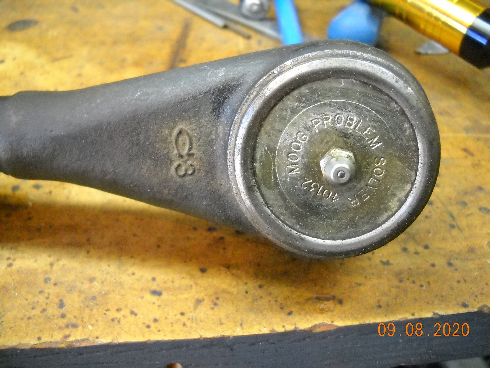

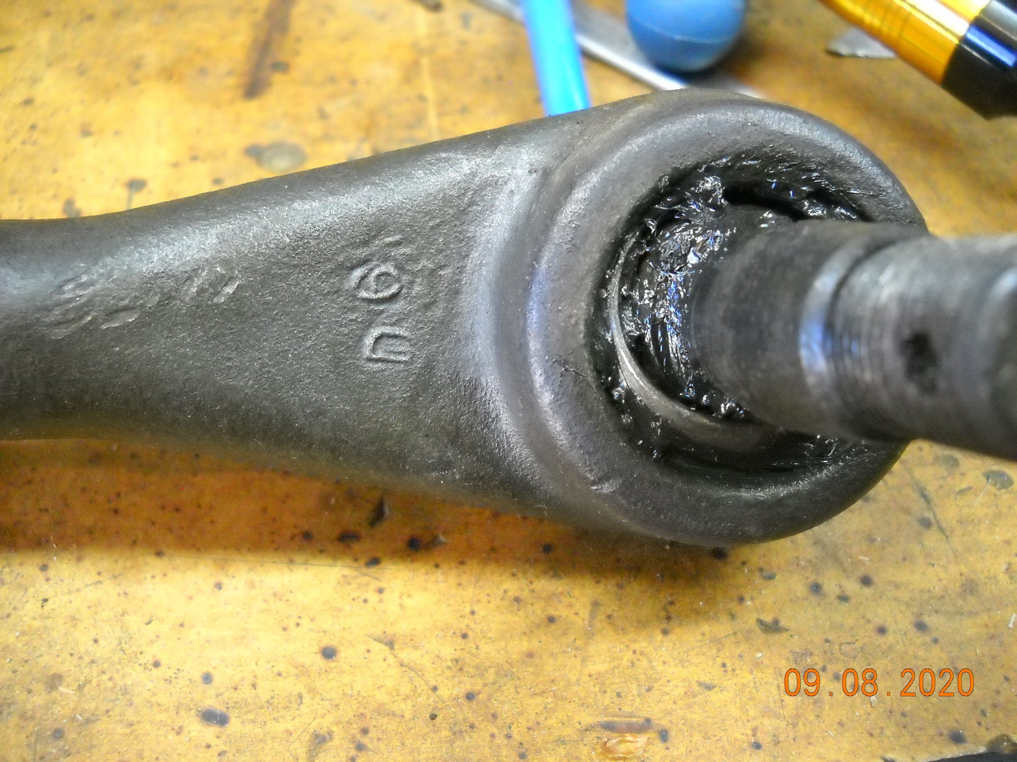

The better end, AKA The front red arrow thingy

Yea ok so you have a worn steering arm end. Get a new one and replace it, count the # of threads it take to remove the end link, (thread it out of the sleeve) and then same count to reinstall. Still can't locate the torque. 440sixpack you got any info in the dept for them?

Got the new tie rod end today (or is it a drag link? I've seen both names used (I think) Another Moog. I also picked up a new steering stabilizer while I was there.
Found out the torque specs : 50-60 ft lbs

Okay, I just got back from a second test drive, this time on the highway, and the steering is nice and tight again! Replacing that one bad tie rod end definitely did the trick. Perhaps the fact that the truck has a 6 inch lift, and 35" tires excerbated everything... I wouldn't have thought that 1/8 movement in the tie rod end would equal 4-5 inches of play at the steering wheel, but that seems to be the case. The only other thing we did was replace the steering stabilizer.
