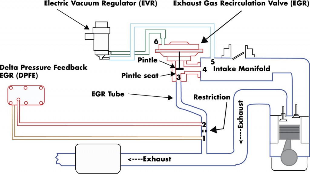

That fuel pressure is high then it should be 32-35psi at idle. Check that there is vacuum on the line at the regulator, if there isn't install a new vacuum line from the vacuum tree to the regulator.
The type of EGR system on this truck cannot be deleted or disabled without setting a bunch of codes and a check engine light, so don't start unplugging things it will just make things worse.
The lean codes could be caused by a problem with the EGR, there should not be any vacuum on the line at the valve at idle, if there is then the control solenoid is malfunctioning. Here is a diagram of how that system works, the PCM regulates the exhaust gas flow into the motor via the EVR based on operating conditions and feedback from the DPFE sensor, and when working properly the systems operation should be transparent.. meaning it should not have any negative effects on engine operation.
