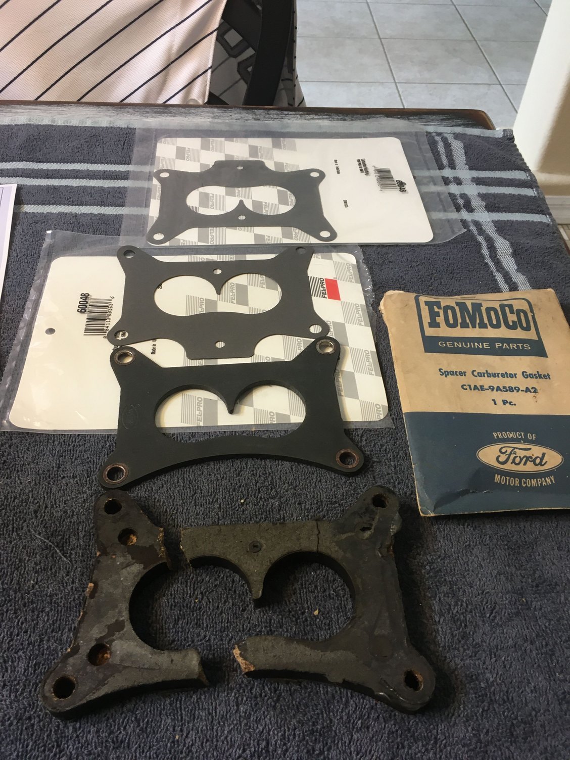

The spacer plate might be something like this one, but tough to say for 100% sure. Sometimes they help with clearance issues and they can also help prevent boiling the fuel in the float bowl and passages because it provides a bit of a heat buffer between carb and manifold.
https://www.ebay.com/itm/Ford-2-bbl-...UAAOSwbWpeojSH
the spacer plate I have is 1/2 inch, I’m not sure 1/4 inch will be enuff.
it broke because it was “glued” to the manifold with gasket material. I have a suspicion is was already broke
Yeah, that's not the thickness you probably want. I hadn't noticed that third picture. I'll let you shop but you get the idea for sure.

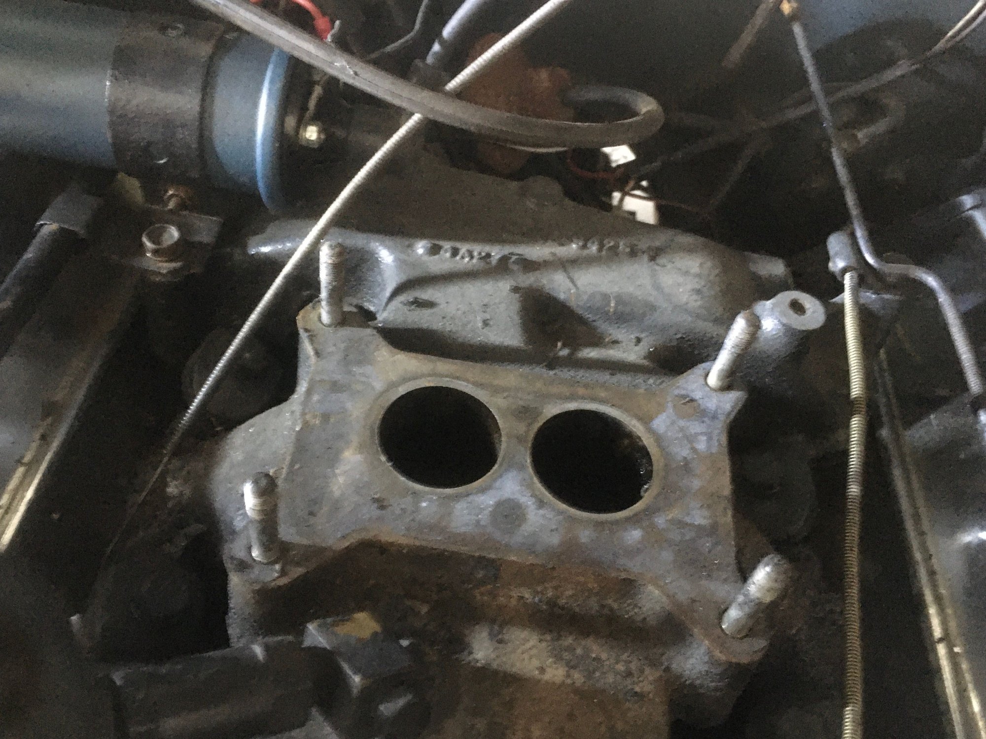

I’m having no luck finding a spacer, I’ve been searching eBay and there’s a lot of 289 2bbl spacers. Do you think this will work?
here is a pic again of my manifold

Napa has a selection of phenolic and aluminum spacers.

The 2100 style is sort of hard to find, don't know why. A bazillion 4 bbl aluminum jobs are a available. Be careful, the wrong spacer or carb from later years will leave a huge gaping void that no gasket will seal.
There was a guy on eBay offering them, complete with studs and hardware. Worse comes to worse, just make one. Trace it out with a gasket on a piece of 1/2" or 1" wood, get yer Barlow out and get to whittlin'. Wood makes an excellent insulator.

here is where I’m at. I went to Napa, let me say, I find the people there are knowledgeable and are on top of there game. I walked in and put the broken spacer down and instantly they said, sorry, that’s not obtainable, but! Look online for what you have and gave me a part number. My spacer is 1/2 inch, I found an n o s 1/4 inch spacer on eBay. It also should be noted they new the gasket I needed and explained why. Very helpful.
i went home, put a 1/4 inch piece of wood on the manifold and placed the carb on top, no issues with linkage. That left me with a carb leaking from the accelerator pump and power valve. Knowing my limitations, I packed it up and sent it to national carburetor in Jacksonville Fl. They will disassemble, rebuild, set all settings, and most important, run it to assure no leaks. I’ve used them before with no issues.

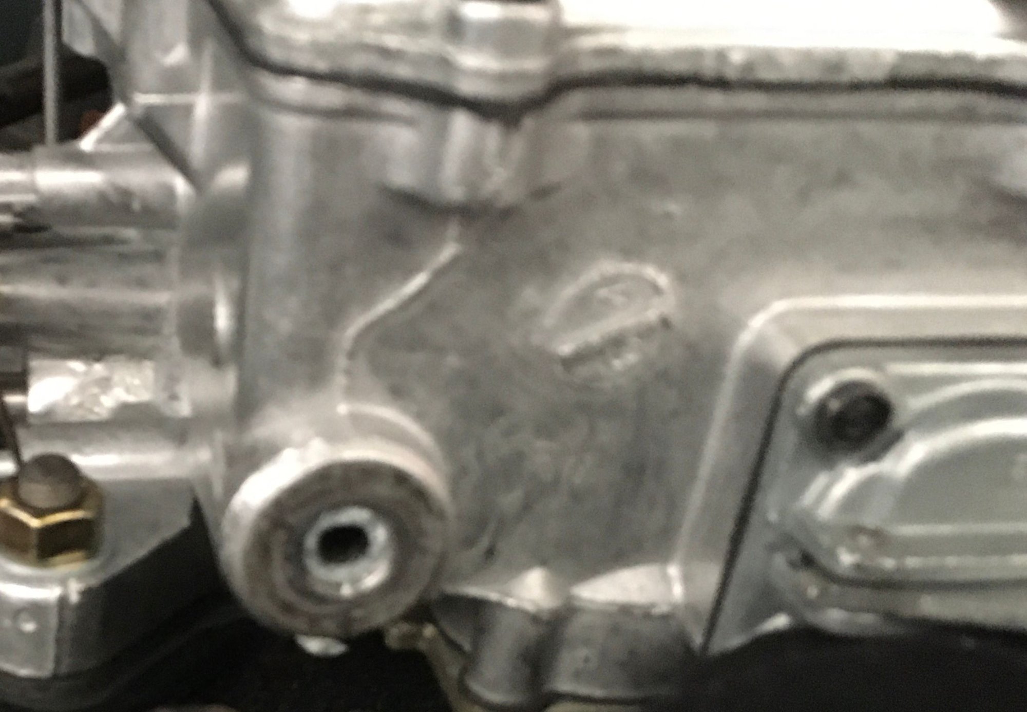

They did a complete rebuild, cleaned it, ran it on an engine. I had It back in my hands in 8 days. There business platform is, just send it in, we will rebuild/repair etc, what ever It needs, one set price, no phone calls, it needs this or that for more money. Best of all, it looks nice, no leaks, and the truck runs amazing! I, a little heavy handed, snapped the fuel filter in the carb. I called them and they instructed me how to fix it.. pic included.
Definetly recommend them. I also found the correct spacer on eBay, it was thick enuff, no linkage binding. This project is done!
