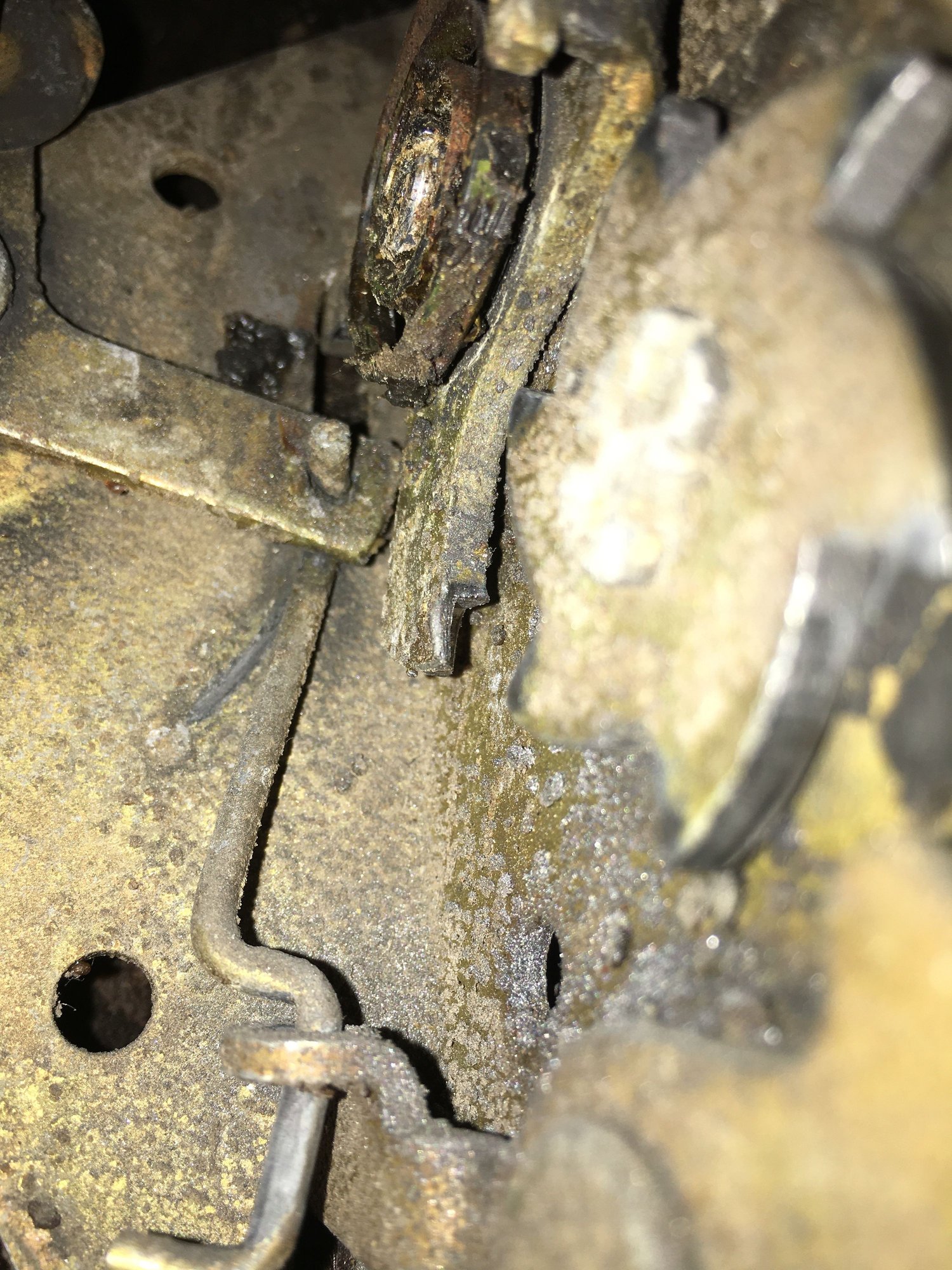

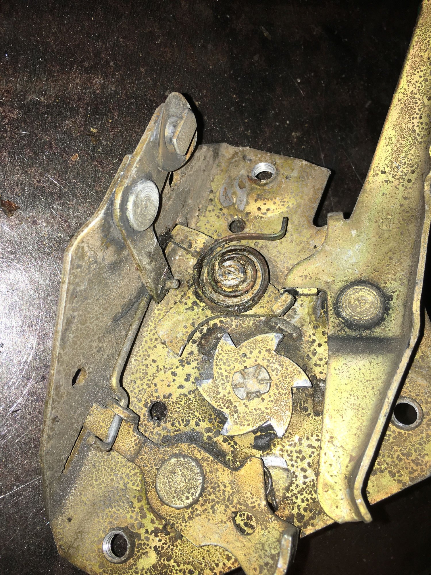

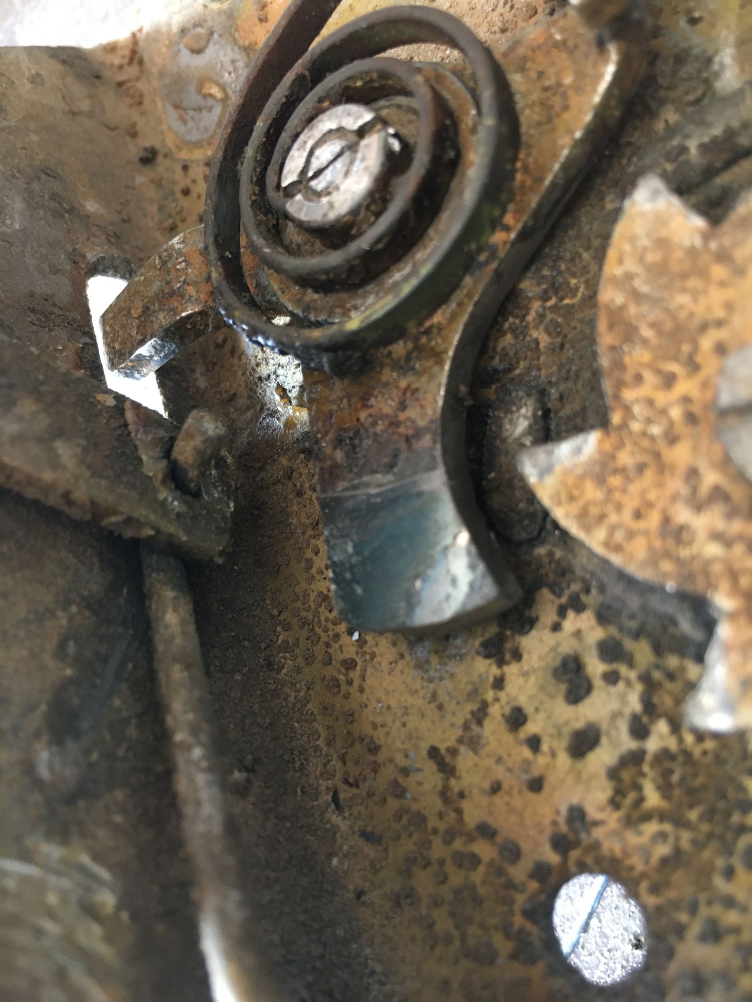

Here's what we're looking at. Sorry it took me so long to get pictures. You can see where the latch is worn. If I can get it off I'll just weld the thing and grind it back down to shape, but I'm not sure how to get that round spring off. It is the driver side latch.

Looks like the push button part of the handle is broken as well.. Not sure if I can just weld that back together. I think the button is stainless, so that may be an issue. Glad the door will be able to close now, but I don't like not being able to open it from the outside.

Guess it just took a little persuasion to get it off and then a little filler and grinding to fix it.
