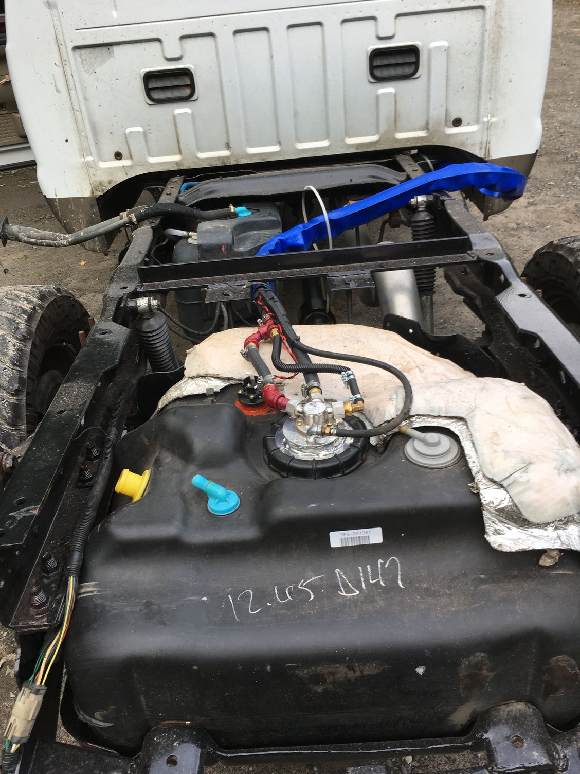

I often use a 44gal factory Excursion fuel tank under the bed of F250/350’s for VO. VO fuel lines are heated with coolant using a tube-in-hose system. Like this:

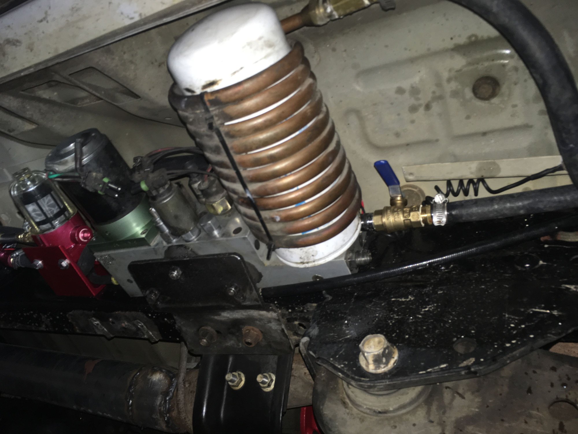

The primary filter is heated with coolant using copper tubing.

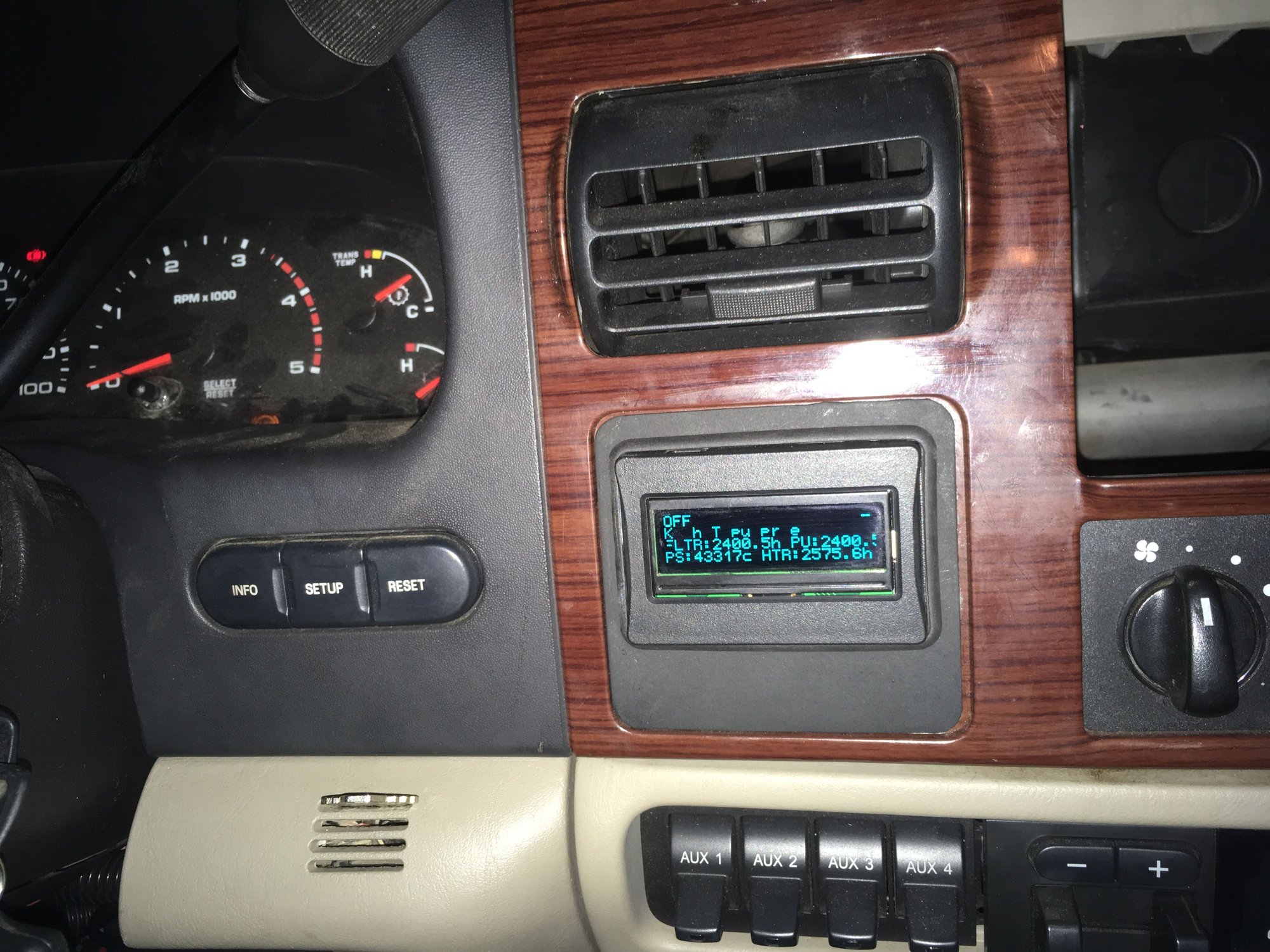

The V4 system includes an OLED to monitor system operation. It is also fully automated and switches fuels automatically when the coolant temp is high enough - then purges all of the VO out when you shut down.
