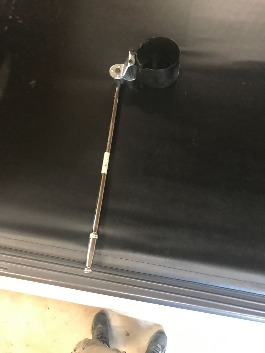

I certainly haven’t changed as many of these stubborn filters as you guys have but
here’s what I’ve used on stubborn filters with success.

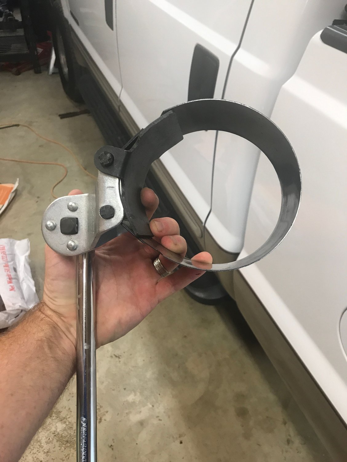

second pic is cause it is WAY more heavy duty Than looks in first one. This would turn filters I couldn’t budge with the largest filter pliers I have.
