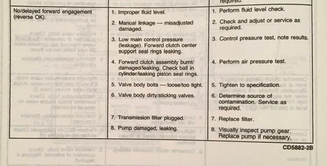

Since you have no history of the vehicle here are some things to check:

Yeah went thru all those..its just got too many years of no maintance or fluid change..So its all tore out and getting a 302 and T18 now.
