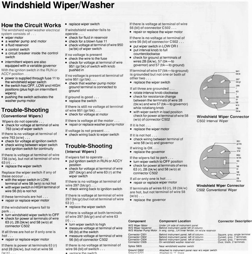

I’m working on my 74 ford highboy it sat for 20 years and it’s close to being road worthy, one last thing I need to do to it is the windshield wipers don’t work. If somebody could tell me where the motor is or signs of a bad switch that would be great. I don’t have a ton of experience considering I’m 14 but any advice would be awesome

if you look under the dash above the accelerator pedal, you will see the motor...

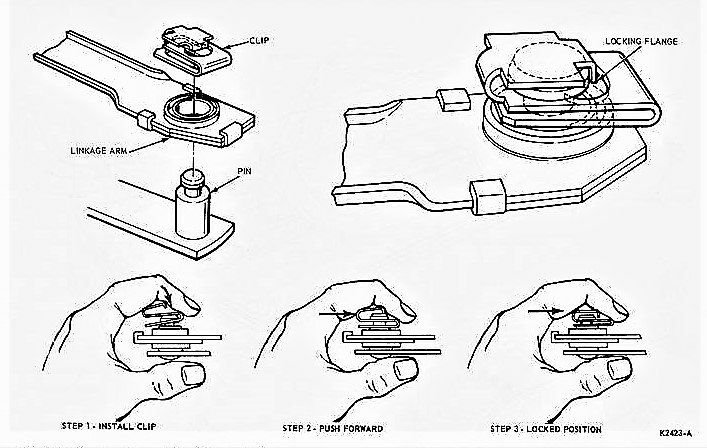

X2 what he said.
Part # 17531 instructions. The PITA clip.

X2 what he said.
ok thank you very much!

And thank you dlburch for your posted diagrams/info. Making its way to the FTE library.
https://www.ford-trucks.com/forums/1...then-some.html

I tested my switch by pulling the connector off the back and using a jumper wire. Motor was fine. Switch was toast.
