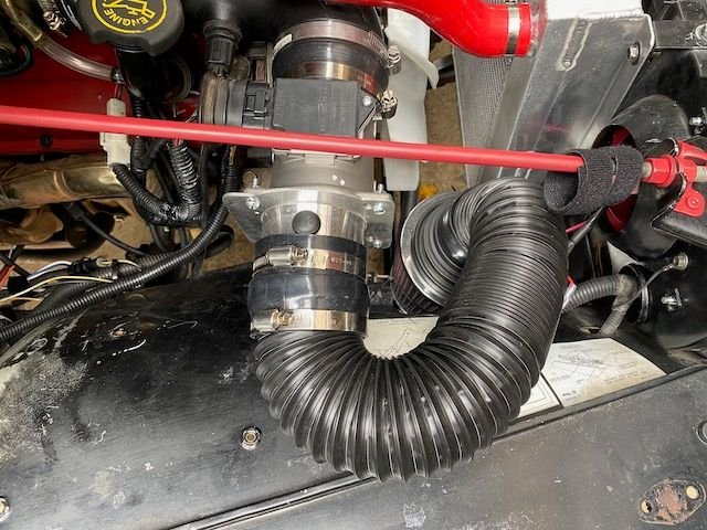

Full exhaust. Original manifolds but no CATs. The MAF is the same MAF as the original MAF. The engine came with that big housing around the MAF. I took it out of the housing and ran a cold air intake into it. Pic attached. As to whether it's the RIGHT MAF, I don't know.

That is more of a hot air intake actually... open air filter in the engine bay, and depending what you are doing with the jeep having the air intake down low like that could be a good way to get water into the motor, but that won't matter at the moment. How far away from the throttlebody is the MAF?
So you have dual exhaust with no cats just mufflers? What size pipe? The stock exhaust on an Explorer is a real cork including 4 cats and whisper quiet mufflers so the engine is going to move some more air now with a free flowing exhaust and that could translate into richer fuel trims. With no cats it's going to smell rich even if it really isn't.

Yeah, not the best place for the intake. It's my son's daily driver to school and back, no river crossings, so we'll be okay for now. The exhausts are 2.25" all the way with a DIDO Thrush muffler. Got about 20 hours run time on it so far.
If there's more air passing through surely that's the whole point of the MAF - to see that there's more air and adjust accordingly? The MAF is about 10" from he intake. Not too worried about the smell but the fuel trims show that it's seriously rich.
