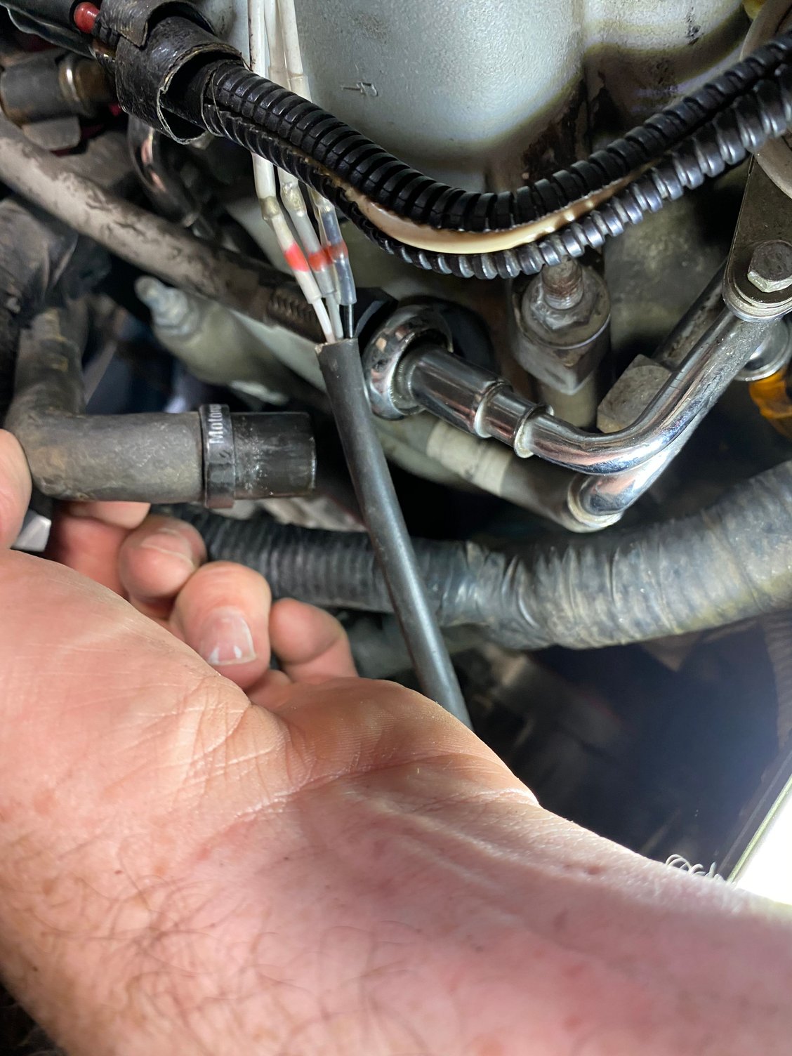

Okay, I think we’ve taken one step in the right direction. The IAC solenoid was definitely toast. So the IAC has been stuck open all this time. I replaced it and it’s gotten rid of the EGR excessive code. It’s also reduced my long term trims from around 30 to about 18. I didn’t get any lean codes while it idled for a while but they turned up while I was driving again.
It’s worth noting that while I was being a human smoke machine the only two places I saw smoke coming out of was the IAC and what I THINK is the PCV valve at the rear of the intake (photo). It seems like the valve is pretty loosely inserted in the hole.

The PVC valve sits in a rubber grommet, is the grommet there? If it is but fits really lose a new one is a good idea.

Yeah, the grommet is there but it does feel a little loose. I’ve ordered a new one and a new valve too.
