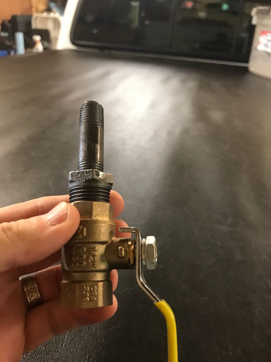

I’ve searched all over and I can’t find what size this is. Anybody have a diagram or help looking up. Best guess is 3/8 npt but I have also read 16 or 18mm but can’t be sure.

Thanks. Looking for size of plug itself as looking to replace them with valves as I may be flushing soon if I can’t figure out my coolant.

Wanna say 1/4npt...had to replace oem plugs and I had aluminum laying around from my who days. Don't remember me using 3/8 stuff

yup. Bet that is it. Probably why no one uses on 7.3s. They are the cats meow on 6.0s.

Last year in November I swapped out my coolant plugs for this type. With a little bit on anti-seize, snug them up, they're much easier to remove than the OEM one's. As mentioned before by the other fellas, they are 1/4 npt.

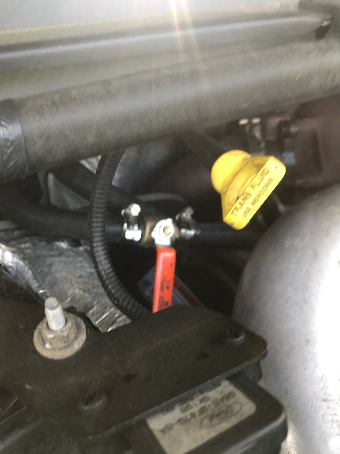

Be sure to add a 3/4 PEX barbed valve to the heater core SUPPLY (from head) if you haven’t yet.

gotcha. Have one on my heater supply already.
I also made a valve to drain the coolant intermittently. I was planning to run the tapwater first, then do a full fill of distilled, drain and then fill with 4 jugs of coolant. Then ease up to the final level with distilled.

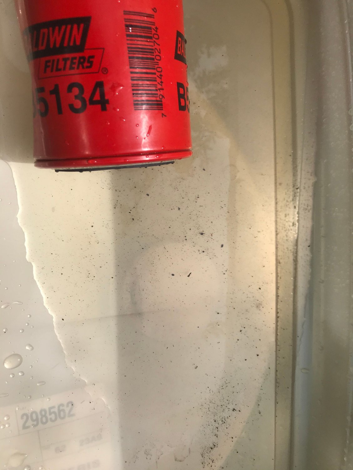

Well that was fun. need to cut up the filter because it’s got all kind of junk in it when I turned it upside down. That is after it had a thorough flush about two years ago. I was very skeptical of the coolant then and definitely was not treated properly after. Hopefully didn’t do any lasting damage. The water pressure at my house is not enough where I can open the block and the front drain at the same time so I made a valve for the block on one side. Seemed to work well. That’s why I needed to know the size.
