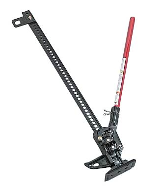

buddy bought a hi jack pro, for big tires, and used 2 stainless I-bolts to secure in corner of flat bed, jeep people, mount on hood/cowl
No offense torq'ta but I hate trying to jack up a pickup truck with one of those handyman style jacks. Those jacks lean way to the side(best I remember) before you get the truck jacked up. I prefer a regular 2 or 3 ton shop floor jack if you are capable of unloading and reloading one.

non taken, I wouldnt want my step-daughter using it, would those have enough travel (13-14") to lift a dually, my 150 axle is 11-12" with 31's on it?

Hi-Lifts certainly have enough travel to lift a tire. Problem (as mentioned) is stability, especially since it's hard to lift only one tire. Jacking on the bumper is likely to twist things unless you're close to a frame rail, and then you're more lifting the middle of the truck. You can lift both tires at that end, but then the truck REALLY want to fall sideways off the jack. Not saying a Hi-Lift can't be used safely, but it's not easy to use it safely.
