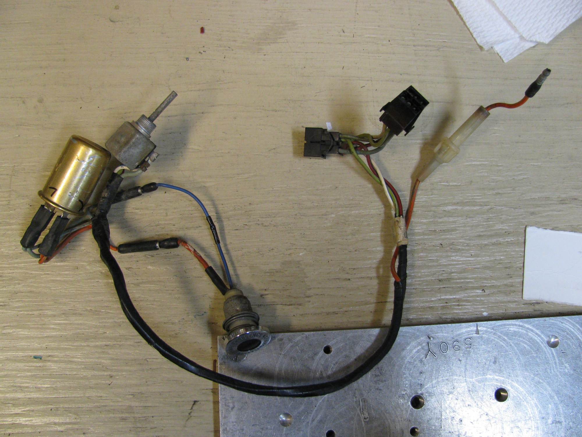

I have a 1966 f 100 that has an emergency flasher switch. I get power to the switch when brake is applied at one of the terminals. Is the power suppose to cross over to the other terminal at switch because it doesn't. I sure would like some advise on the power flow to the turn sig and emergency switch.

If his truck has the original emergency flasher. It was an add on and a stand alone system it worked independent from the rest of the lights and will work even if the turn signal switch is bad.

I was thinking that the flasher power in should be hot all the time since the flashers work with the key in the off position.

You can turn the emergency flasher switch into a temporary brake light switch by jumping the flasher wires and operating the switch by hand until you get the new turn signal switch in there.

I have an update of my brake light issues. I replaced the emergency light and turn signal switch. Although i bought the turn sig switch from Dennis carpenter I found that the wires were not the same wire colors as the wire diagram. I used the old switch to plan the correct way to wire it. Eventually I found the correct way and perm spliced all connections. Thank you to the reply's .
