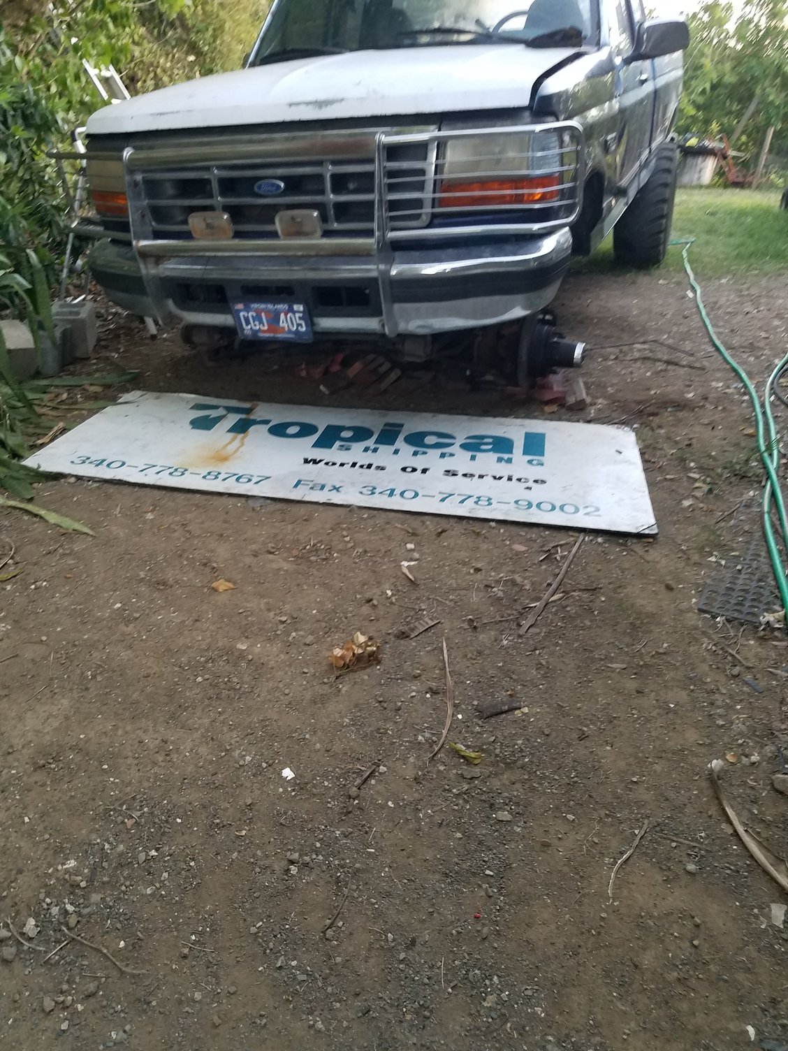

I read this post shortly before leaving work today. Get home with new shoes for Blue, whose front end has been on jack stands for two days. As I slide the first wheel over the hub, Blue's front end slowly heads south and down. I'm not sure if the stand collapsed or just fell over and was crushed by the knuckle, but it`s flat now. Took a good hour to get her back in the air and get the tires on. I'll be buying real stands tomorrow.

Thanks. I try to stay out from under anyway when they're on stands. Could have been far worse than a coupla bent backing plates.
Dry flat solid ground
Cheap stand + wood blocks= bad news
All's well that ends well
